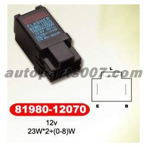

Pics of the Toyota adapter etc.....
Novita EP34 flasher works great.
Just needs tab removed and some hot glue drops to keep it stuck into the Toyota adapter.
Just reporting back with a definitive answer. :beer:
The OEM assembly is the equivalent of an EP35/EP36 flasher; comprising of an EP34 flasher with a jumper/clip to reverse its polarity and a socket/base to house all and mate with the relay block.
Therefore your options are:
1. Pull factory flasher/jumper/socket and replace with a Novita EP36 HD flasher. This is what I did and the flasher seats firmly into relay block (kept factory flasher as a spare).
2. Pull factory flasher and reuse jumper and socket with an EP34 flasher but you'll need to modify the flasher by removing its tabs first (as koffeekommando did above).
