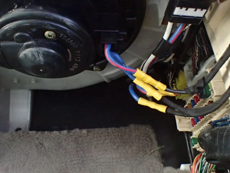

The cloth wrapped cables in this pic are the Webasto loom. (Fuses in this location are on 2003- models)

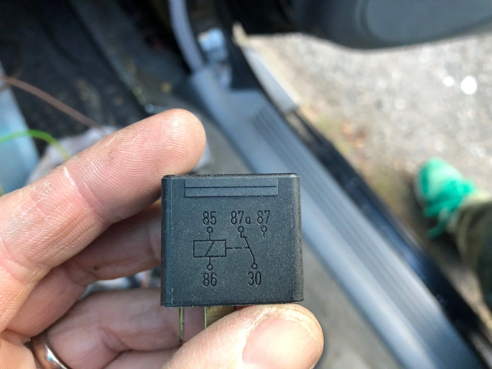

Wonder if the Bosch Relay pictured here is part of the Webasto installation? If I remove it there is zero voltage to the blower, so it plays some role. The brown leads connects with the motor connection leads (apparently smaller area cables than the OEM ones...).
Can this relay be failing in some way, causing voltage drop on load or similar?
Haven't followed the other lead to see if there is a second one, but there is a quite large ring-formed ceramic piece below this relay, think it might be the resistor (not pictured).
Could the Webasto parts be failing me?
I never use the Webasto anyway since the Minicall pager is failing to engage 50% of the times, so I would sacrifice it if I could gain a worikng fan.
I think you are onto something. That's the kind of relay used for the Webasto, and the circular ceramic is a 0.9 ohm resistor (gives 1 O together with the cable loss). The blower motor would be connected to the 30-terminal, and the 87a (NC) to the original loom/supply, and the 87 (NO) to the chassis through the resistor, if this relay is on the negative side. Those relays can fail, so an easy test is to try another one. Just don't use a Biltema brand, as those have a different pin config. (Seeing you are in the nordics)

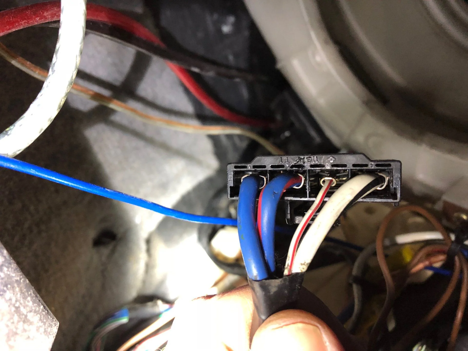

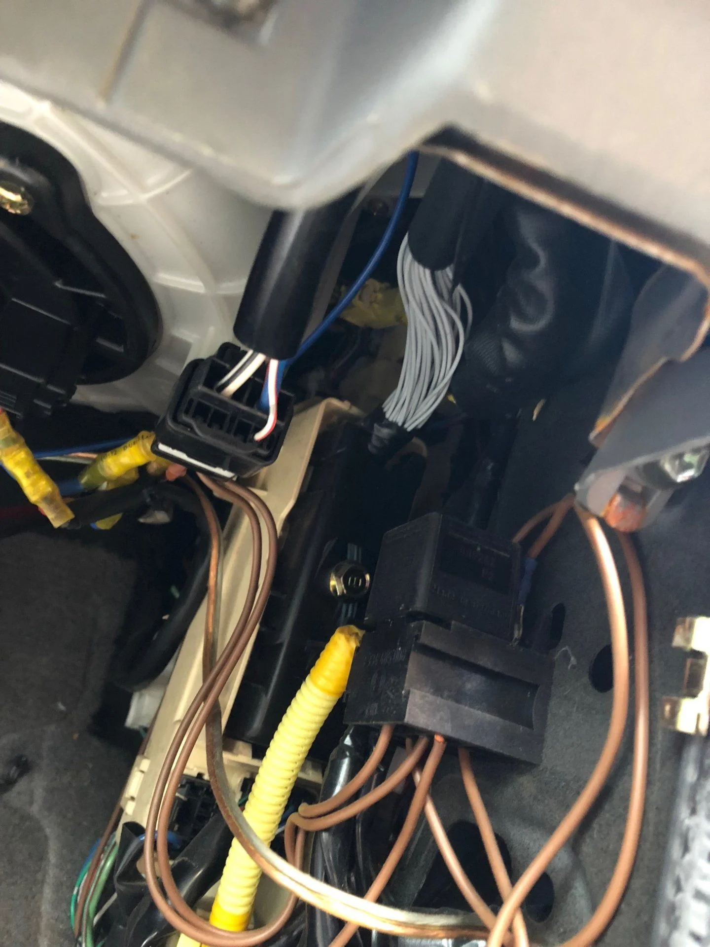

Thin controller in a bad location
Four leads to controller, not five

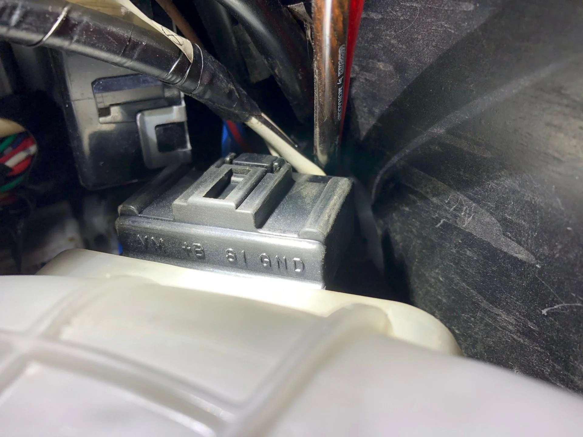

Below is a picture of the markings on the controllers connector slot. I rotated it 180 degrees for your reading convenience.
Only four markings: VM, +B, SI, GND.
So, has M+ and M- been combined into one VM ?
Strange.
