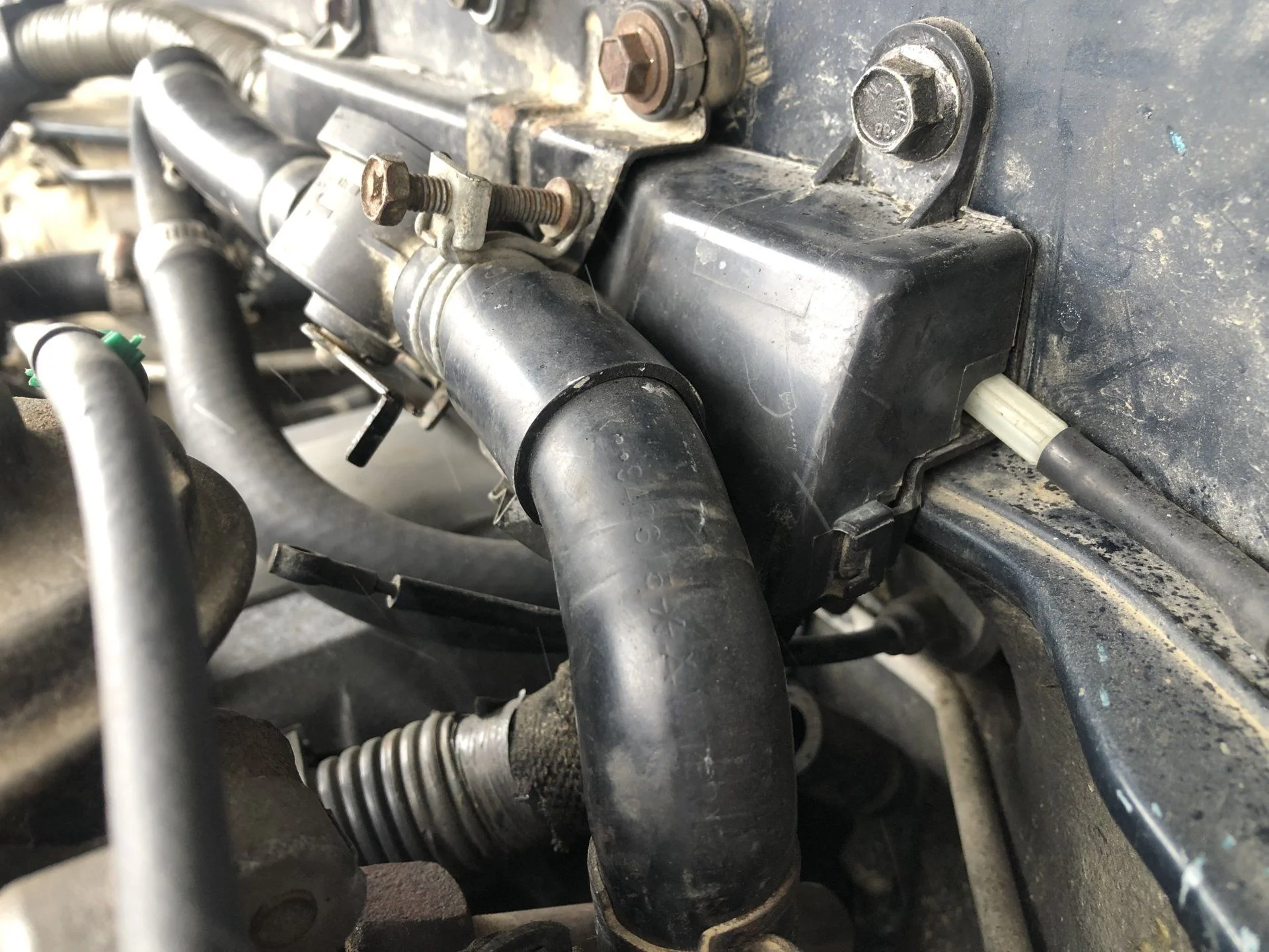

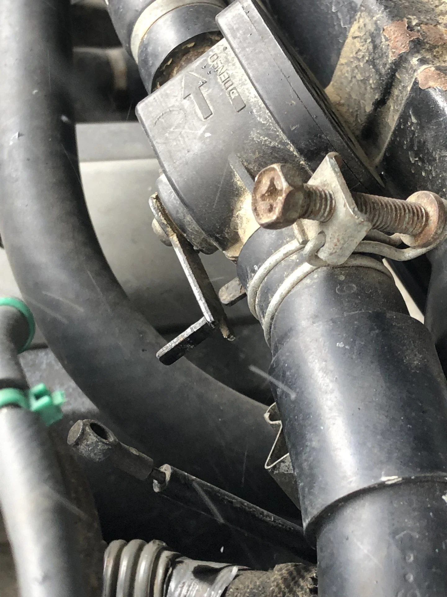

I have a 1994 land cruiser and the cable that connects to the heater control valve seized up and, until I figured out the problem, I wasn’t getting heat in my car. I moved the valve myself so that I could get heat. If the valve isn’t leaking any coolant, can I continue to drive? The only thing that seems to be wrong is that I cannot control the cold/hot airflow from within the car.

Unhooked both ends of what? The valve? I’m just able to see that the cable is seized and no longer connected to the valve. I’ve attached some images that might help.

Mine was seized once upon a time. I freed it by getting access to both ends after spraying in anti-seize and working the cable with pliers. Years later and it's still working fine.

Personally, I would probably open the valve when winter hit, and close it back when summer hit.
There is absolutely zero negative effect on anything to keep you from driving the truck.
