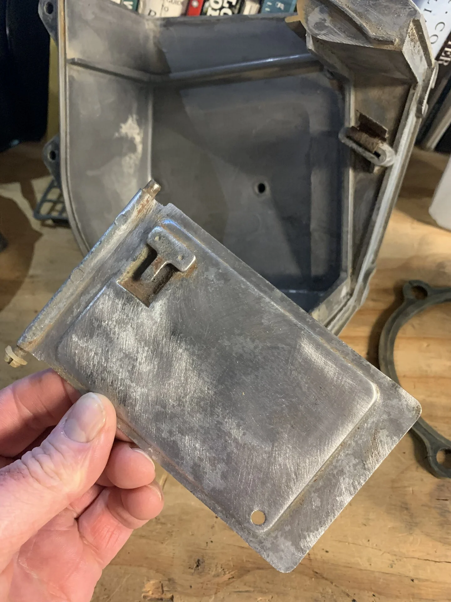

In the process of renewing my heater / blower and can’t figure out what the foam on the gates or doors are for. It doesn’t filter air. Is it for insulating the heater /blower doors? Why? I do understand the seals against fire wall and body fresh air inlet.
Secondly, what is the best thickness of door foam and seals if I was to source locally? Mine were totally wasted, so don’t know what what was there to begin with and the kits SOR sells doesn’t say.
Secondly, what is the best thickness of door foam and seals if I was to source locally? Mine were totally wasted, so don’t know what what was there to begin with and the kits SOR sells doesn’t say.View attachment 3221351
Is that the flap for the defroster? Or for the in cab circulation?

That should be the gate to recirculate your inside air, the foam is used as a sealing surface. I can't tell you what the thickness is. On a side note, you'll have to keep that set to only pull outside air in the winter, else you'll ice up all your windows due to all the condensate you'll produce...

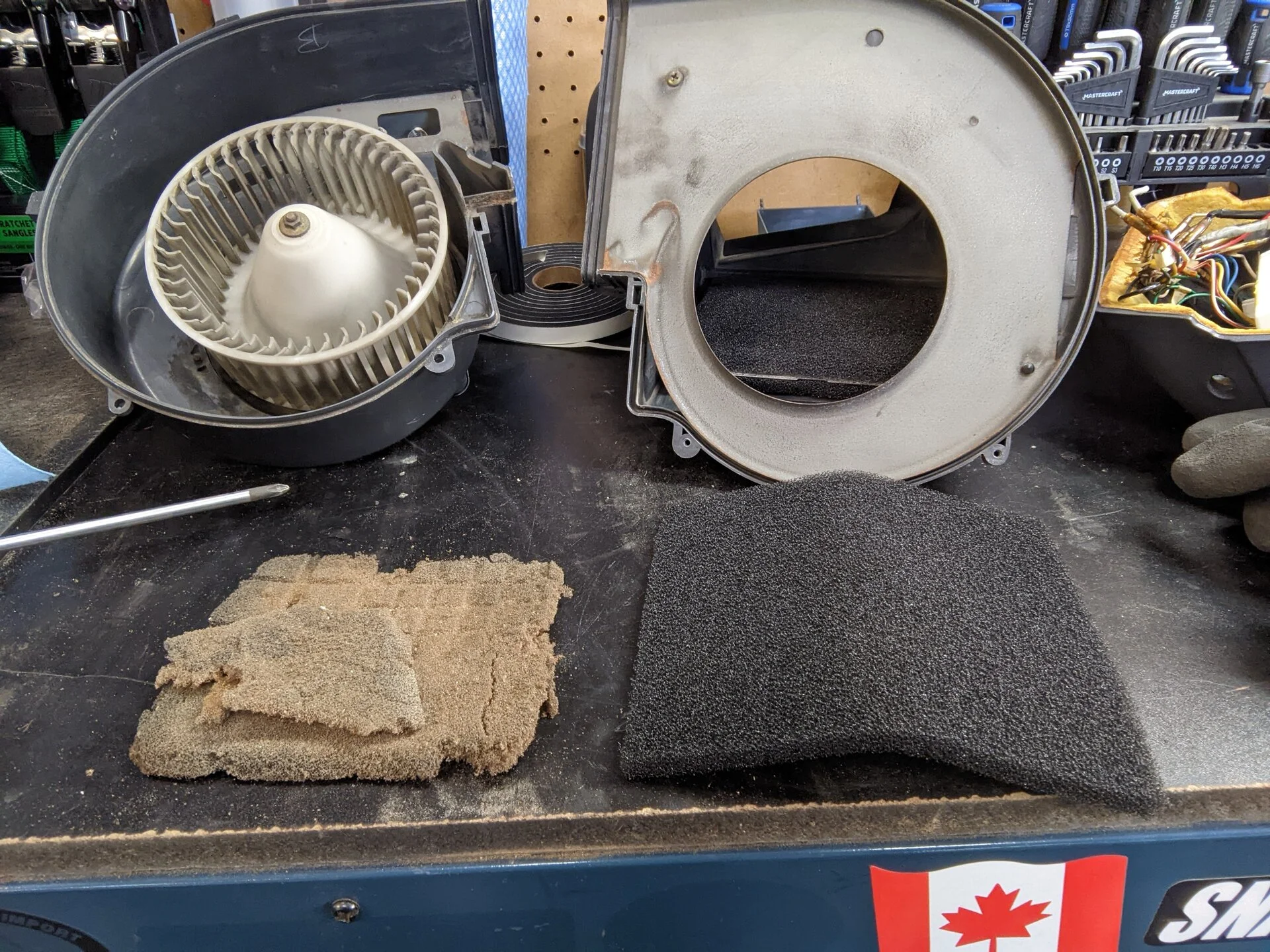

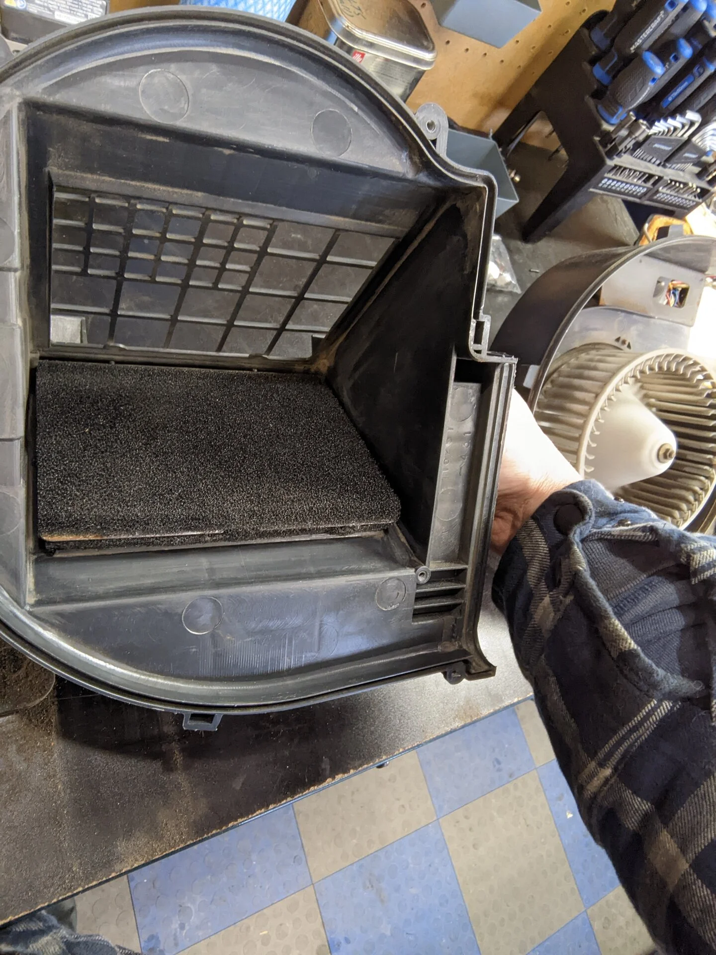

I recently redid the flap on my 70 series HVAC recirc. I ended up using some foam from Home Depot, made for a home a/c filter. I'd imagine yours is similar thickness? It seemed a little thick at first but because it was slightly more open cell than my OEM, it compressed down just as good when I reinstalled and closed the flap.
