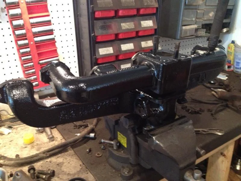

As i am sure you know, gasket goes between the manifolds.... it cleaned up nice....

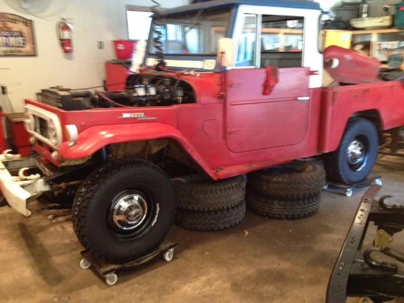

Pic of truck, awaiting gasket.... help if you can...

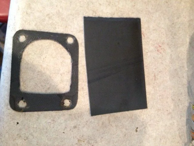

Crisis averted. Here is a pick of Me Gasket material blank and Mr Gasket after LAME fab cut it for me. Its solid stuff and im confident it will hold. $7.00 for each blank. Inexpensive solution to the unobtainium gasket issue.
