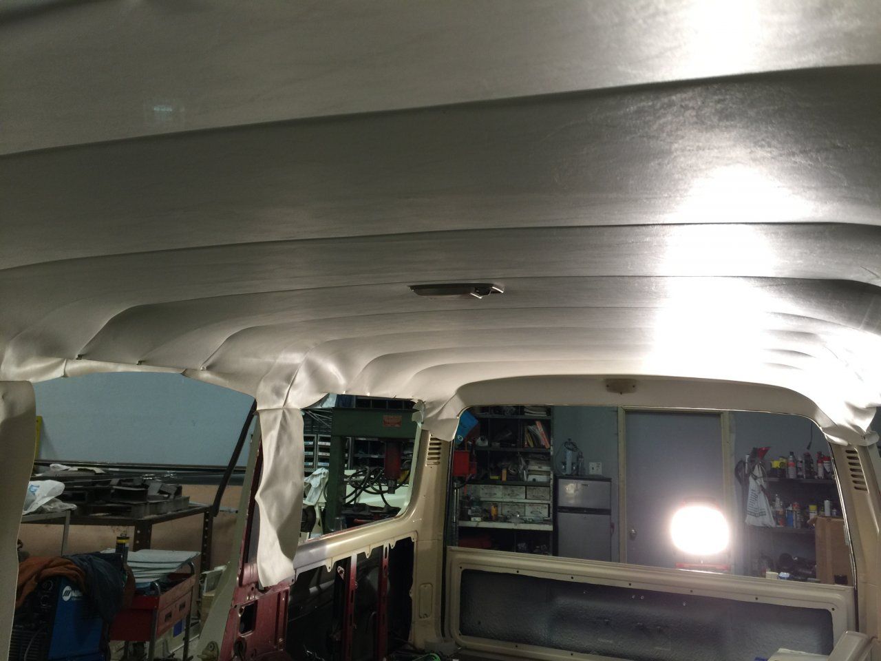

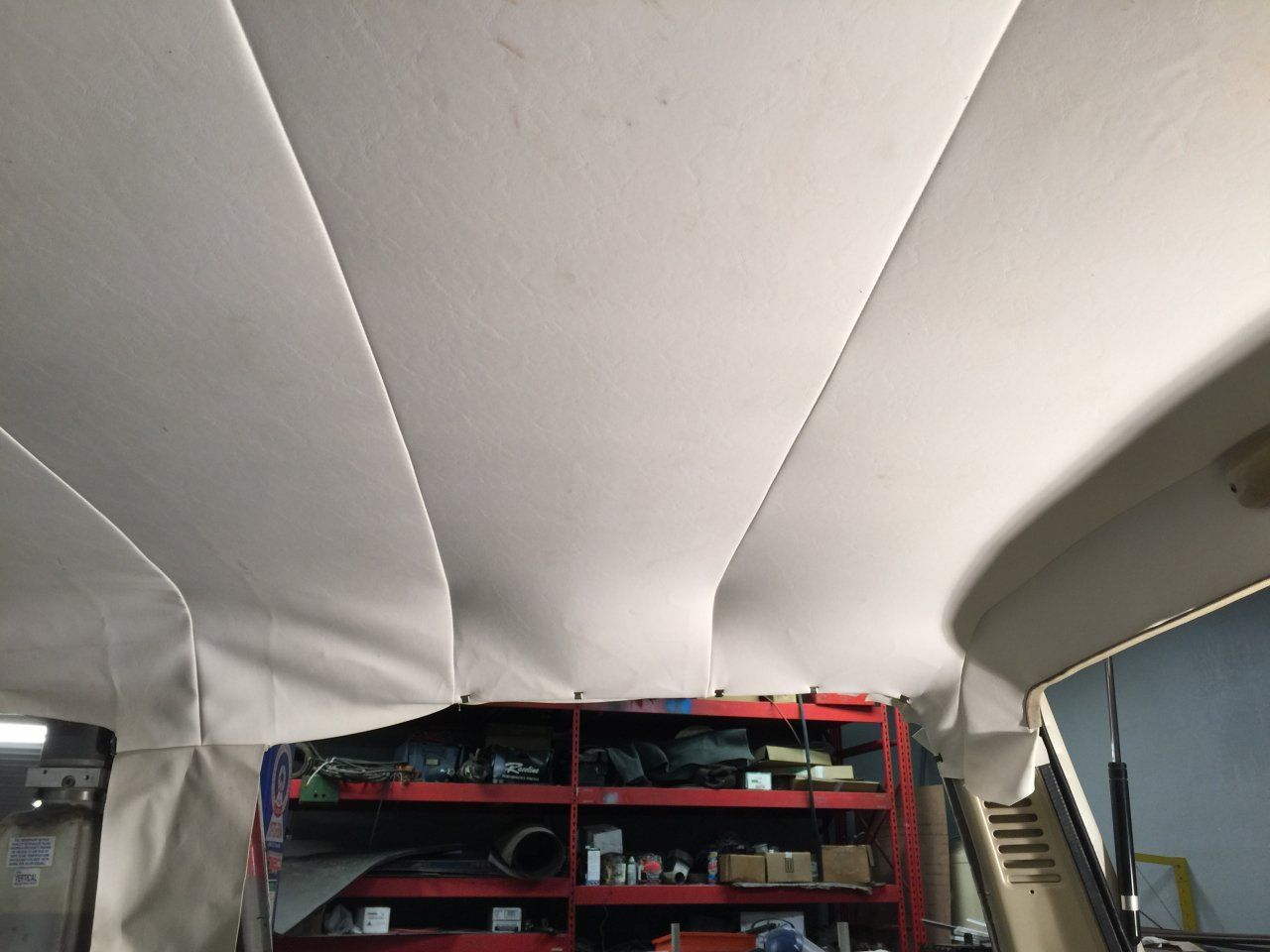

I used carpet padding to insulate the roof. 3/8 IIRC. The adhesive for the padding was an industrial grade that wont release in the heat.
Here were my install pics.
Looks good Cruiser Jimmy. Thanks for posting up the pics.
Local shop did the work after I took the original to them. It's white in color and the idea is to reflect more light inside the cab. With the LED ceiling light I achieved what I was wanting.
View attachment 1183548 View attachment 1183549 View attachment 1183550
