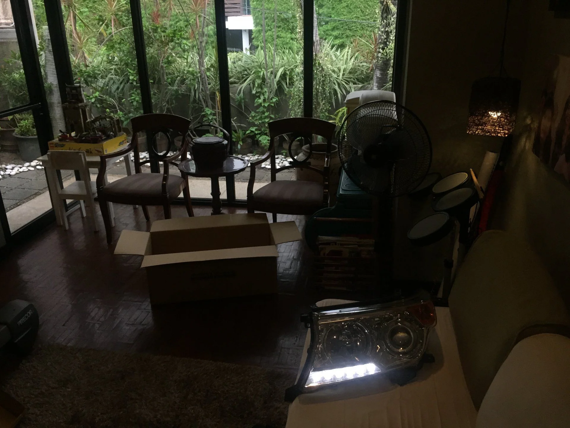

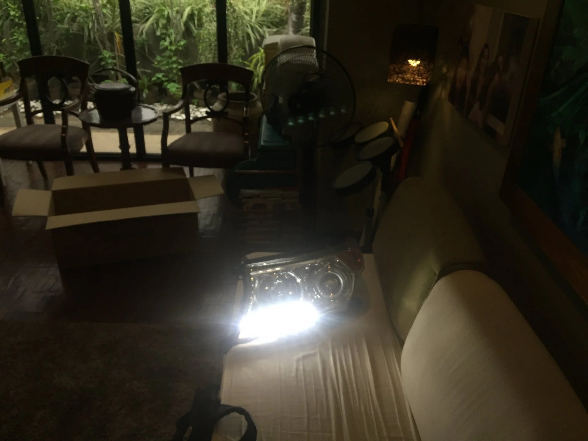

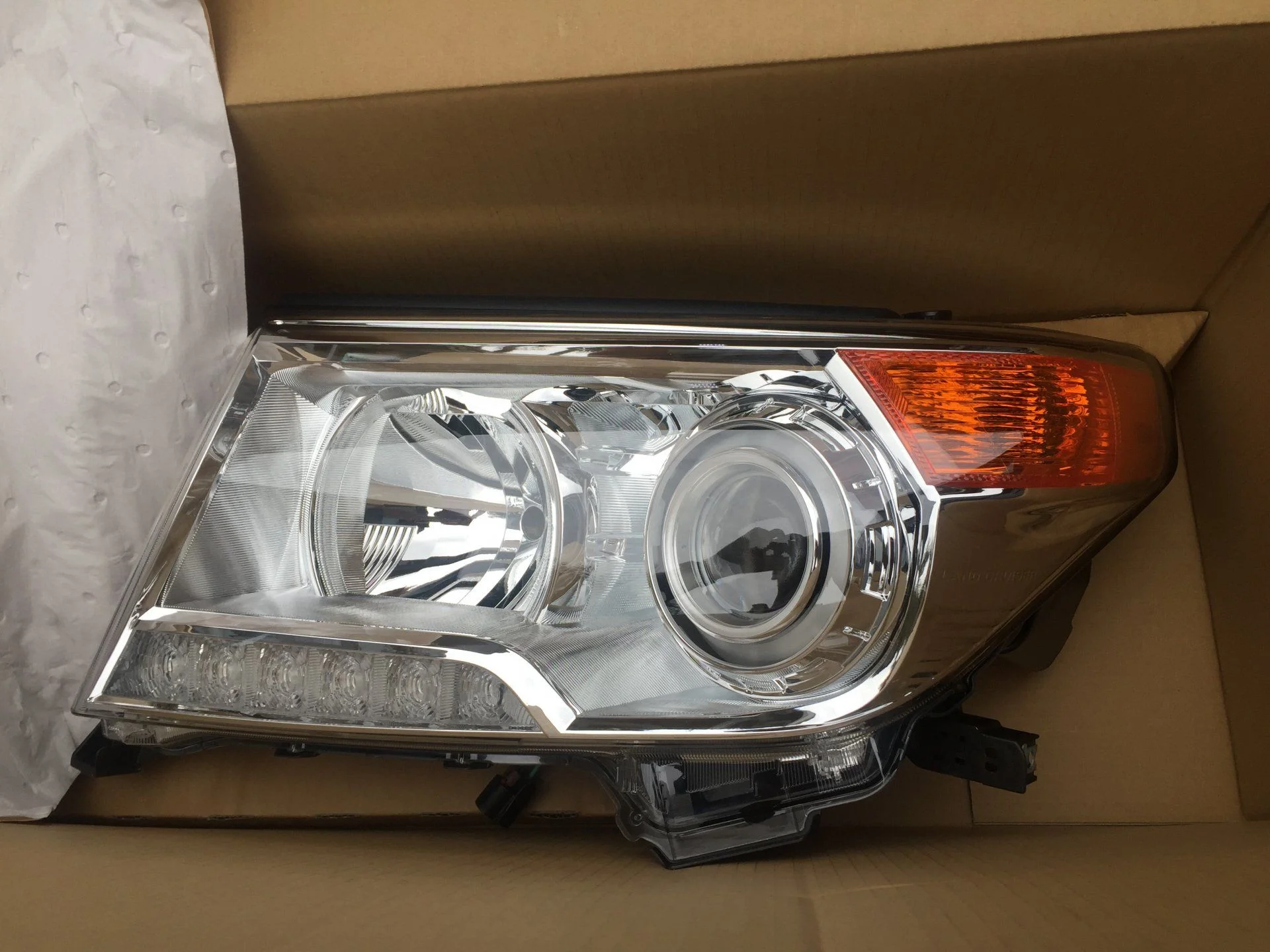

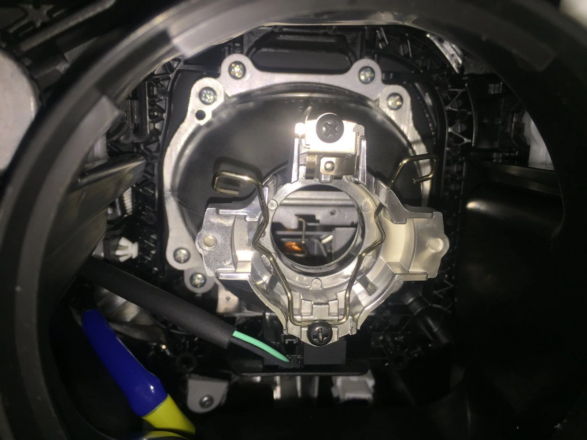

I finally pulled the trigger and got a set of OEM 2013 headlights. I can confirm that the non-US spec headlights are indeed Bixenon and all it takes to light up the LED strip in DRL high brightness mode is to connect +12v to the red wire. This red wire is absent in the US spec headlights I saw on ebay so I don't think it's possible to get the LED strip in the US lights to run as DRL. I'm going to have to use a couple of relays to switch +12v between the red and yellow wires of the LED strip. It might get fried if 12v is applied to the yellow and red wires simultaneously.
If you guys in the US want to upgrade to the 2013 lights then it makes more sense to get the overseas version since you get Bixenon and LED DRL for about the same price as the nerfed US spec lights :D
LED strip in DRL mode
LED strip in park light mode
Some photos of the Bixenon shutter in low beam and high beam positions

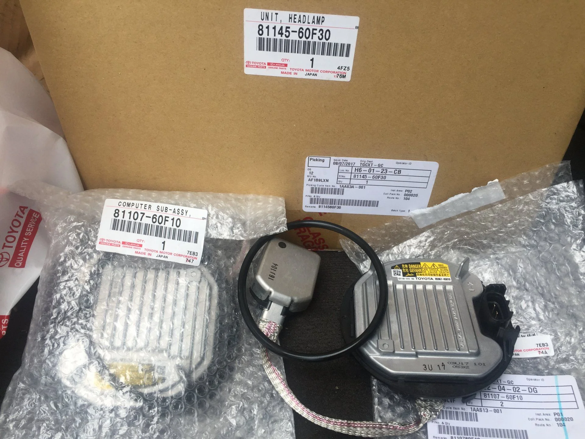

are the transformers/ignitors/controllers for the HIB bulbs part of the headlight case? or how does that work?
sorry, curious now.
sorry, curious now.
The ballast is a separate, replaceable unit

could u possibly throw us the part #s by any chance? having a hard time finding them.

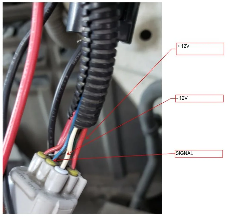

I am retrofitting 2013 headlamps on a 2010 VDJ-200.
The lamps are the non US (ROW) bi xenons with the DRL (hi/lo) LED strips. Left 81185-60F30 Right 81145-60F30
Got everything to work and figured out how to power the DRL´s with a relay setup.
What I cannot get to work is the headlight adjuster. On the vehicle side plug there is 12+, 12-, and a signal that varies form ~0 V to ~7 V, depending on the headlight dial position.
I tried to match the old headlight wire colors and it does not work. Here is what I have:

Any ideas as to which wire goes where?
