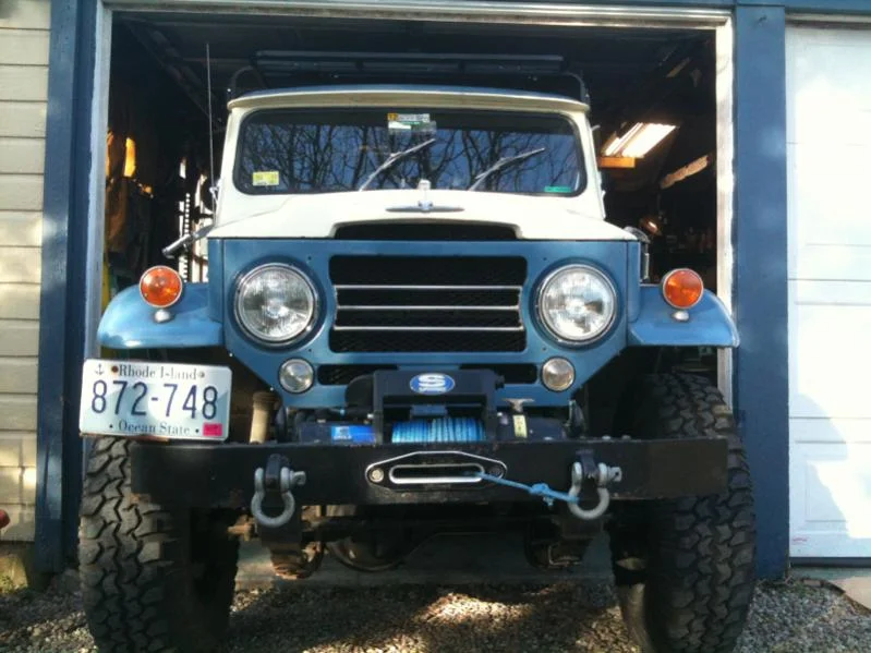

fogblanket just did this to his fj45LV. headlight rings were off a jeep and he used round rod to do the cross bars.
attachment.php
next he's going to swap in a centered rear diff and a single speed transfer case...
