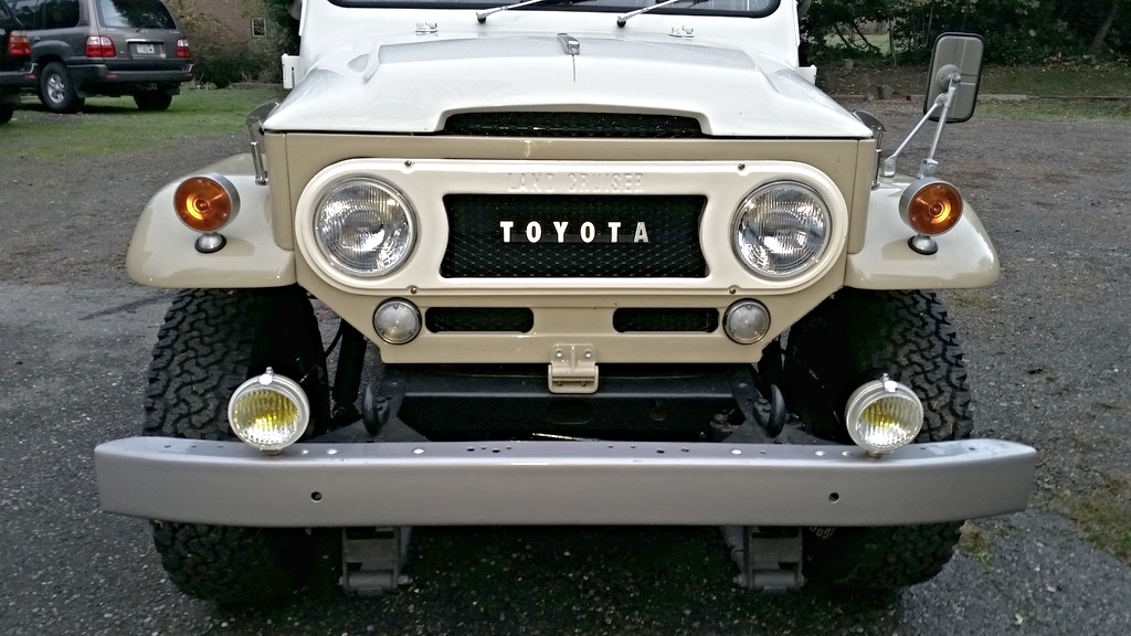

7" round headlights are what 40's(45, 55 and 60's) have......so knock yourself out......as they will all fit. I like Cibie, IPF, Hella E codes.....
the trim ring is bit smaller diameter(because they have to hold the lights in) but the headlights are 7"
those KC's.......meh! they say E code and DOT..which is not possible really.
Amazon.com: Cibie 82440 Light Unit: Automotive
unless you upgrade the wiring harness you want to get the 55-60 watt bulbs.
IPF 7" on my 45LV....standard wattage bulbs because I didn't want to cut the back on the headlight buckets to run the new harness.
Cibie E codes, think i run 55/85 watt in those, but with an ARB/IPF harness.....
