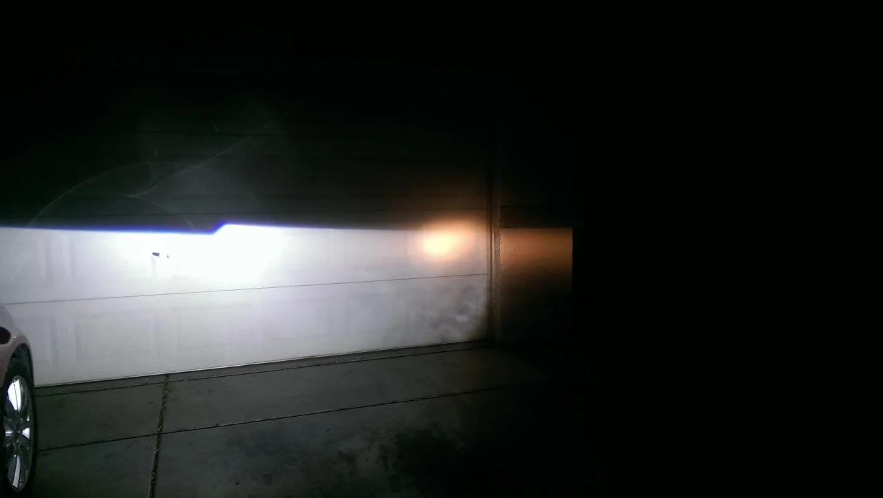

I went with the Dapper lighting Classic 7" HID projectors.
Holy cow there is no comparison to the stock lights.
imag0852-jpg.1063156
Mace, just an observation: your lights appear to be RHD.
LHD lights send some extra light up & off to the right to illuminate roadsigns, while keeping light down to the left to avoid blinding oncoming traffic.
Yeah, there is something I need to address about that. So far, I have not gotten any grumpy people.
Mace, There's a nut on the back of the projector that can get loose. Might still be enough resistance to twist the projector to straighten that cut out with it staying. It's a problem we've solved on the new batch. You have the LHD version, the projector just needs to be rotated a hair.
Sweet, THANKS!!!
Every time I see Mace's pic I get light envy!
That cut off is impressive!
