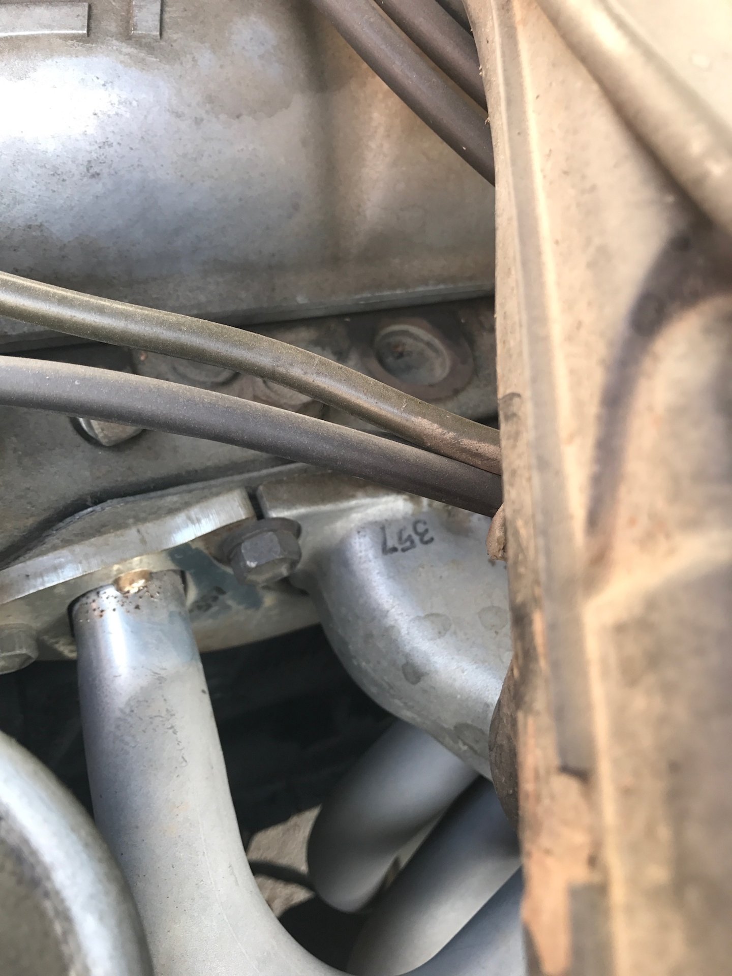

I recently gave up on the stock exhaust manifold due to the endless leaks at the joints and put in a JT Enterprises header. The first one they sent me was off a bit and impacted the intake manifold. They replaced (promptly) it and the second one was tight but did not touch the intake manifold.
To deal with the different thicknesses, I rounded up a bunch of stainless steel washers, of slightly different thicknesses, cut them in half and test fit for each bolting location. This has solved all of my exhaust leak issues.
Before installation I coated the headers with high temp exhaust paint. Initially smells bad but that goes away. We'll see how long they hold up but I'm happy with the results so far.
