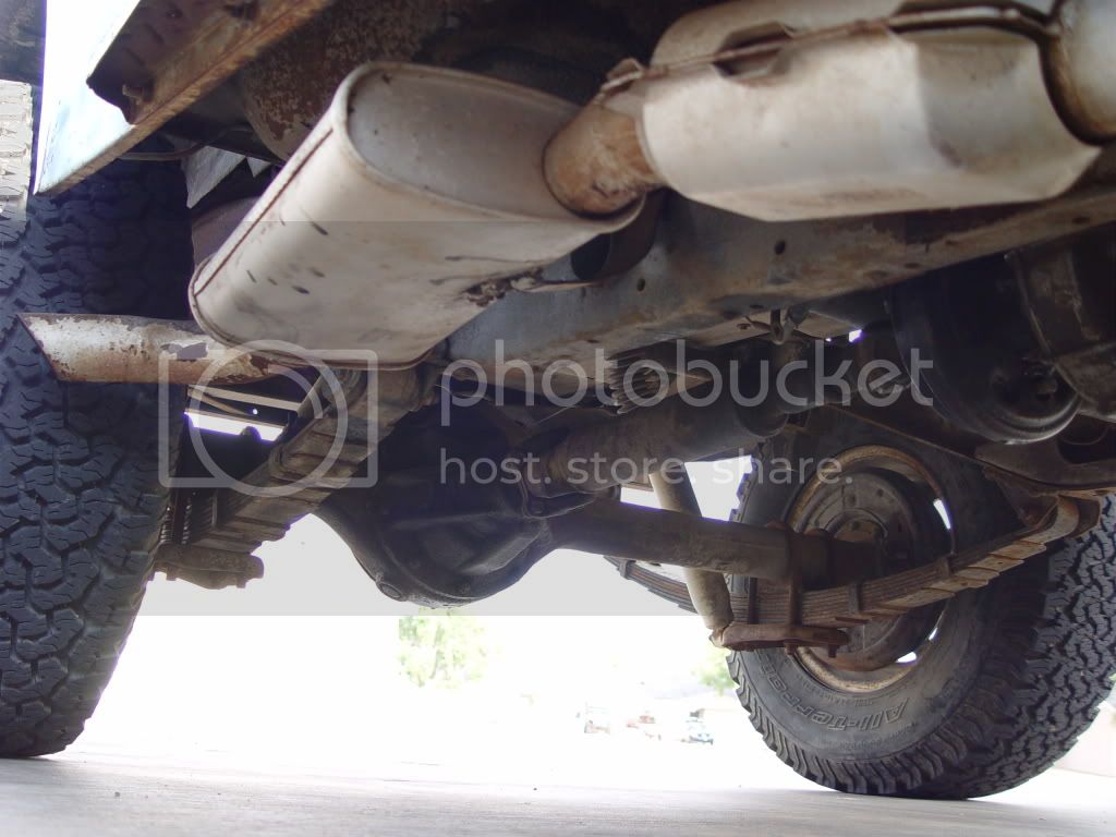

Ramhorns or else you'll end up with something like this...
Sounds nice but heats the floorboards like nobodies business and I swear jumps out to hit everything you drive past

After my tank started leaking in the driveway I want to go inside the frame rails, had I been out wheeling fuel dripping on a muffler probably wouldn't have ended well. Also they are very susceptible to rock damage when i do heroic things.
