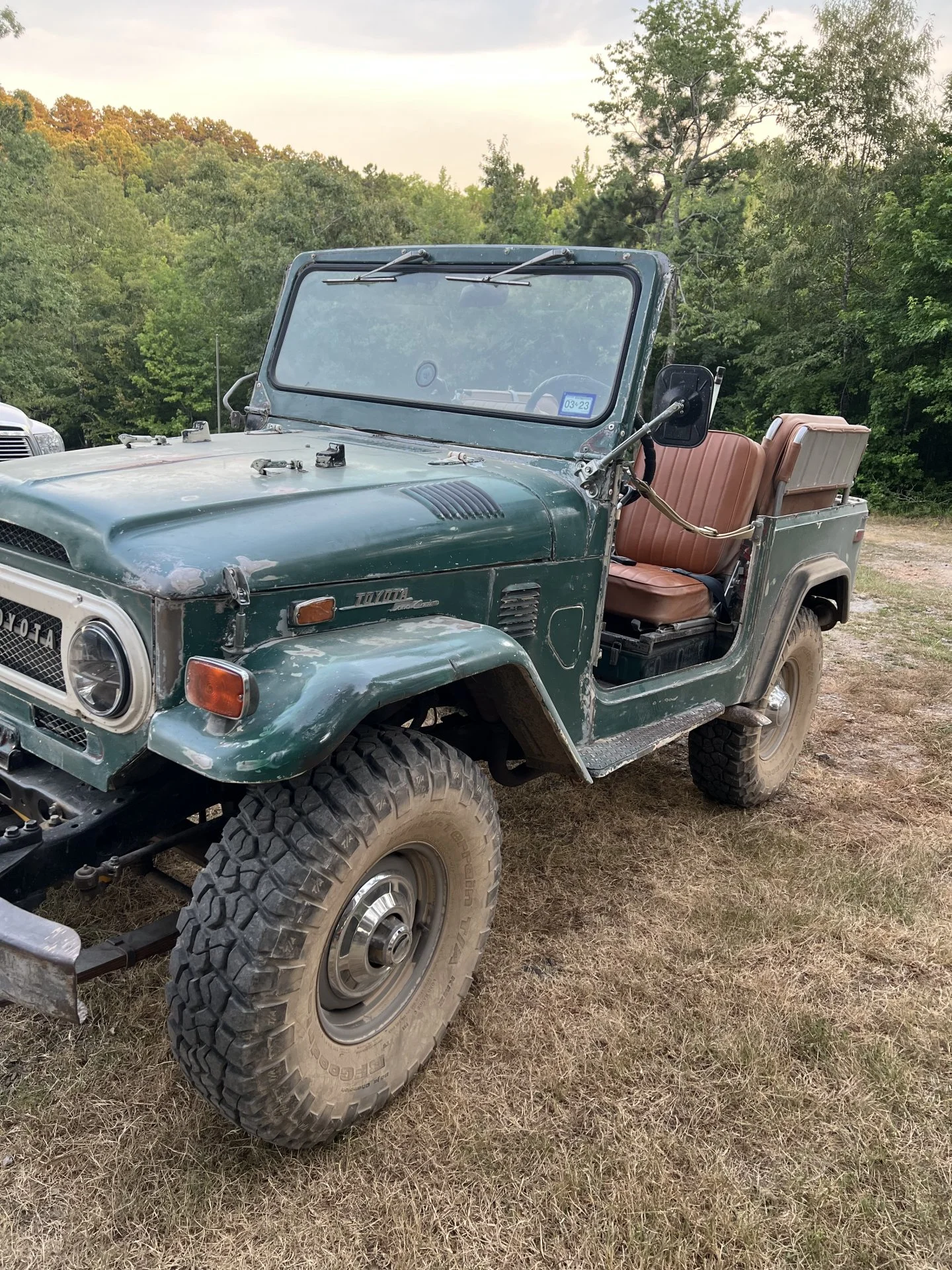

A good tune-up with careful valve adjustment will usually get you an hp. What year 2F might matter. We need pics.
Sometimes a V8 is great and I wish I had one, most of the time I'm glad I kept the six. Sorta depends on what you want to do with it.

I have the original 4:11 gears in the differentials and the transfer case has 3:1 low range. Should be fine.
