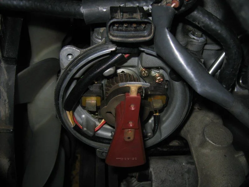

For me, the picture below was wrong. Forget that grooved line on the distributor gear. That doesn't mean nothing.
attachment.php
And then this fixed it(pointing at 11:00 O'clock). When you put it in, it has to be like this.
attachment.php

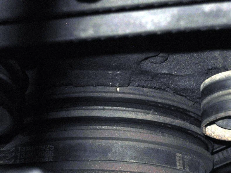

And after all that, always make sure the pulley is at TDC like the following:
attachment.php
Try this, see what happens. If this doesn't fix your problem then you need to start digging into fuel related stuff and wirings and etc.

Wasn't the dizzy. I took the cap off today to check alignment of the rotor and repositioned it so that it pointed to approximately 11 o'clock (while in TDC). Still didn't work. Swapped in a new VAM and it fired right up.
