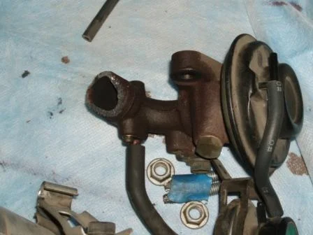

Here is a pic of my problem. As you can see, the threaded nipple which comes off the base of the EGR valve cracked, leaving part still threaded in the union.
Am I really the first person this has ever happened to? How can I get this thing out?

That piece of the EGR doesn't matter right now. That pipe is connected to the head, and you can remove it after the head is out. If you can't get the piece out after the head is out, give it to a machine shop. They'll make short work of it.
I would just move on as well, the union will be attached to the head, take the head off, take the pipe of, and either take it to a shop, as sugested, or get a new pipe and EGR valve....
I did not touch my valve, for this very reason, it was not comming apart with out a fight, once on the bench I freed it up.
i will mention it again, watch the Knock sensor... very exspensive, very breakable.
good luck again.
scott.
That isn't a problem really. You will need a new EGR valve for sure, the union/down pipe is probably still workable.

Take the blade of a hacksaw (just the blade) and in a gloved hand saw through the nipple part in two or three places. Then take a punch and knock the pieces out hitting them inward toward the center. When sawing try to be as careful as possible when cutting so as not to cut too deep into the threads you are trying to preserve. If the hacksaw blade is too wide to fit into the hole I have ground them down a little at a time to not overheat them to size them to fit. A lot of work but might help you out.

Relating back to the OP's predicament, again, it would seem wise to just keep trucking with the tear down and just get a new pipe and EGR valve and put things back together.
I don't think you want to waste too much time here.
