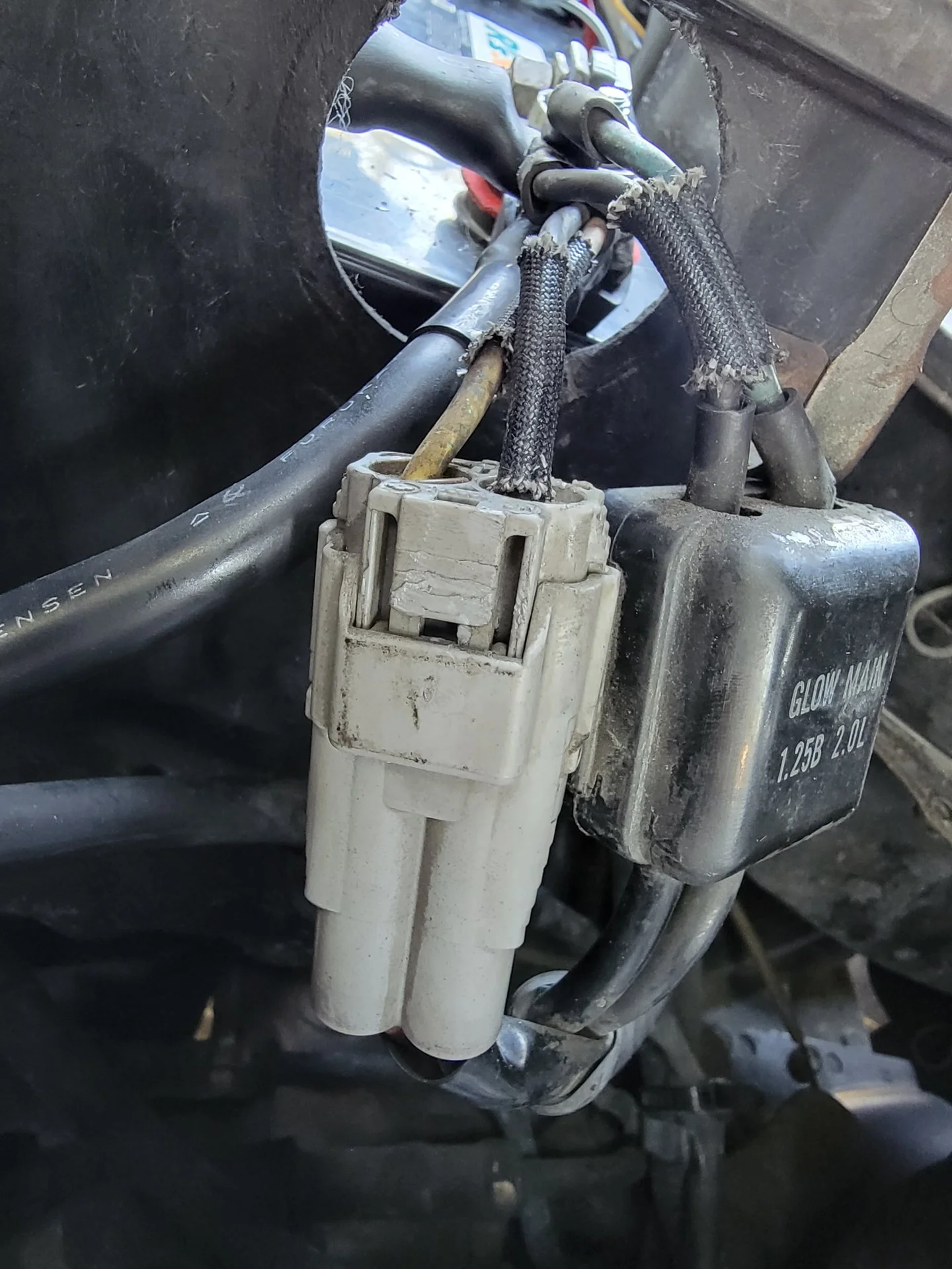

I am 99% I need one too. I'll probably have to fab a replacement out of fusible wires as I don't have time to wait. But here's an image.

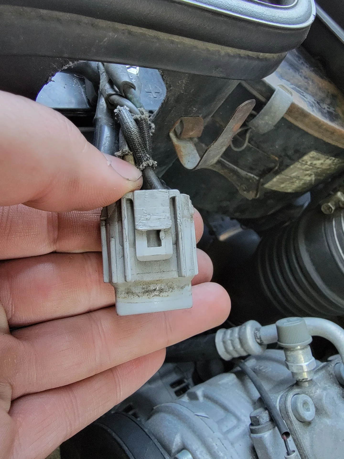

My issue turned out not to be a fusible link but upon inspection of it I can see the installation starting to crack and fray and I will need replaced. So put me on your list Matt once you get some of these made I want one

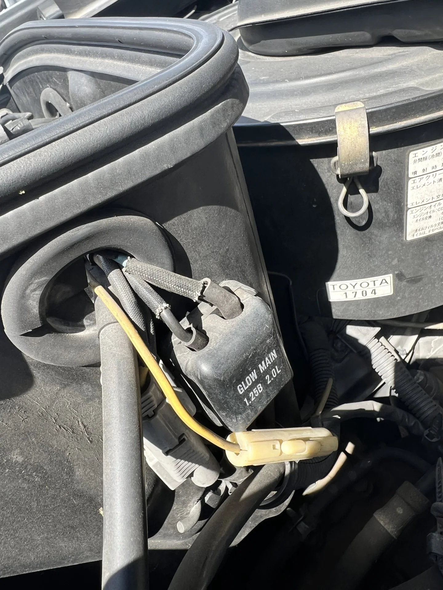

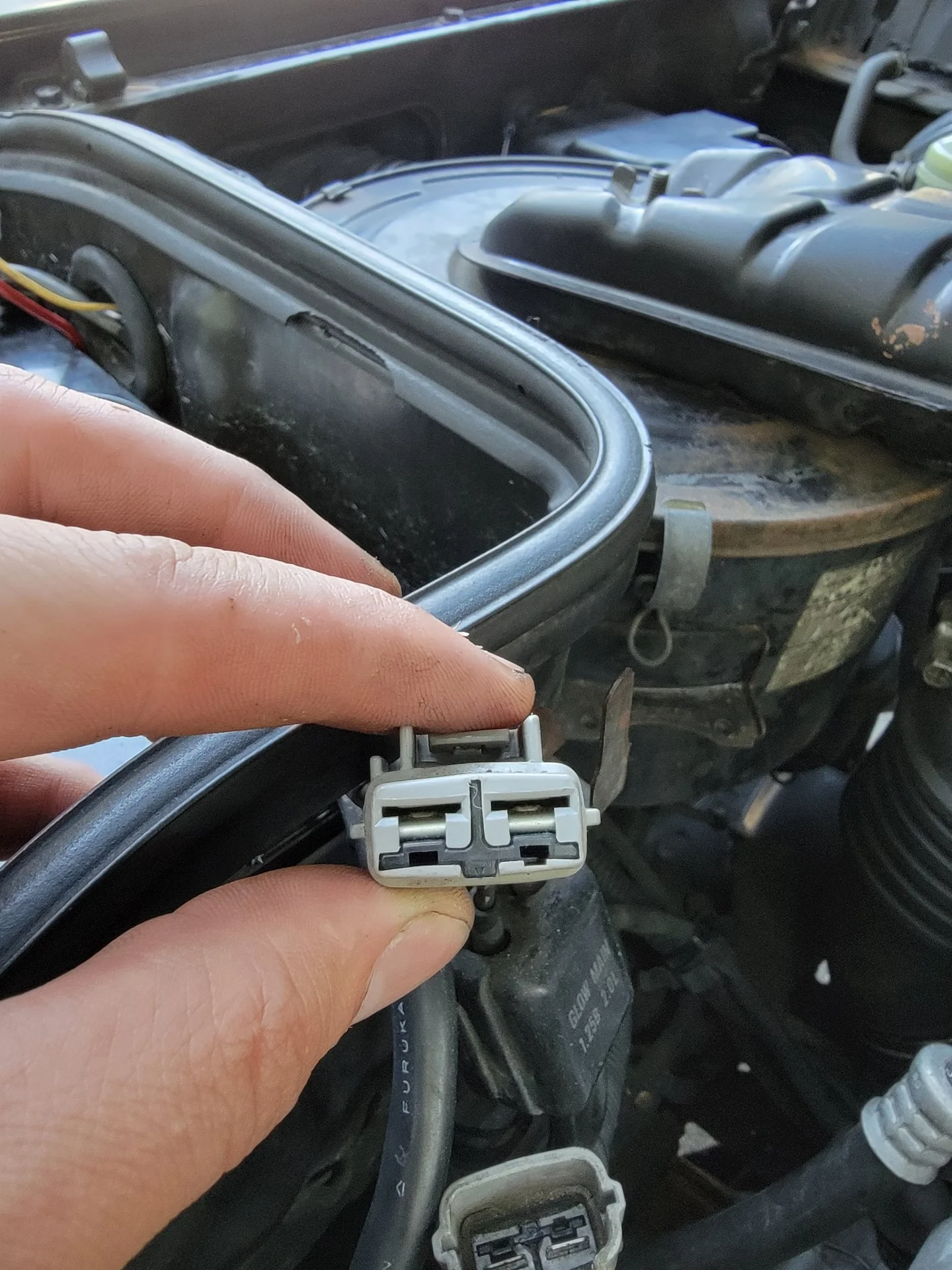

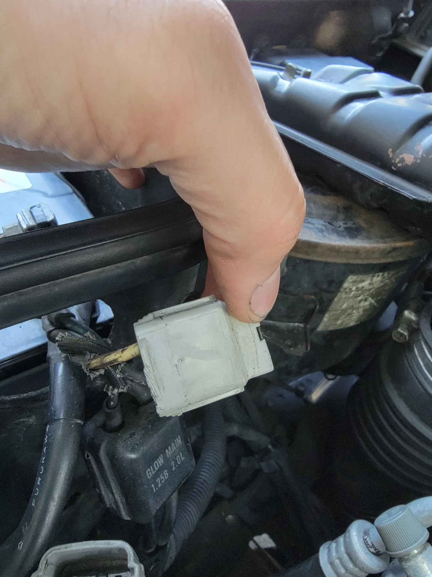

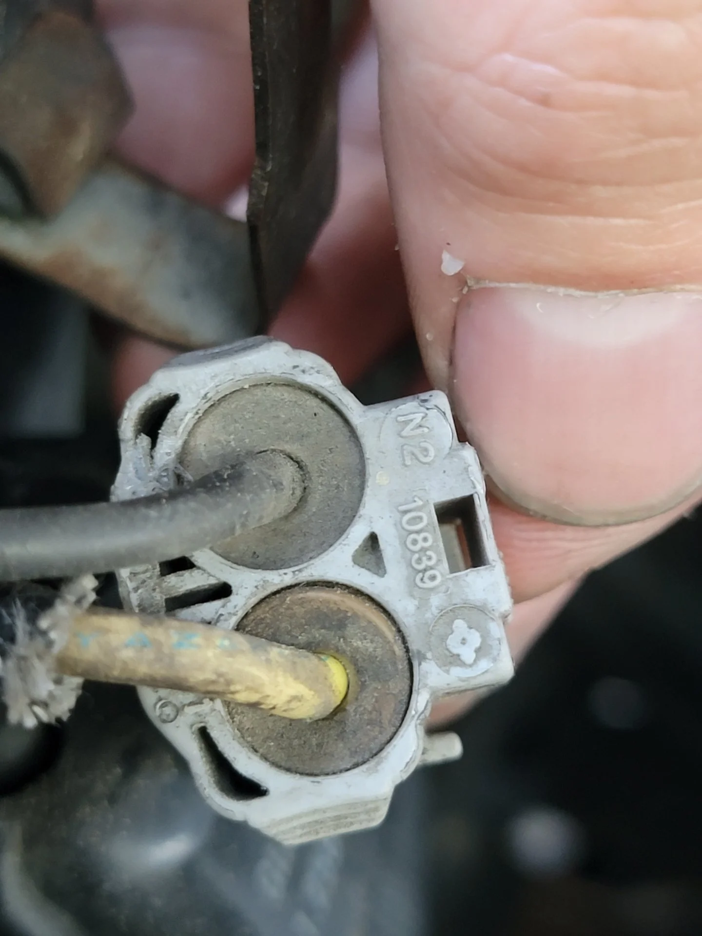

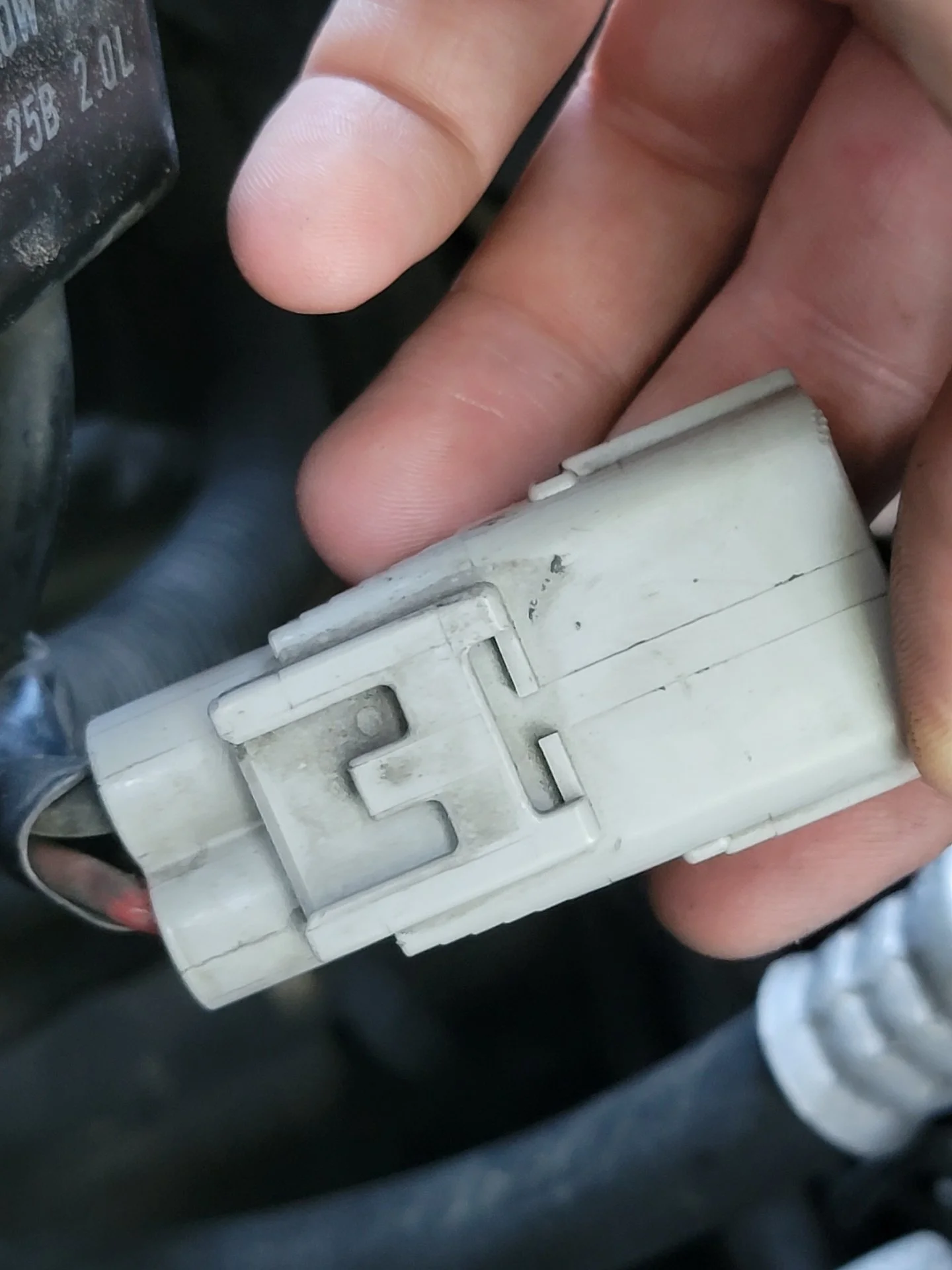

This is what I have on my 81. Looks similar so it should work. Haven’t verified part numbers yet.

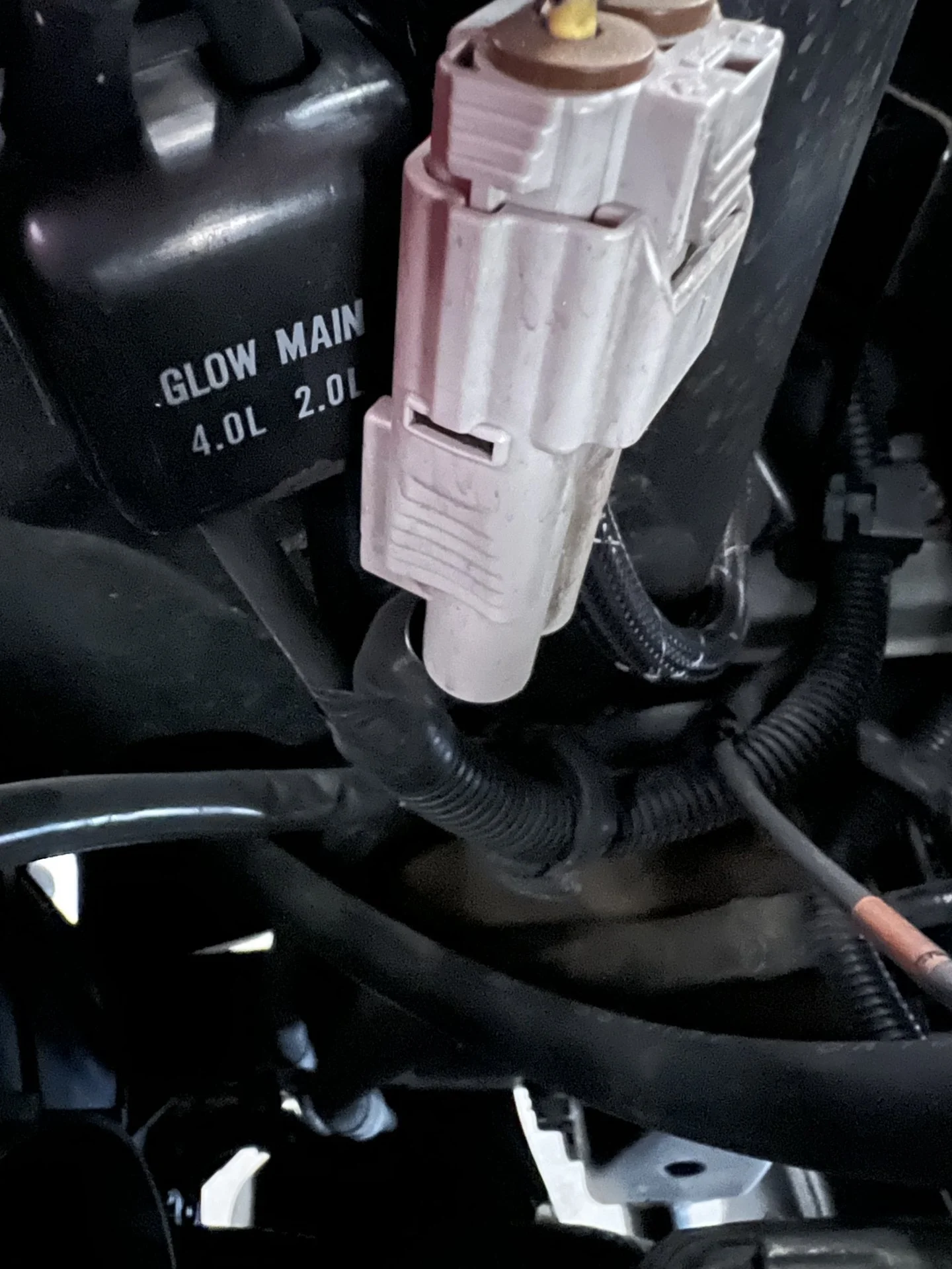

That is indeed different than my 81. 1HDT. The wire sizing is different as noted by the numbers.
The black one is a separate fusible link. I can see the grey one behind it. The yellow looks aftermarket
Correct. I thought the grey plug was on the same harness like the FZJ but I hadn’t explored that far.
It is not. The fzj has 3 wires. Ours has 2.

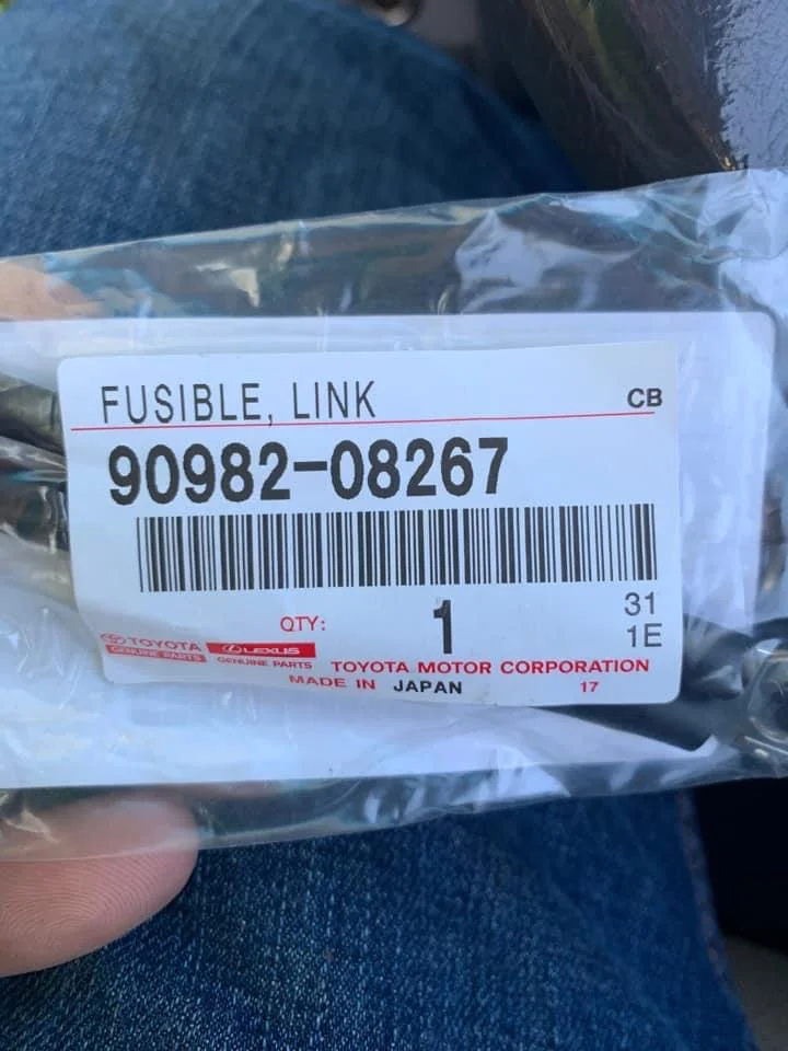

Not looking to replace. But have spare(s). Up to this point, I’ll summarize the discussion. Our present part number is NLA. I’m not going to risk messing with my only (installed) fusible link, but my assumption up this point is that the color of the wire and the “B” and “L” depicted on the black wire cover box determine the fusible link type required. So I’m just asking for other input. Dusten isn’t wrong; at some point there’s no way to confirm unless it’s used. But I’m just trying to piece things together as we see them and understand. I understand Matt this is what you’re working on.

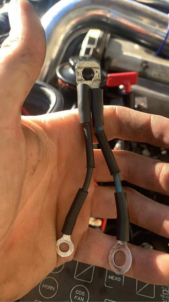

I posted a similar ask on Facebook and the part I just posted was used by others in their existing diesels. It’s not a part number listed when I input my frame number into Partsouq and reference wire diagrams. But if the blue and black line up (which they do according to my black box label) and it’s a two piece wire as confirmed by Dusten, it might do the trick for that one fusible link.
The old part is 90982-08266 (NLA). Wondering if 90982-08267 can replace it.
The B and L are simply colors.
1.25 and 2.0 are wire size.
If they are the same wire size they will work.

the color of the wire is a good reference point , but .........
i have seen same color YAZAKI & Sumitomo fusible links wire , but different mm. spec's
just be double sure , its a match is my point ....
and YES , disturbing your current fusible links set up especially if visually fragile or cracked is not recommended
