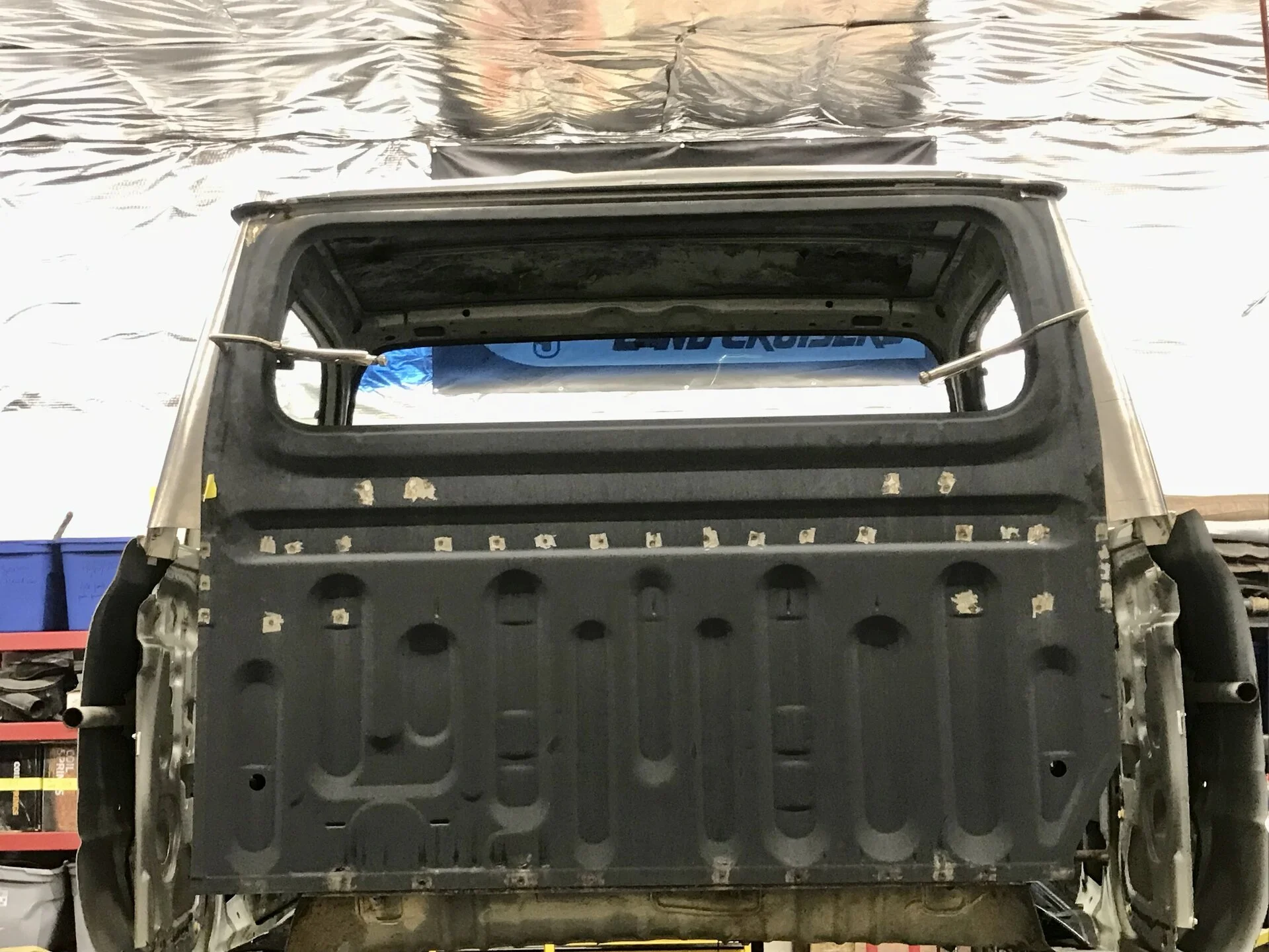

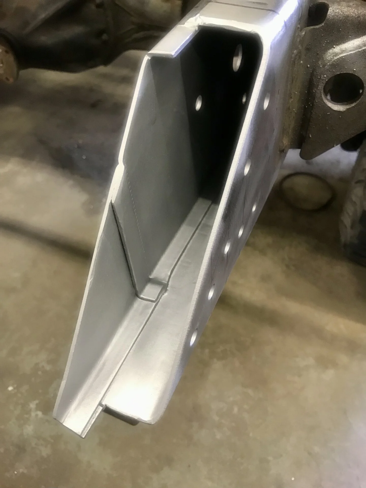

Nice job of the metal work! Your handy work?
Nah, Chris who works for me. He is the sheet metal guy. I tore into the chassis extension today while he worked on the cab.
Cheers

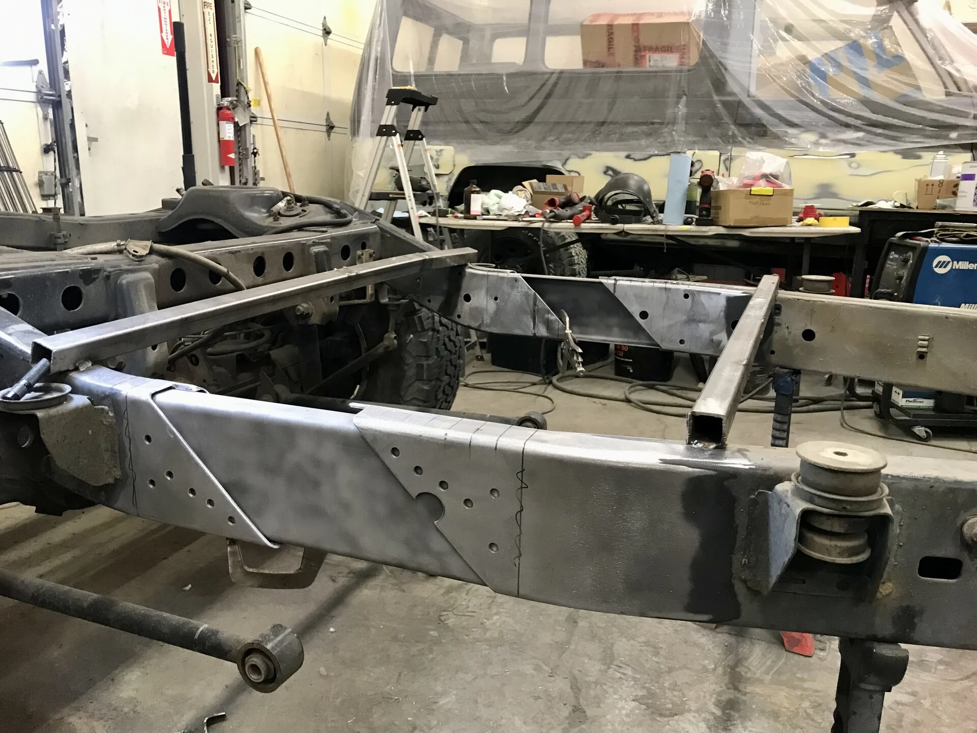

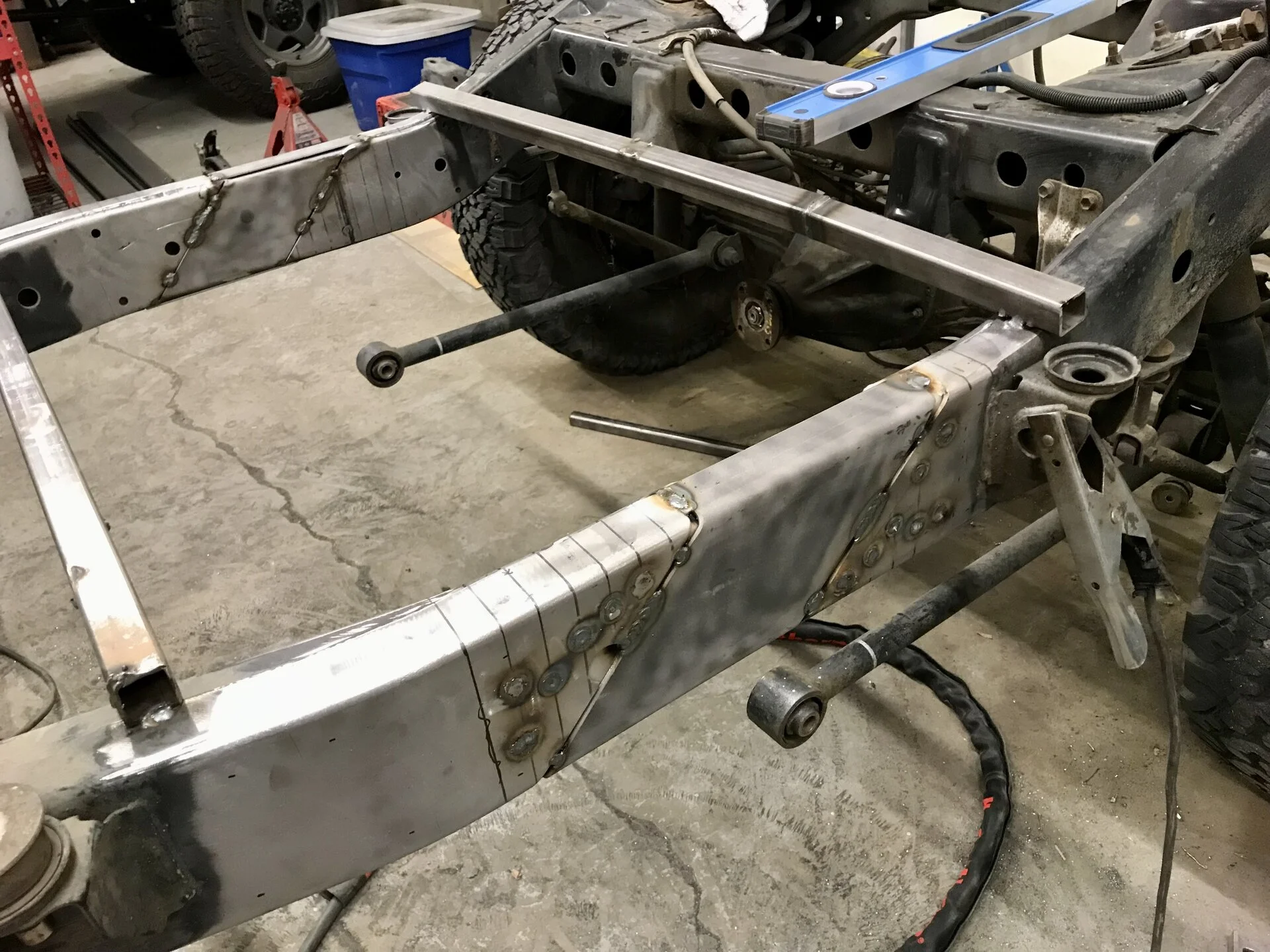

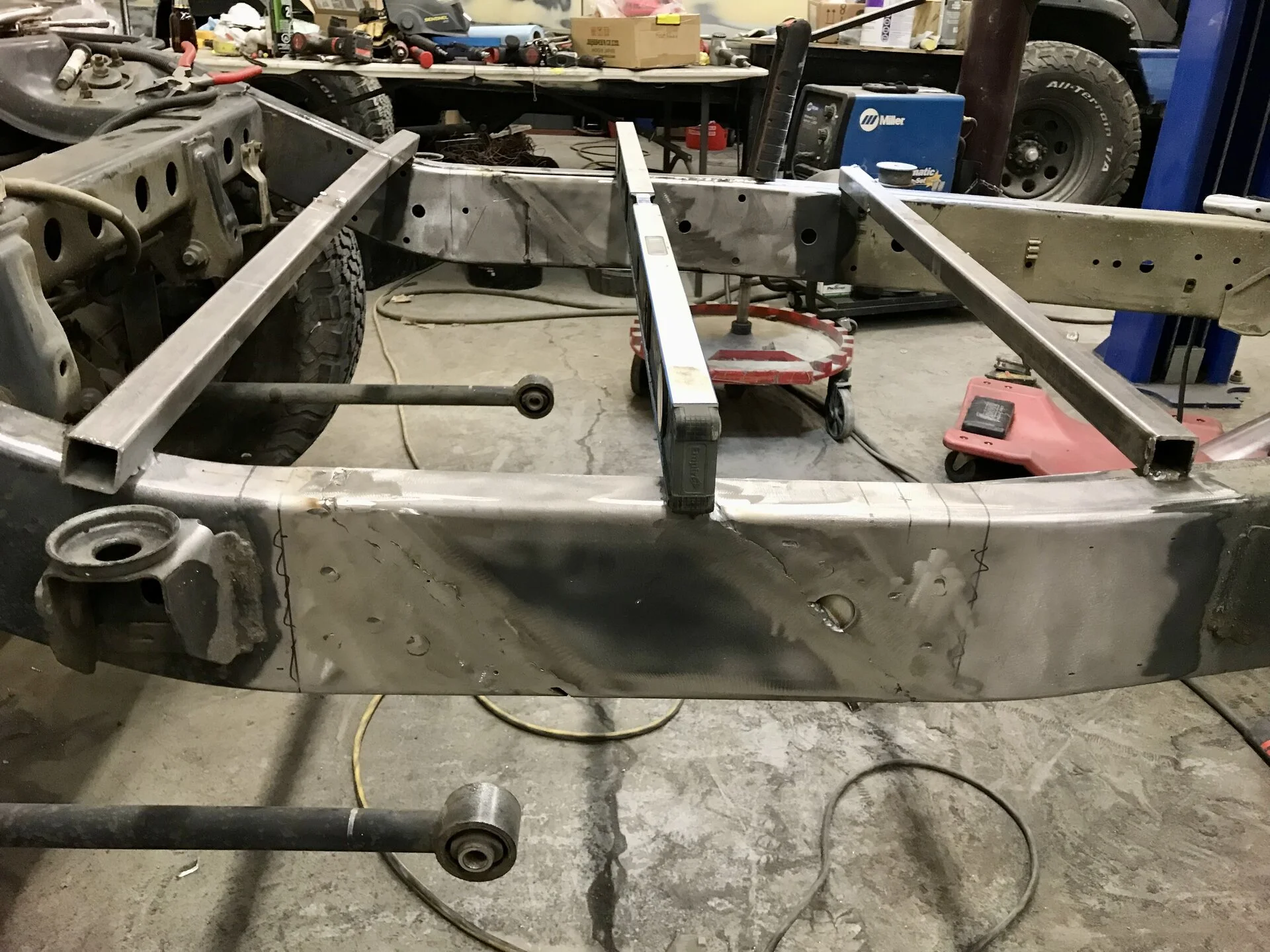

Lots of prep and setup for stage one of the extension. The Troopy in the background is on an 80 chassis and wheel base is right around 118”.
Internal sleeve before boxing it in on all four sides.
Should be landing right in the 119-120” wheelbase.

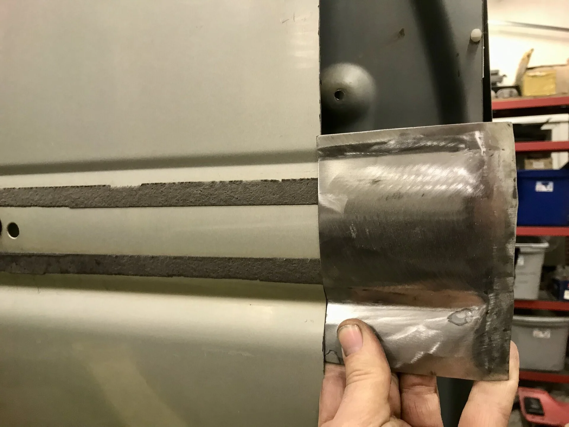

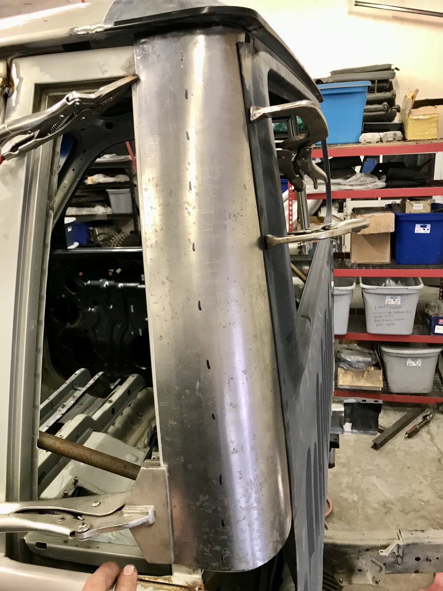

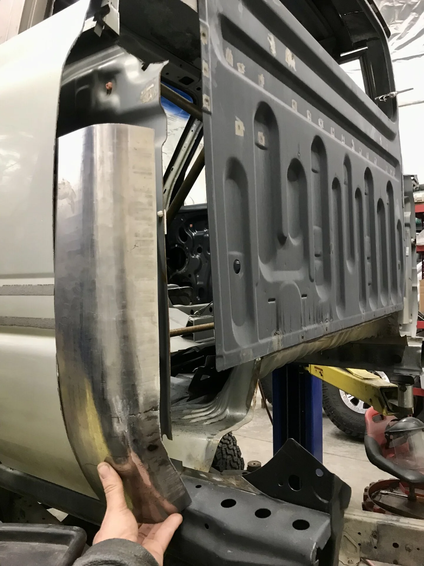

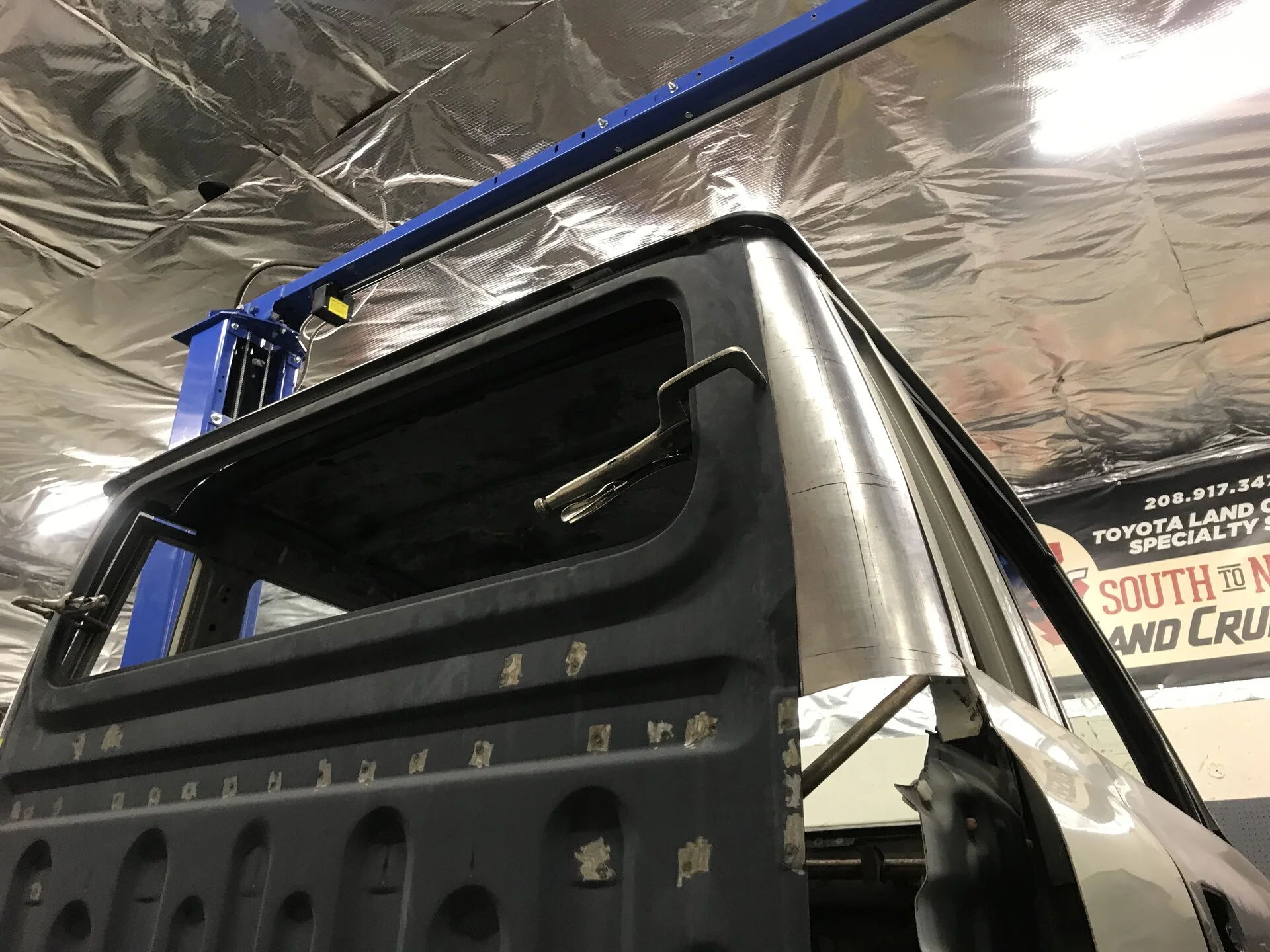

Chris spent some more time after lunch massaging the cab corner before we both agreed it was good to go! 🥰
Cheers

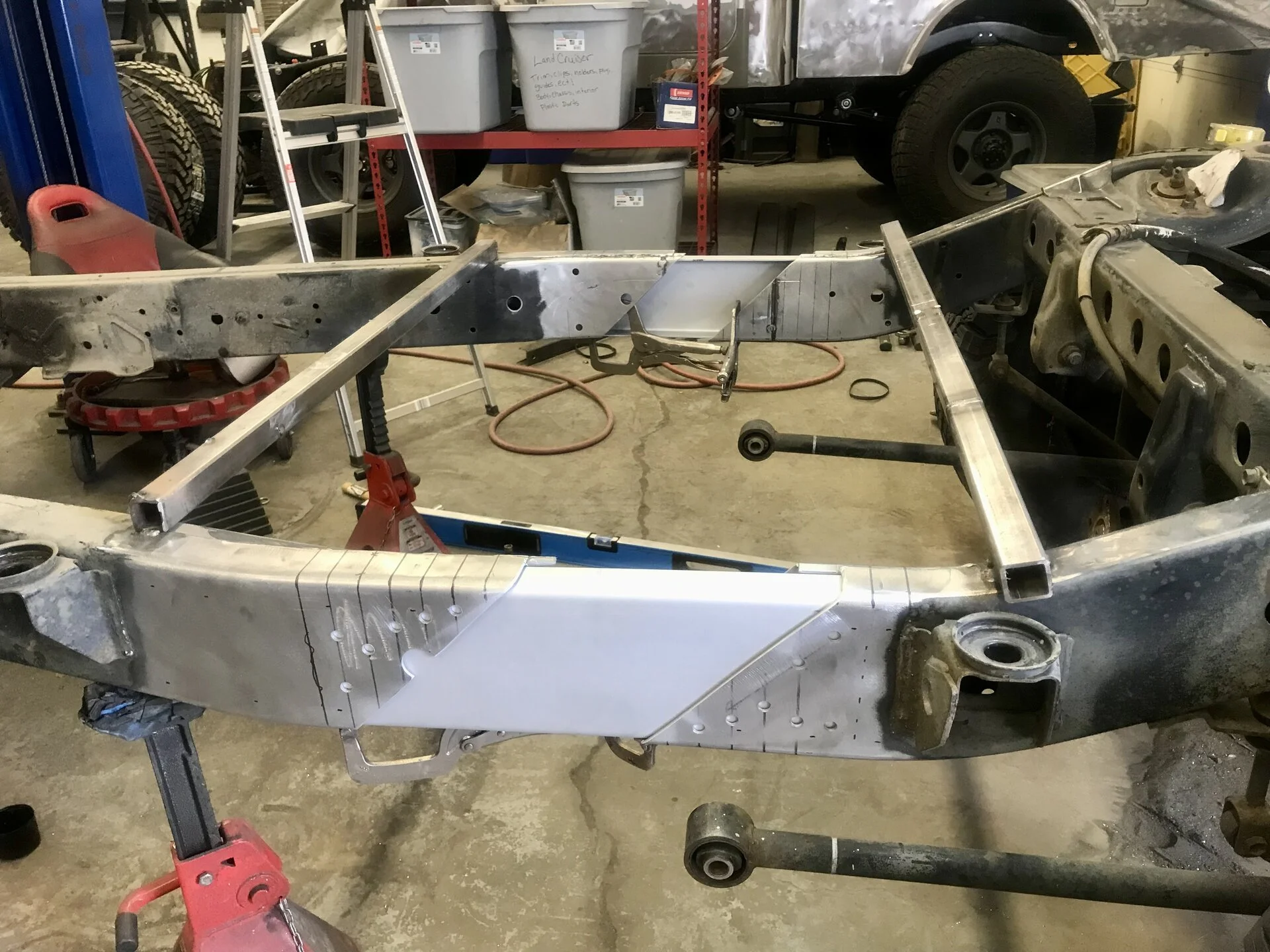

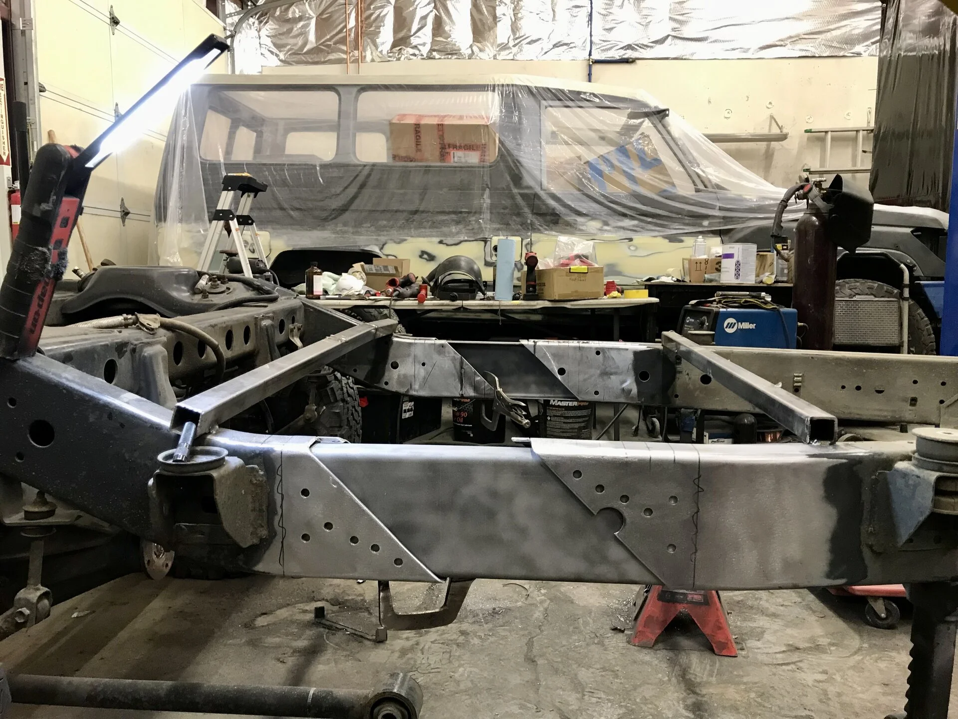

Inside the rails takes some work before you can slide the sleeves into position. Weld through primer as well.
Taking all the time we need to square everything all up.

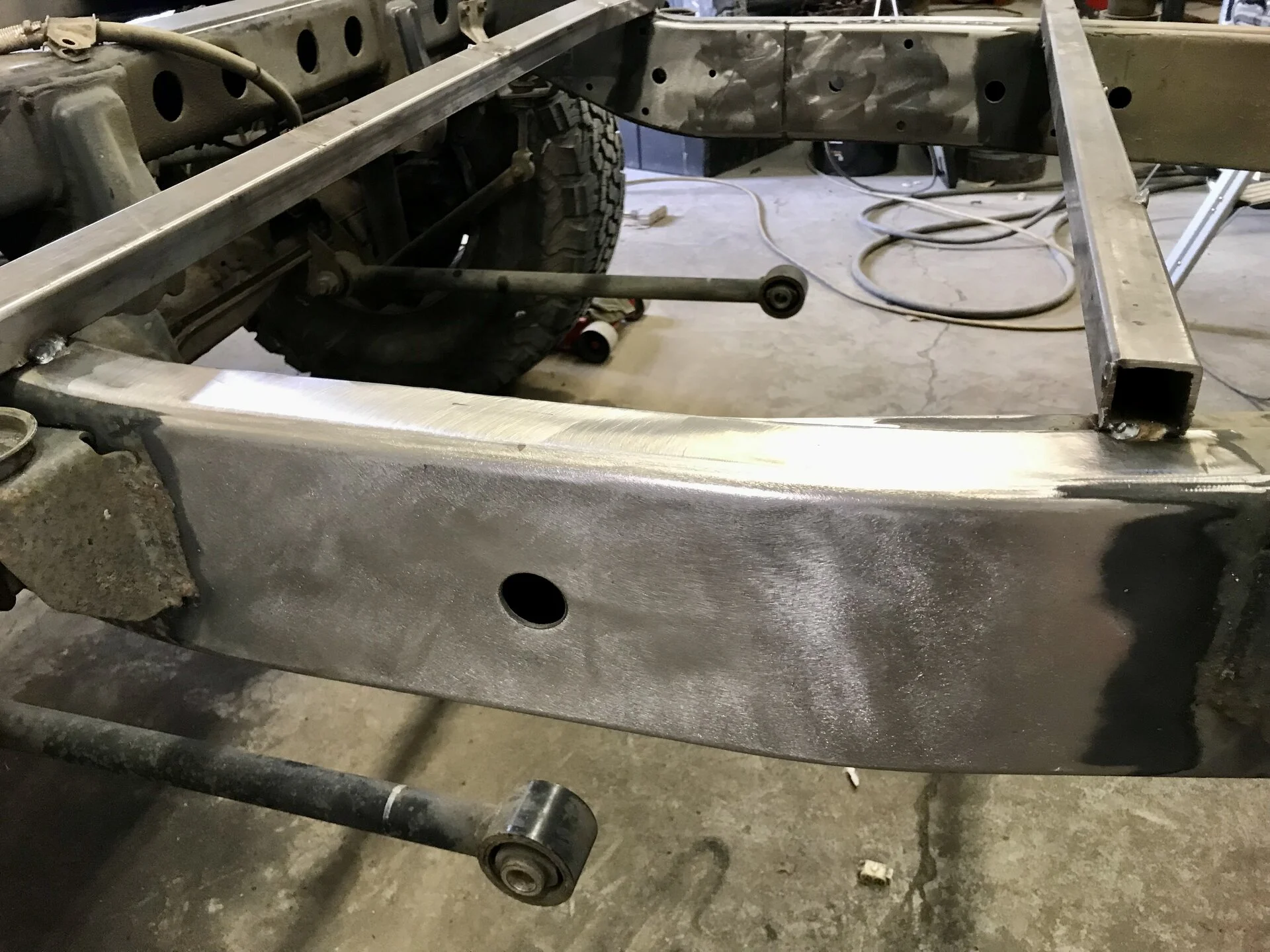

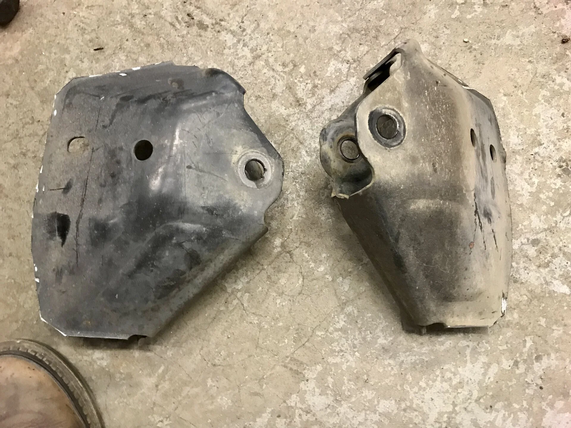

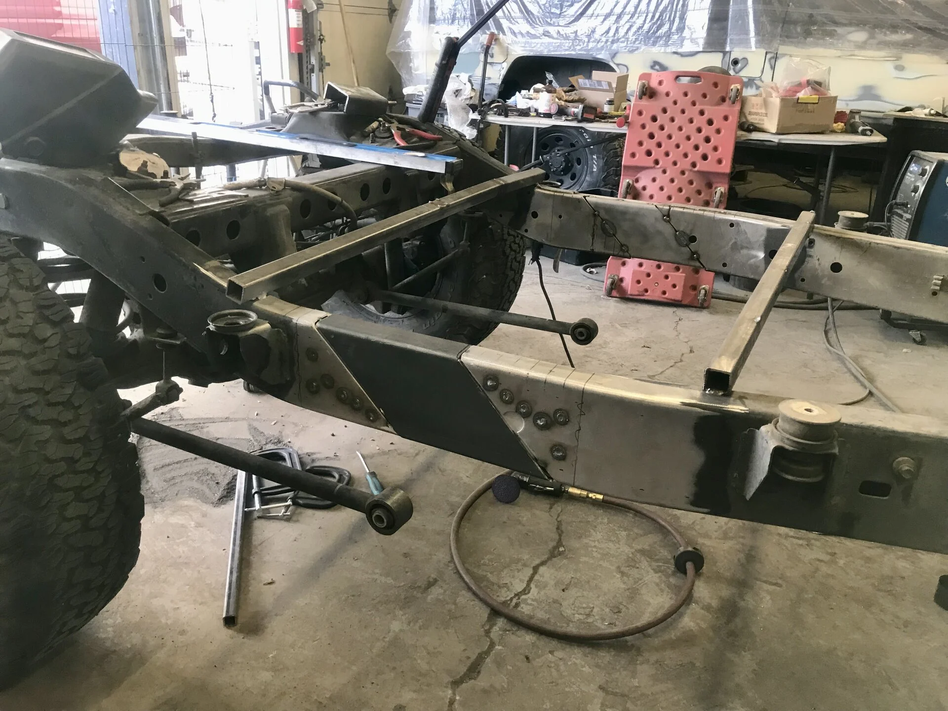

Well there is a day.
A bunch more welding to do, burn the RLCA mounts on and to finish it off we will add a 2” dom crossmember.
Cheers

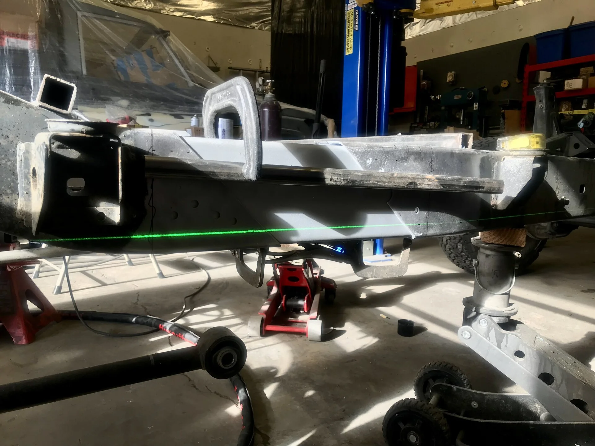

Aren't you s'posed to stack dimes for instagram cred??
Nice use of the line laser 👍
THE best invention since Noah was a lad!

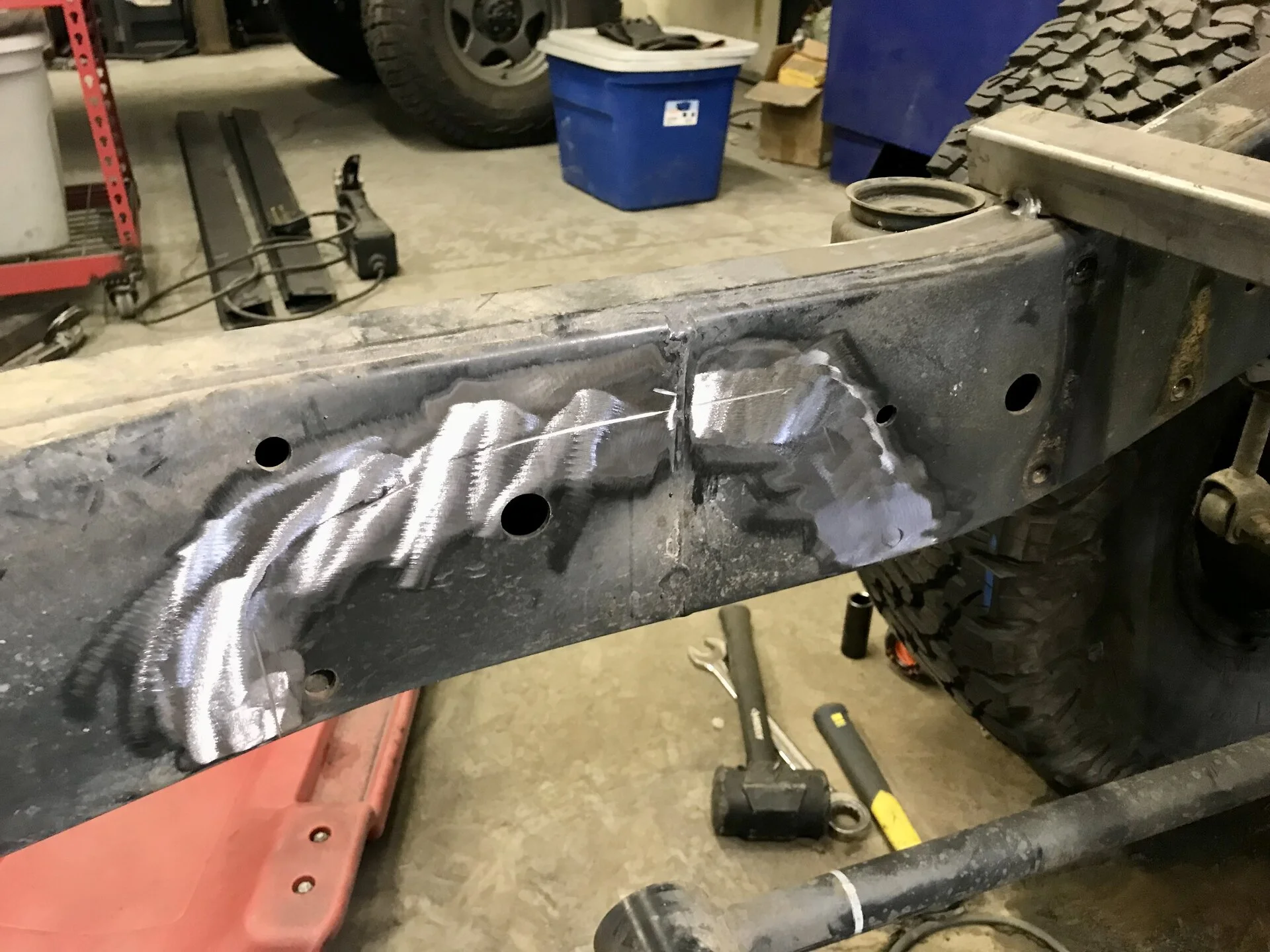

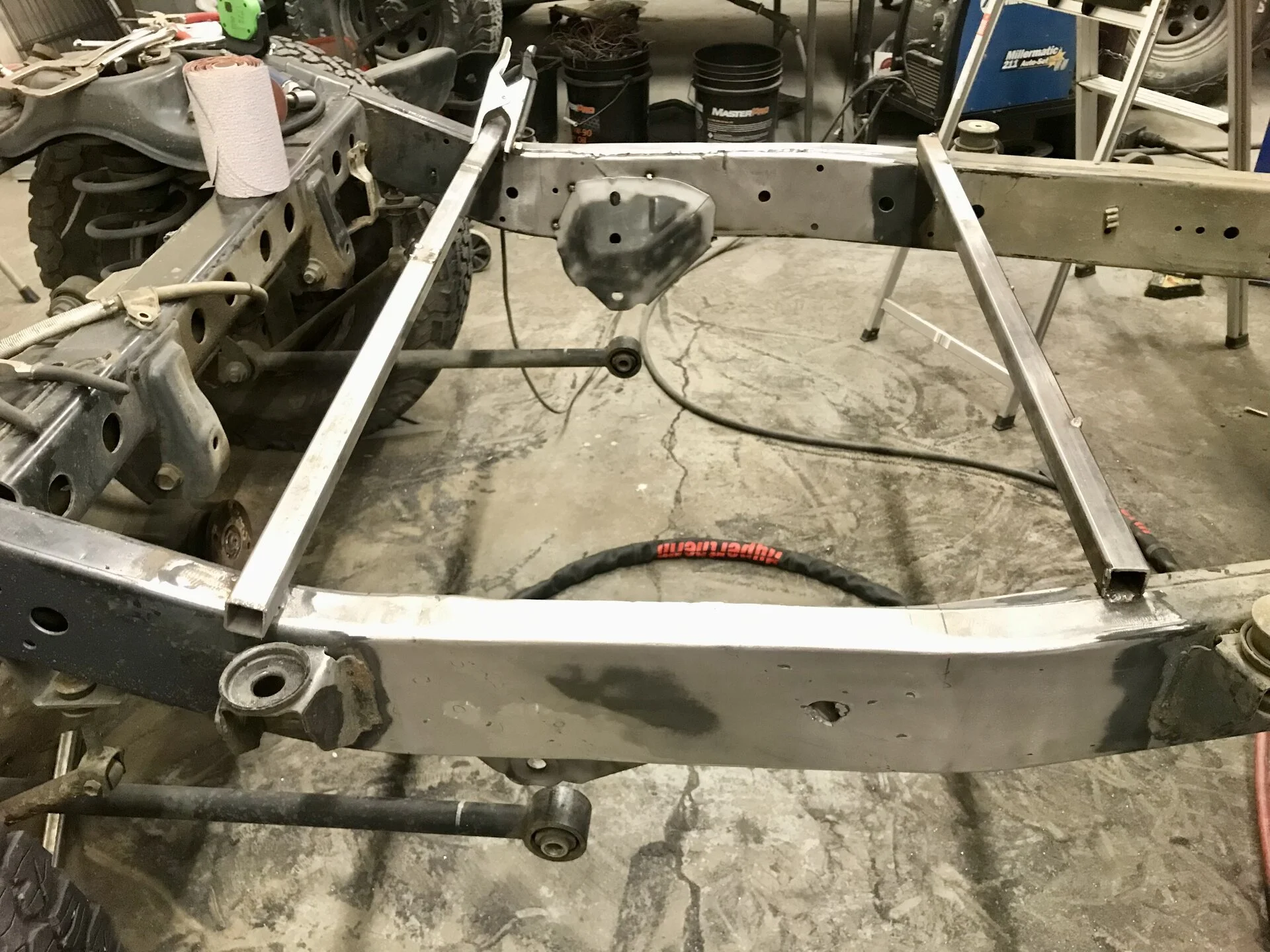

I stayed late and welded plus did a quick grind back.
Departure angle, with 285’s! 😂
Five foot bed.
Six foot bed.
