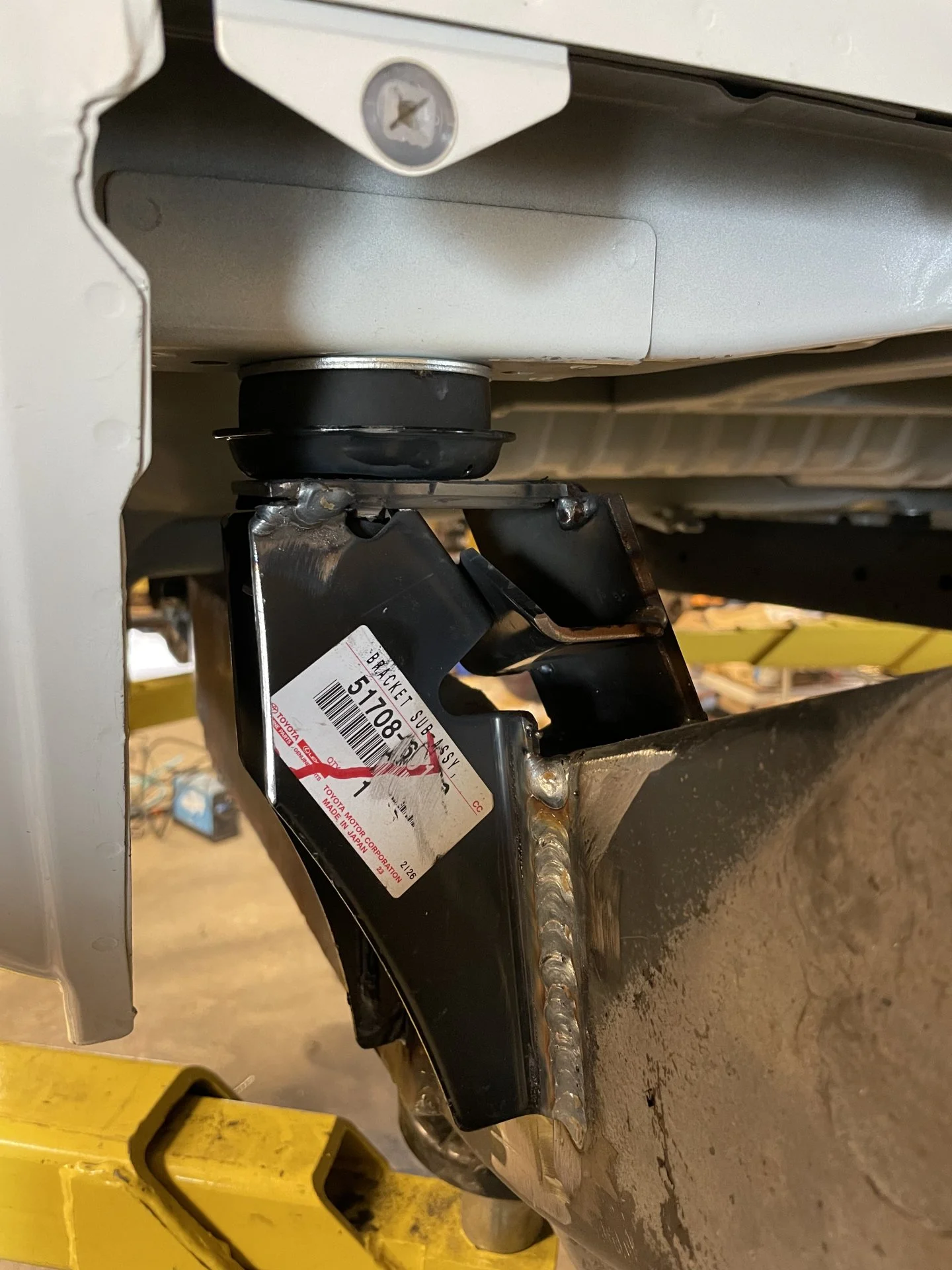

Frame mounts for the double cab:

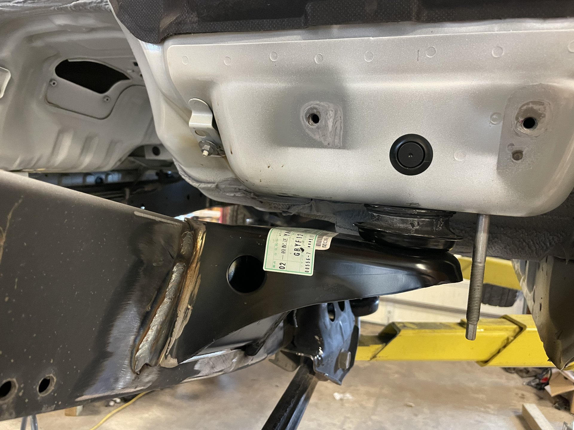

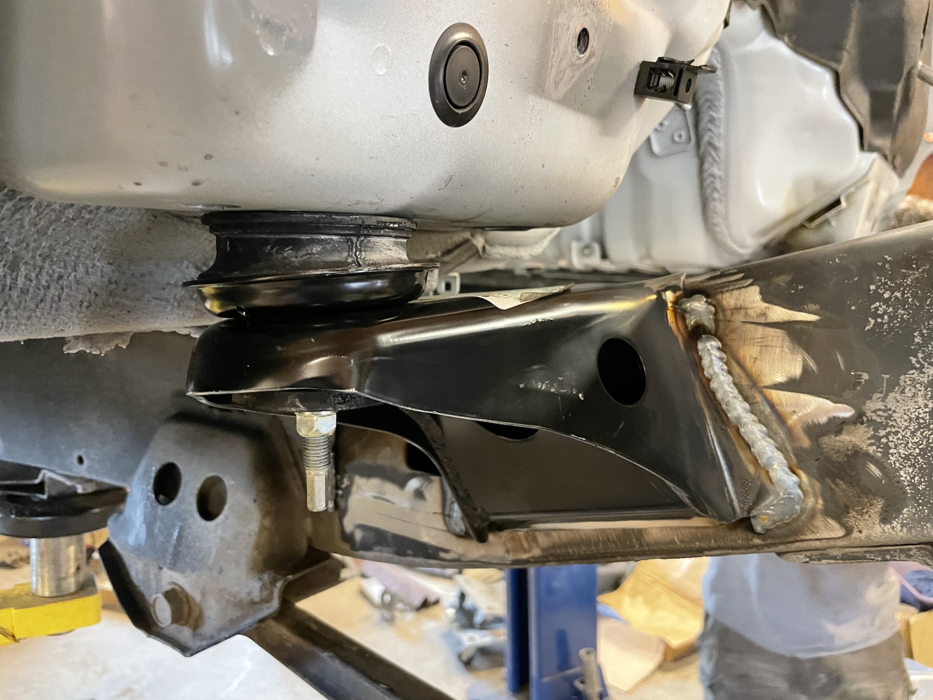

We used the same premise that the middle cab mount for the 80 frame would line everything up for and aft. There are three cab mounts on a single cab, and the double just adds a fourth at the rear.
The middle cab mount, essentially at the B pillar level, was about 46 inches of width instead of 45 on the single cab 79. I bought a whole new set of OEM 79 series rubber isolators and mounting hardware, and we were able to coax the bolts into place with just a tiny bit of angulation.

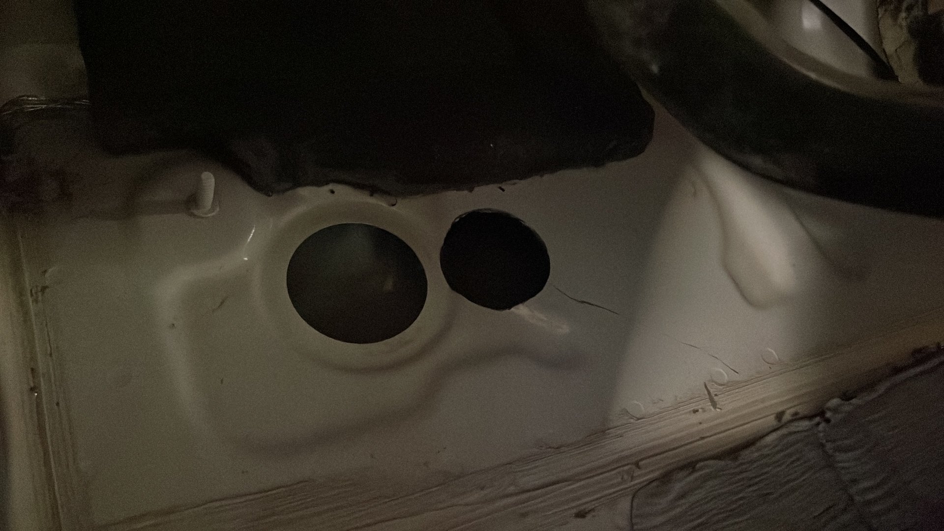

The front cab mount is from a VDJ79 and readily available. Everything lined up just putting the bolt hole about 1 inch to the middle. We just drilled a new hole in the foot well, bolted it up and it fit well.
The fourth cab mount in the rear required a little more massaging. Bill assures me that it won’t fall apart. Still needs to be finish welded.
Front left of cab:
Front right:
Footwell:
Rear of cab, left:

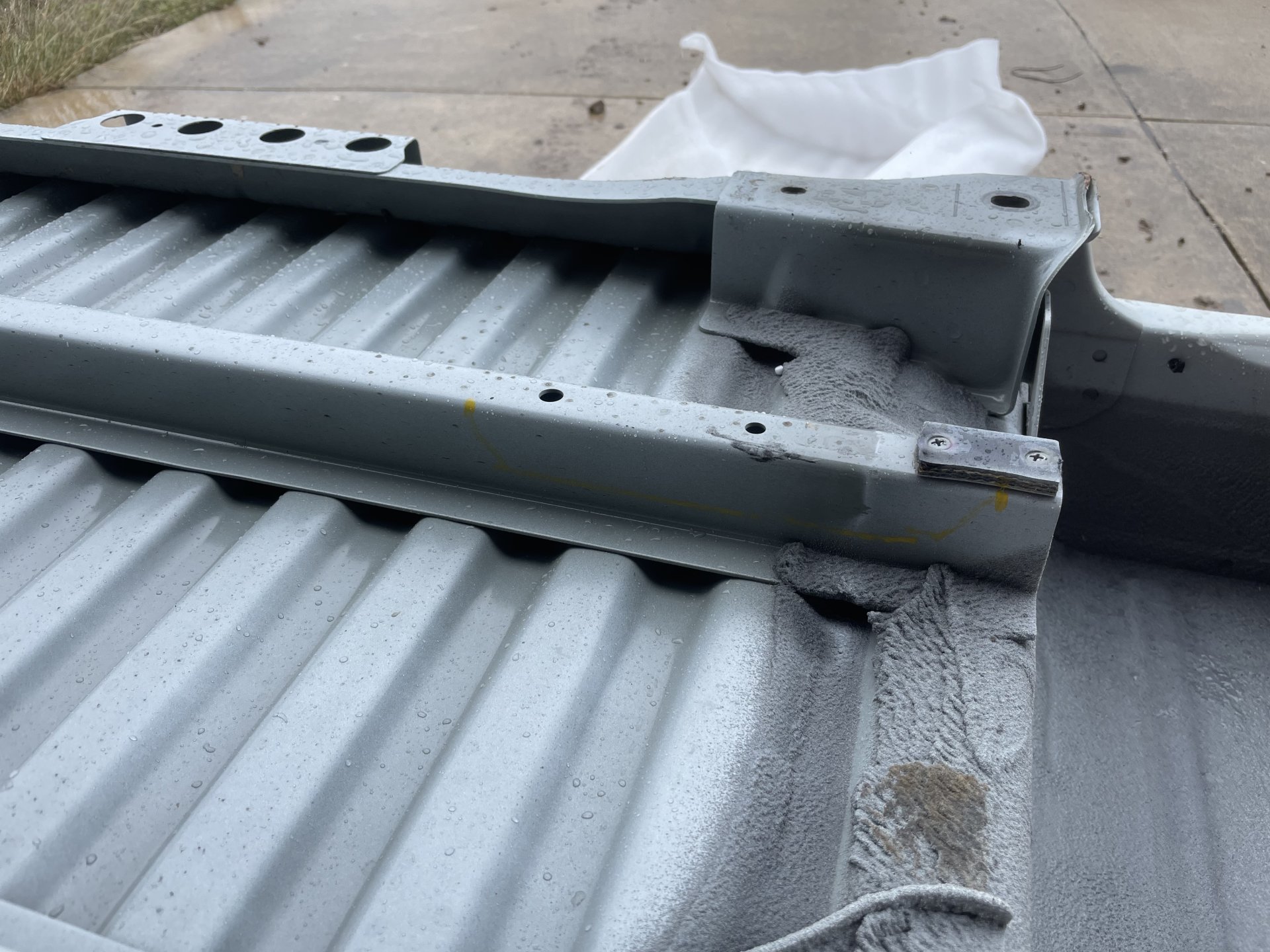

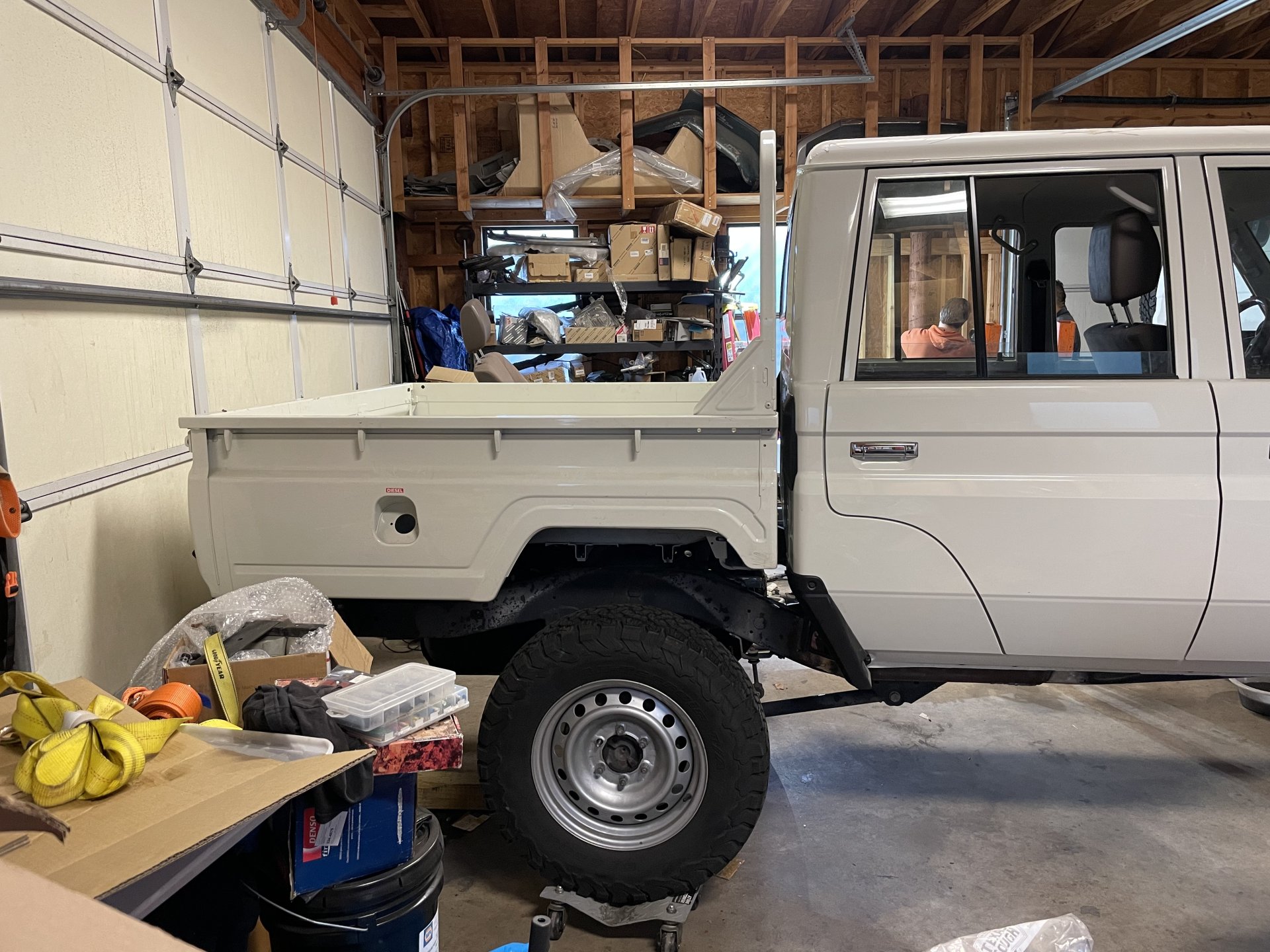

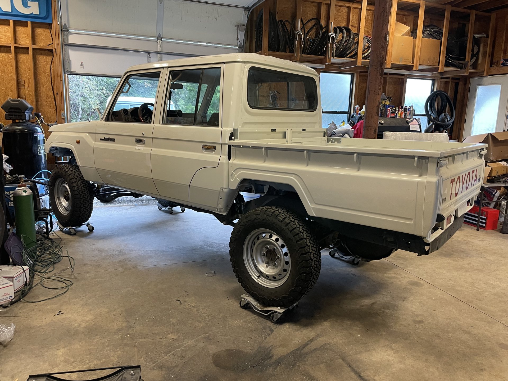

Bill got 4 bed mounts fabricated before he had to go. We had to relieve the front horizontal rib on the bed to clear the rear shock tower.
I like this thing a lot.

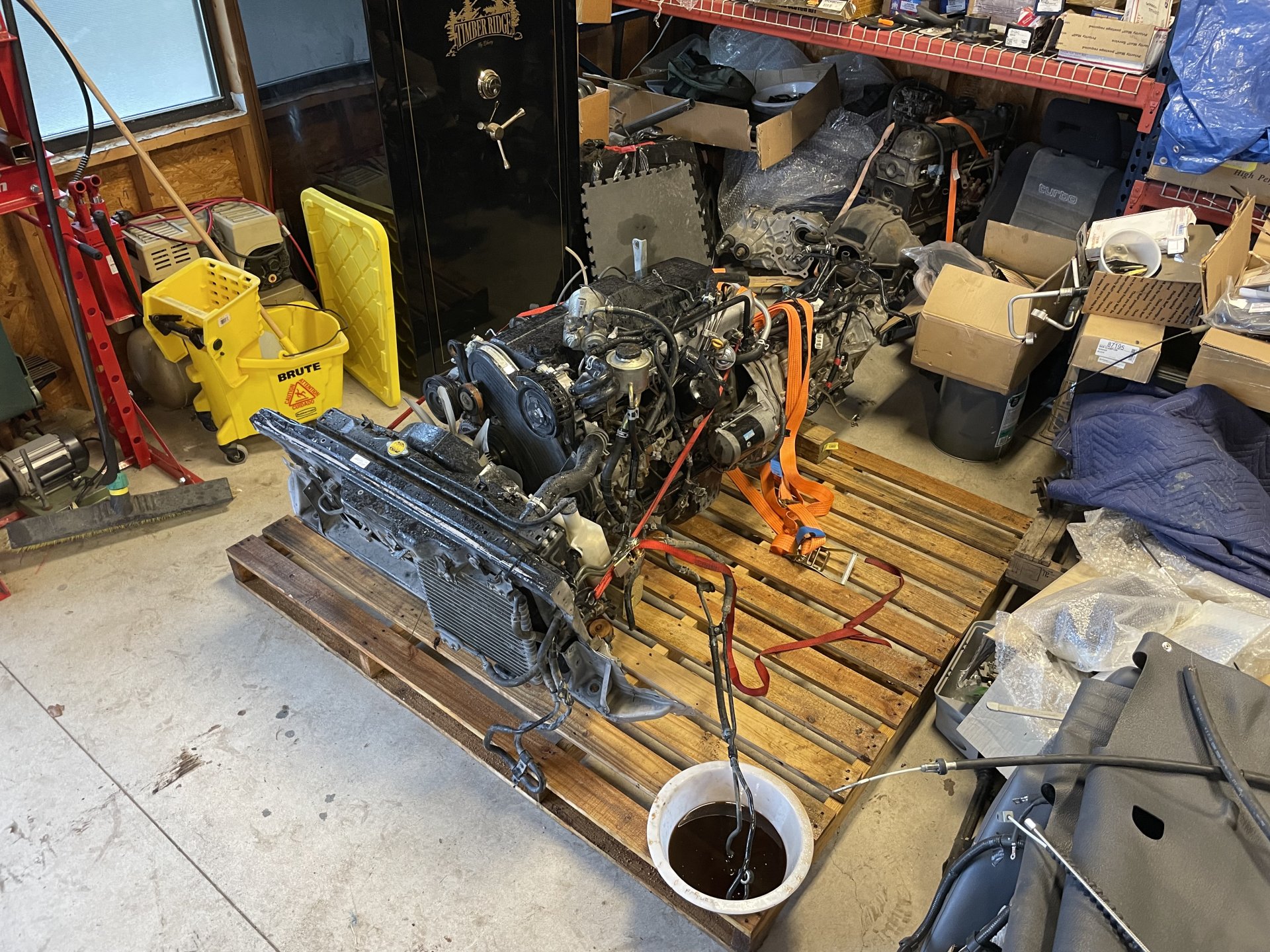

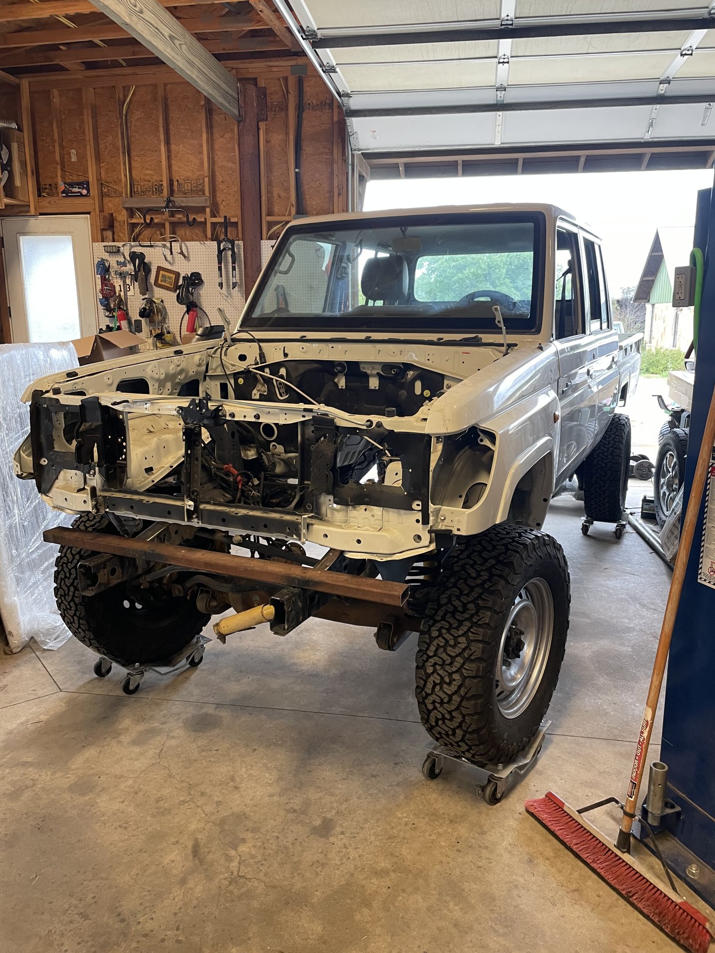

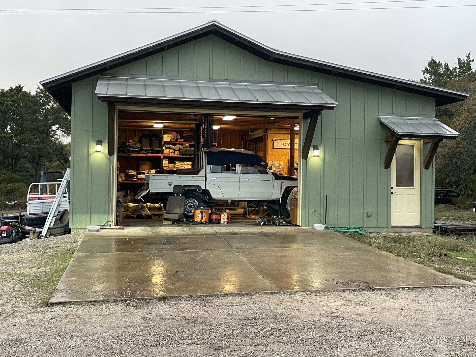

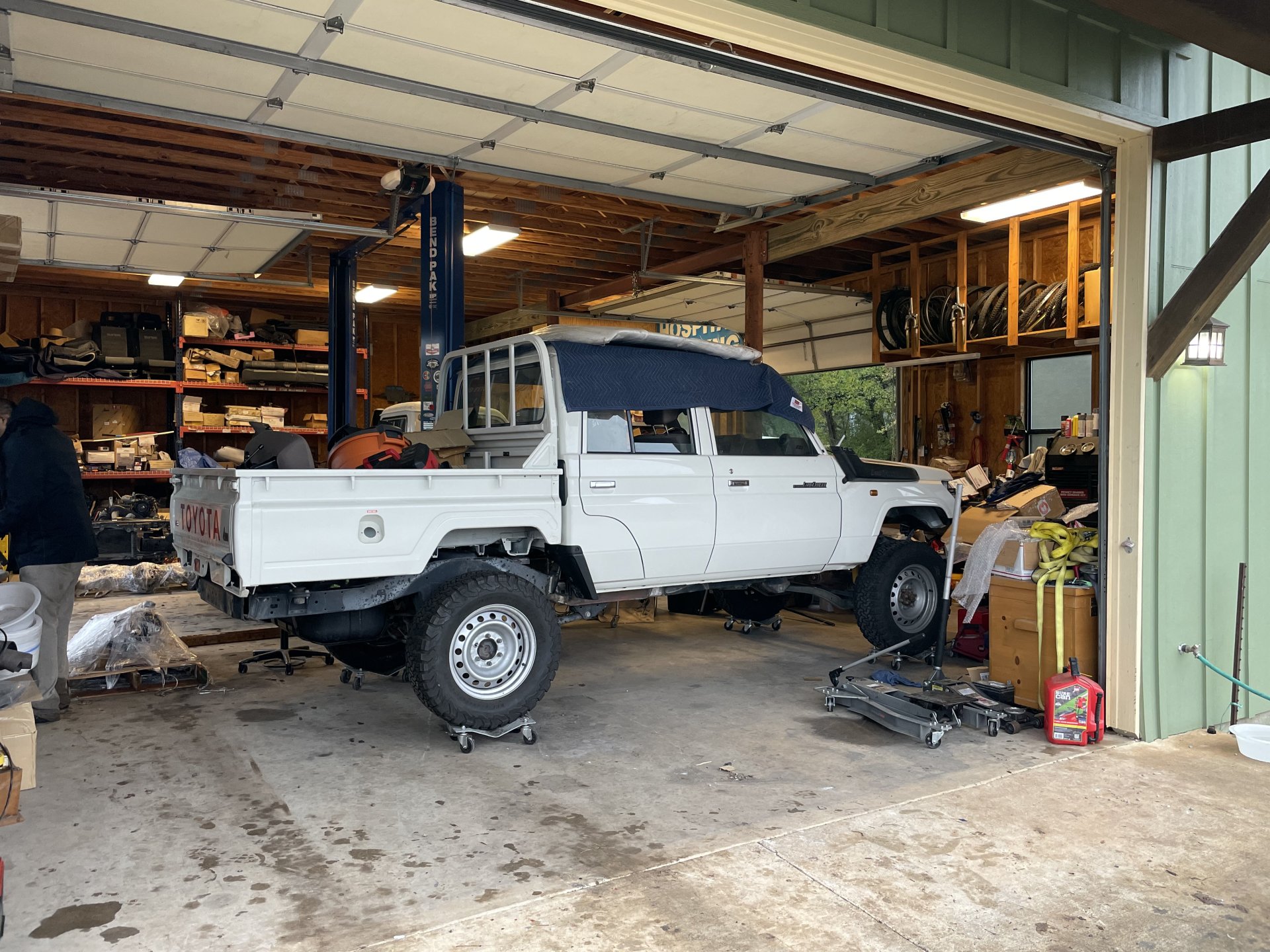

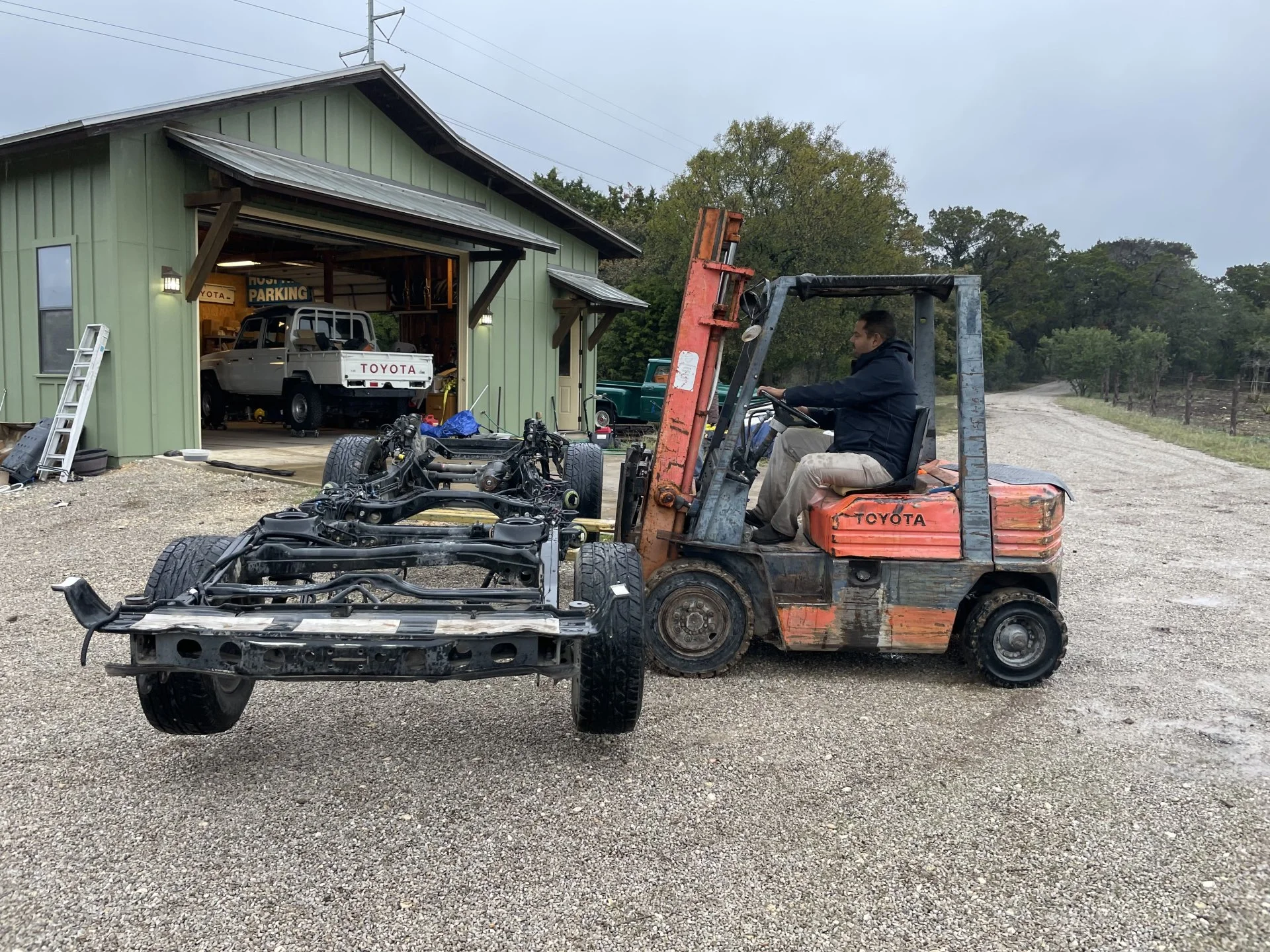

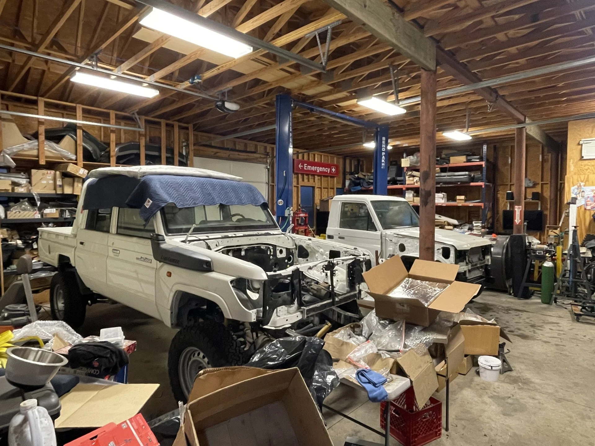

Over the weekend @AlbertoSD and @Spallet swapped transmissions in one of @Spallet’s trucks using my shop. Today @Fern1109 joined then as we pulled the FTE out of the donor chassis, cleaned up the car barn and got both 79’s inside.
Amazing what you can do with a forklift on a rainy day.
A forklift is like having 10 body builders sitting around ready to help on a whim of a switch.

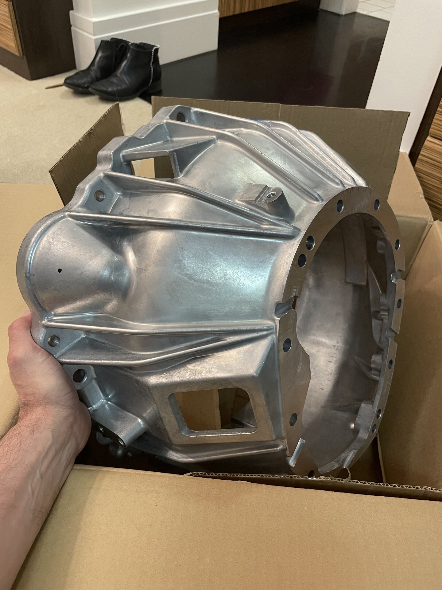

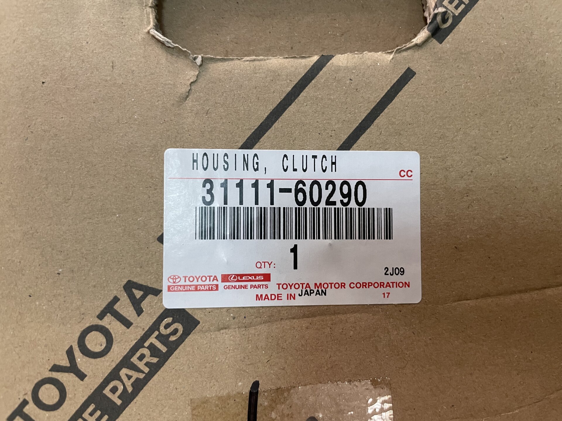

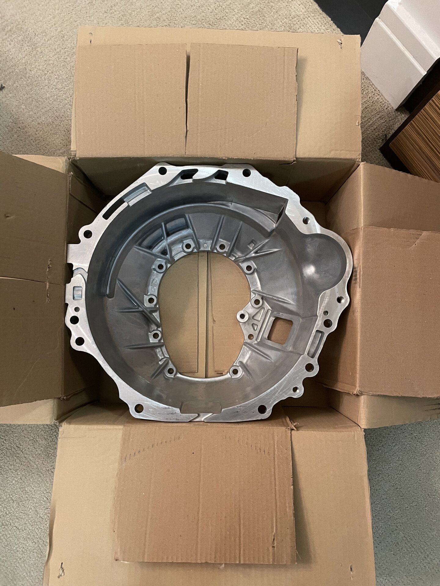

One more pice of the puzzle: h15x bellhousing arrived.

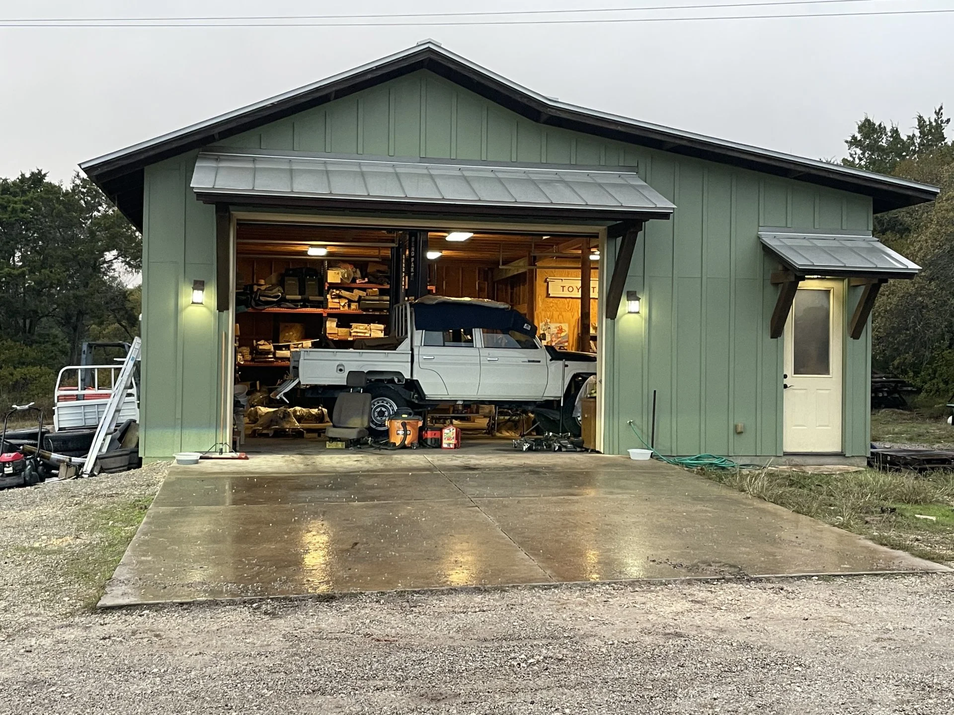

nice pull through bay in the shop 👍
i did that to mine as well, makes for nice access,
i just dont have the lift
I was going over this thread and i felt pretty lazy so i had to go and work on my cruiser😄
Thats a killer landcruiser production facility
@bj70bc thanks for the kind words, but this facility has only produced one running Land Cruiser so far. Assembly line and workers are inefficient.
