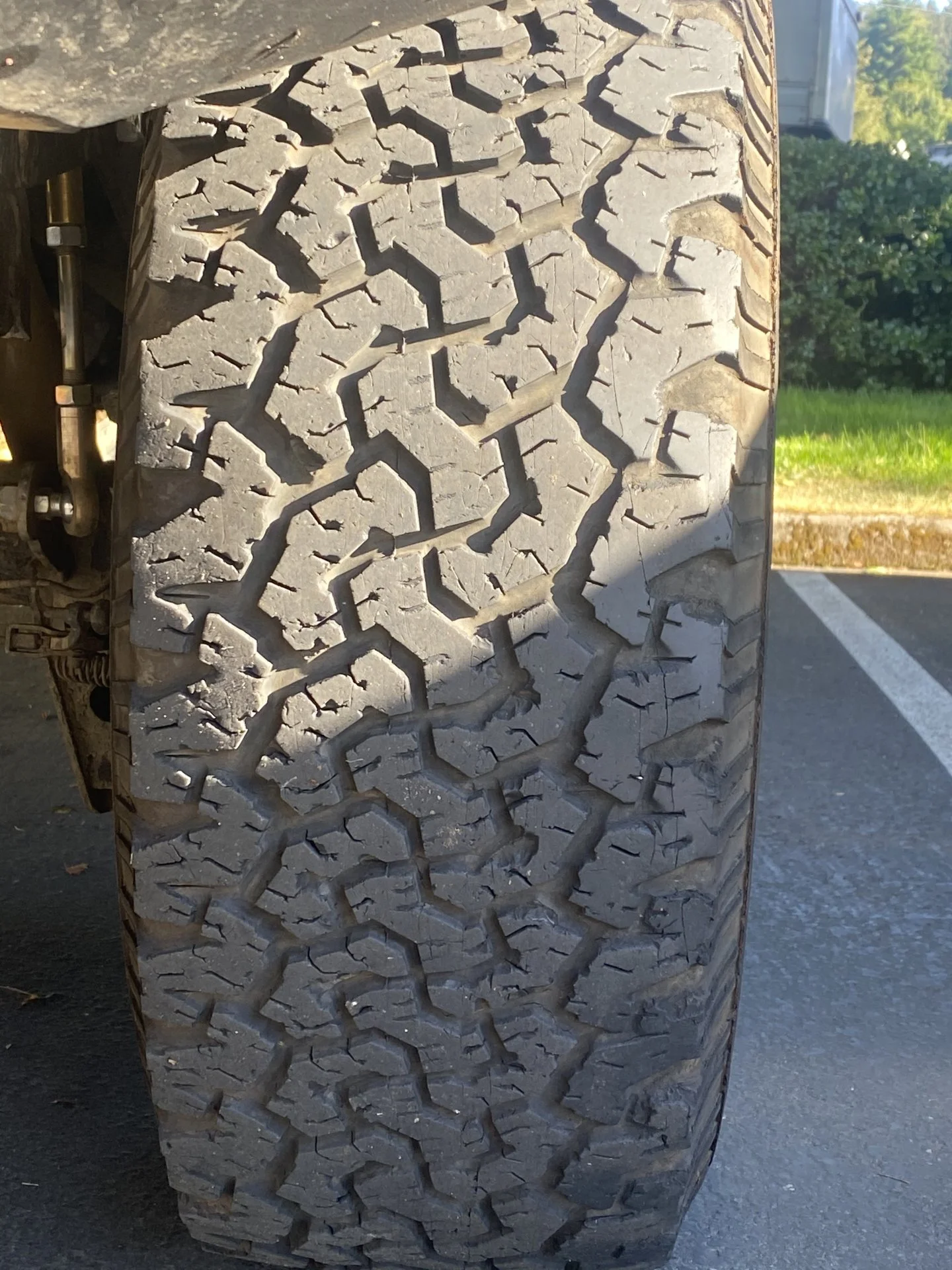

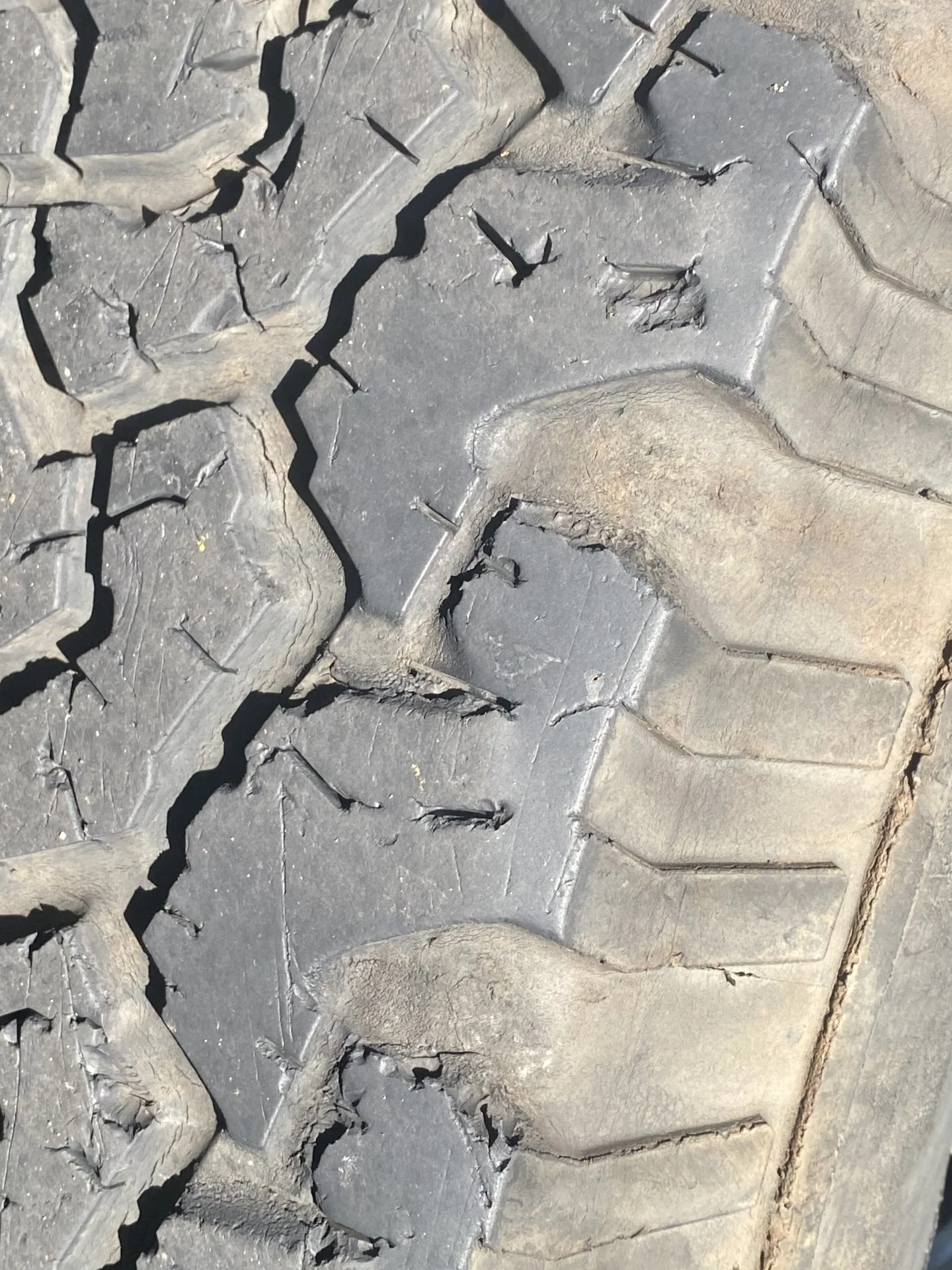

Haven’t seen tire wear like this. Any clues?
Jul 17, 2022
5
125
medford oregon
So I have a 80 series RHD land cruiser and the rear is wearing real weird. The right side outside tire is wearing real bad and left hand inside real bad. Now tires are old from 2011 and I assume put on in Japan, it’s on a dobinson 4 inch lift with there rear arms.. I chanced to see if the axle was strait and I want to double check but it seamed fine. Any insight or things to check let me know I don’t want to tear up the new rubber going on.
Get an alignment checked, you should be able to see if the Thrust angle or axle tubes are out of whack.
Maybe a few things.
The age of tyres perhaps, if it was just outside maybe uv, but you have inside too.
How did you check axle housing straightness?
I jigged up something similar to my axle housing, as in this video, with several sized bushes and a barbell. If you can access a lathe even better to size the bushings. You shall have to remove diff, axle housing from springs, brake lines etc..
It would be odd that the internal wheel bearings on one side and the external on the other side were set incorrectly. But maybe worth redoing your rear wheel bearings.
Did you do the wheel bearings yourself? Always good to thump the tyre a fair bit with a heavy hammer to simulate potholes and rocks whilst setting preload.
Or, yes take it to an alignment shop or diff shop, diff shops straighten housings all the time apparently. Dukes of hazard sort of damage.
Wonder if your chassis is straight?

Alright so my first thought was I had the links adjusted wrong literally making the axle having a leading edge that’s what I checked. I haven’t checked the housing but I think I’ll have a alignment shot check since that’s far easier than setup up jigs and crap. The chassis seams good it definitely had a accident on it from what I’ve seen but no visible signs and honestly it tracks and drive well besides besides worn out bushings and definitely bad tire balance.
Wheel bearings haven’t been done since I bought it. I adjusted the front ones but the rear is tight but may be worth a look since those likely were done in Japan.

Yeah that’s my plan I have to get tires put on soon like maybe end of the week so I’ll probably have them to a alignment since I’m pretty sure my tow is off after some hard wheeling got a slight pull after that trip typically with past rigs means it got tweaked a tiny bit. So while it’s on the rack I’ll have it all checked out.
Depending on what that shows I’ll know next steps.
