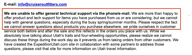

Just a quick thought—maybe call one of the vendors that regularly installs these. They'll have more first-hand knowledge of the hardware.
Slee and Cruiser Outfitters come to mind. Both available by email also, so you can attach the picture.
I like a lot of ARB's equipment, but I always call Cruiser Outfitters with questions.
I will try this route. I always don't want to bother shops since I have not bought that from them out of respect.
