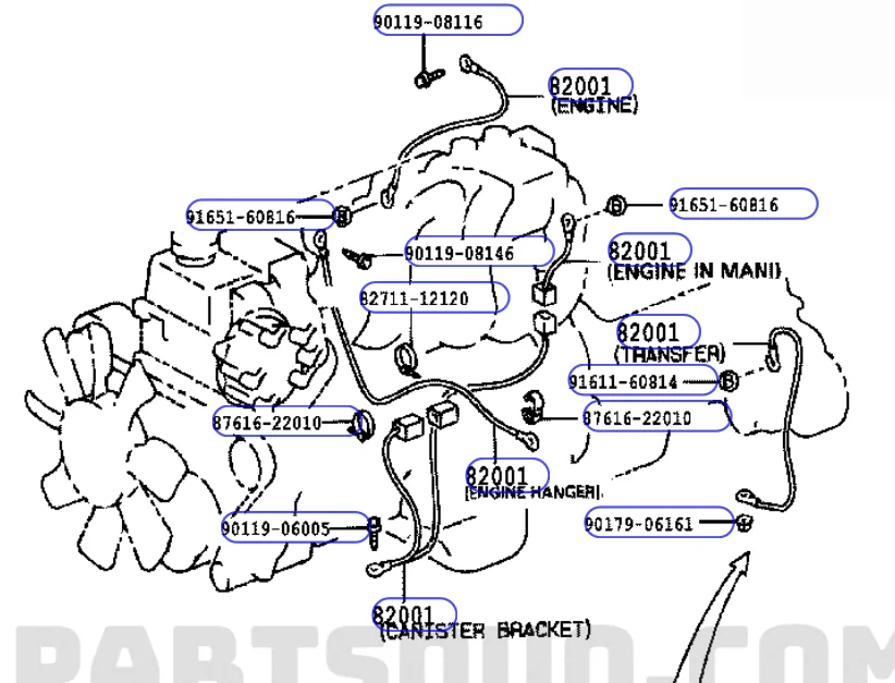

Also, I’m going to replace the main cables off my battery. They are original. I need to order the positive cable. The negative cable (OEM) I have. Quick question, on the negative cable (battery side) there are 2 terminals. The negative cable going from the battery on my truck goes into a loom of wires. I can see where the one terminal goes to the block, but can anyone tell me where the other terminal goes? Maybe on the inner fender??
A photo would help.
There is a fender mounted ground strap, about six inches from the battery (-) terminal. The upper ground point is on the inner fender, inside the barrtey box envelope. The lower one is on the frame.
(This image is reversed in the parts fiche images, for some reason; it's from the '95 catalog. It should show the (-) lead on the right side of the battery)
There are also a couple on the intake side of the engine and one on the frame on that side. These are all the loose and harness-related grounds:
