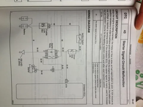

Could be #1. Starter Signal Malfunction. Here's the decription from the manual I have on the circuit:
when the engine is being cranked, the intake air flow is slow, so fuel vaporization is poor. A rich mixture is therefore necessary in order to achieve good start ability. While the engine is being cranked, the battery positive voltage is applied to terminal STA of the emission ECU. The starter signal is mainly used to increase the fuel injection volume for the starting injection control and after start injection control.

IF this is the problem then you would have no starter signal to the emission ECU (located under the dash on the passenger side). The trouble area will be:
open or short in starter signal circuit
open or short in ignition switch or starter relay circuit
emission ECU
I posted a wiring diagram which should help to test these items
