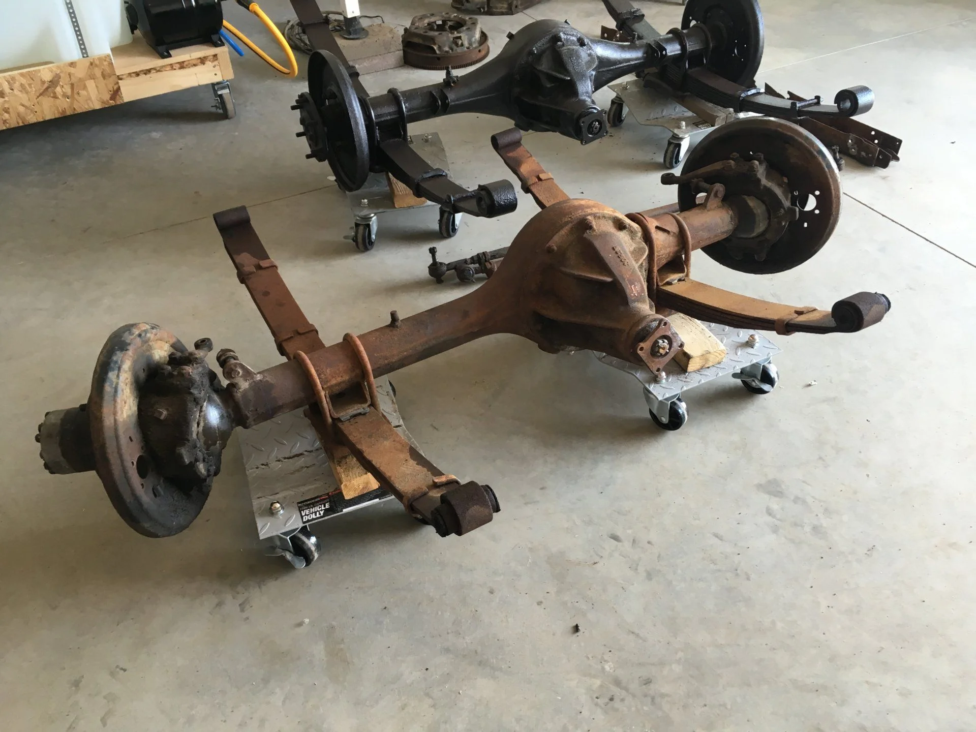

Like I said my biggest issue is getting the wheel to like up. Personally this just a hobby and not looking to spend big bucks for roller I occasionally use. For transmissions and axles use the cheap HB furniture movers I can get for around ten dollars and around seven for the small ones. Use boards to help spread the weight and they work fine.

I had my China Freight dollies under the whole truck (45) for a bit, then under just the frame/drive train/engine a bit also. They worked, but so did I moving them around my small shop. Now they’re used for moving my axle assemblies around, good for that, but hopefully not too much longer before getting bolted back on frame.
