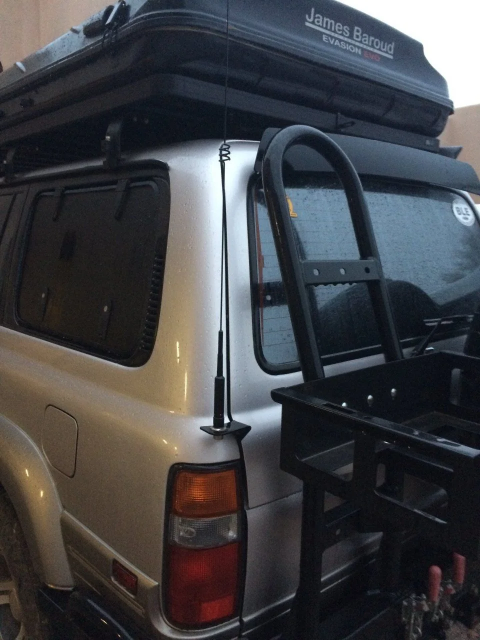

Should have been more precise. I run a Diamond NR770HA which is a 1/2 wave antenna.
I run that antenna on a YodaTeq rear hatch strut mount (Wilson Trucker 2000 on the other side for running 'ol school) and it has worked well with my Kenwood TM-V71A.
oilbrnr, I'm surprised that works at all. With what looks like at least half the antenna mast masked by steel. Have you ever measured SWR?
