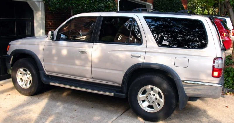

Before Picture of truck
Recent Update

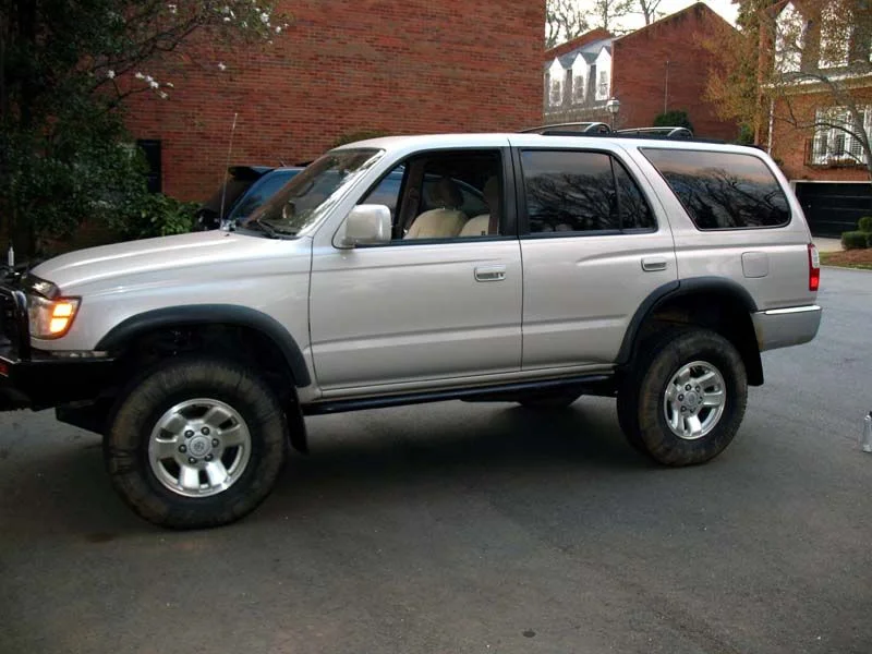

Here is a before picture from this fall
before all the modifications
and then
lets try again
Here in the fall

Here is the before picture of the truck, first thing to do is remove the running boards

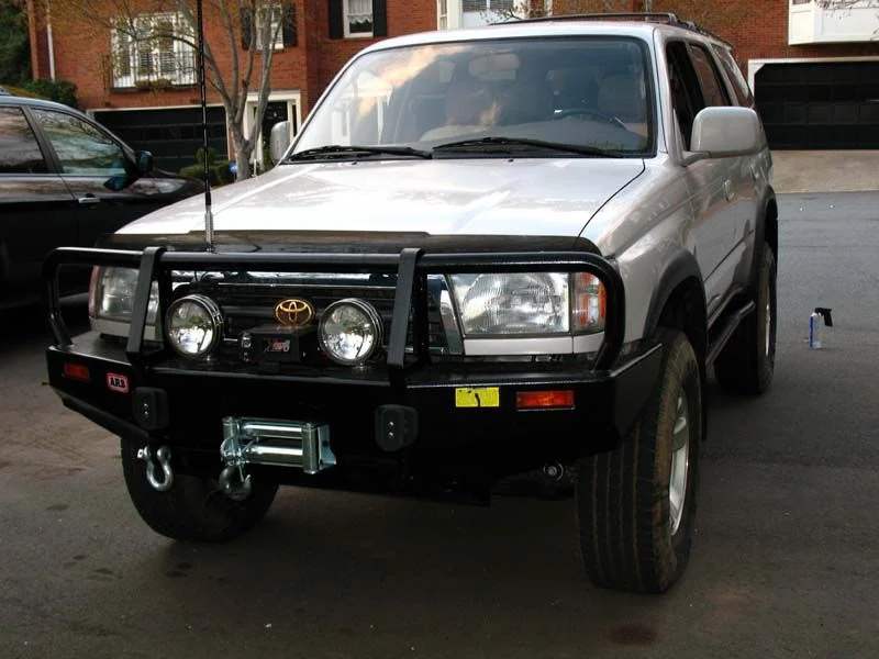

THis is the final picture of the bumper with prior to wiring up the winch.
attachment.php

Here are some final pictures
attachment.php
attachment.php
