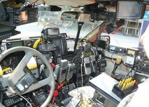

Something like this.
Probably a stupid question, but is there a CB that will fit in a single din radio slot? I'm thinking that if I swap my factory radio for a single din radio then I could mount the CB below the aftermarket radio. My guess is that there is no such thing or else it would be fairly common for people to do this.
I saw similar ones and figured they were homemade. :) I don't know what I was expecting. ???

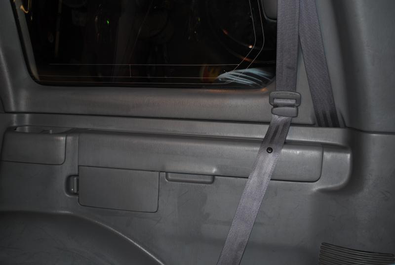

Ok. Finally got my Yaesu FT-7900r installed yesterday.
I had a difficult time finding a place for the base unit. I have a 2002 with nav, so there's no room under the seats, and even after fabing up a few brackets, I couldn't find a place under the dash that didn't either block a vent or make the unit almost inaccessible for future data uploading.
So, I decided to move the base to the rear of the vehicle and ultimately decided on the passenger side rear panel.
Then I ran the power cables, external speaker cable, and remote face cable up to the front.
Once under the hood, the powerwire got a nice wrapping.
The base fit nicely in back. Should stay nice and cool in there as well.
I haven't decided on a permanent antenna set-up yet, so for now, the mag-mount fits perfectly into the upper storage area.

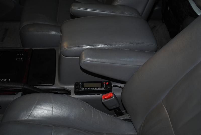

With keeping with my idea of as clean an install as possible (and keeping the console uncluttered), I decided on placing the remote faceplate under the driverside armrest. Works out quite well.
The mic is also out of the way, but still easy to grab when needed (although it's only been a day, my kids think it's a new kick toy).
Your faceplate is where my remote speaker is... .
Same for me. I think you'll realize that it's too hard to adjust frequencies/volume (although you can do some of that from the mic). I took my setup ideas from Nakman. I didn't drill one hole for wires and everything is mostly hidden away.
