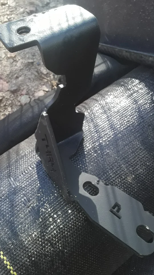

Alrighty.. I went in today and pulled the brackets.
Looks like I somehow got CBI 4Runner Brackets after comparing them online at CBI to proper GX470 ones after @Jstawgn mentioned he was having zero problems.
I did order these through the Apex Overland website, not exactly sure how things got mixed up; But they did. Everything kinda makes sense now, I wasn't being a smart primate.
BTW: The CBI T4R4 Brackets do fit the GX470, just barely, but it's probably not a good idea to run with them.
Looks to me..(after trimming the 4Runner ones today, think madman with a cutting wheel)..like the CBI GX470 brackets will look much better and work just fine. *Just make sure that you're getting what you ordered before you install.*
Here I was impressed at the fit of those dang 4Runner brackets when I put them in a year ago too. 🙄😑🤣
Well, hell. Ordering GX470 brackets from CBI tonight. Curious to see how effortlessly nice that they fit.
And I am not finishing 'The 4Runner to GX470 CBI Ditch Light Bracket conversion'. Butt here is a peek of what you need to make it work if you somehow need to for a GX470 with a snorkel installed(pic).
Dont forget step2 and make those cuts more appealing somehow. Paint with Rustoleum 'Protective Flat Black', dry, and done.
That rattle can matches the original black color pretty good.
The T4R4 Drivers side bracket goes in just fine, no trimming needed. Easy day.
