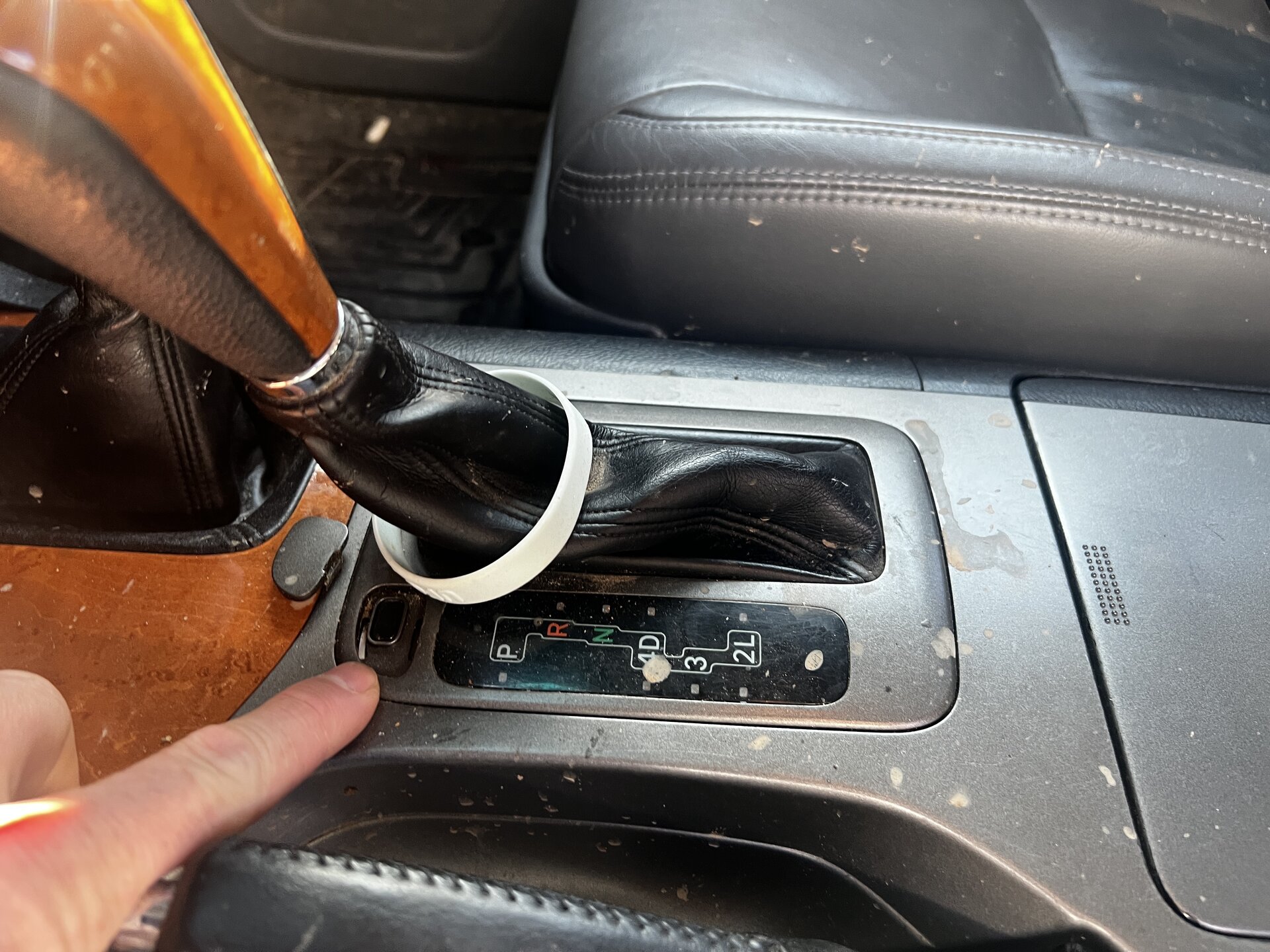

Tow truck drivers are usually hyper aware of their liability for vehicle damage and have work arounds like putting your wheels on dollies, or jimmying the window and using the neutral override button near the shifter (allows them to put vehicle into neutral without key) it’s beneath the little dime-sized plastic cap.
I had no idea what that button was. Thank you! Will give it a test this weekend out of pure curiosity.
