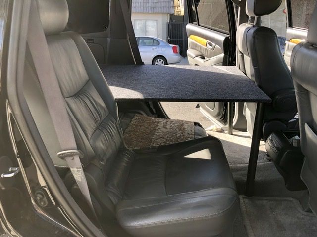

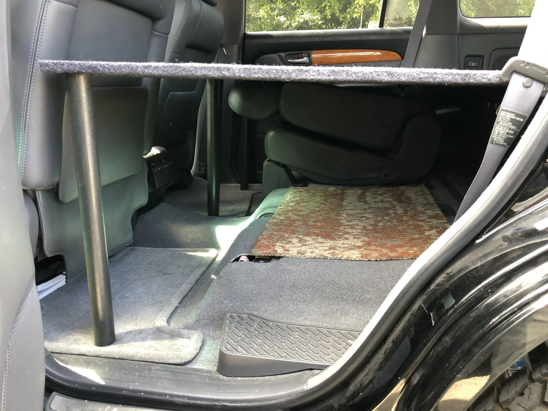

I finally had the seat up and remembered, here you go.
wow... just wow

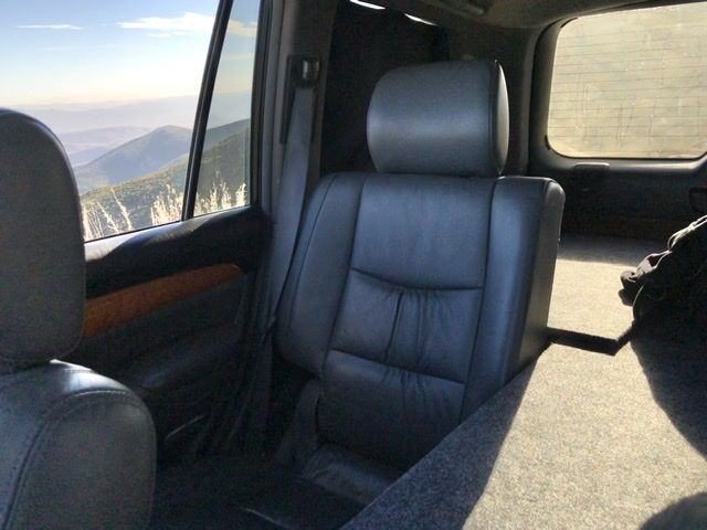

can you snap some pics with the seat up?

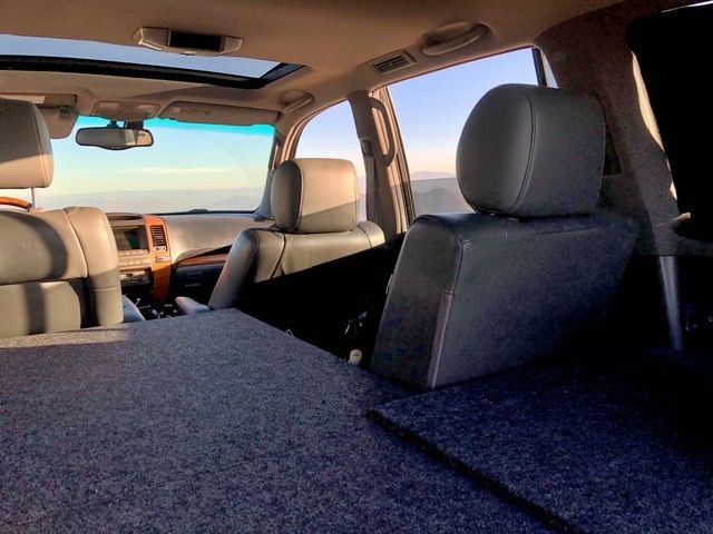

Very happy to finally have finished my storage system/sleeping platform and wanted to share it. Ended up being more challenging then I thought, but was definitely a rewarding experience. I spent weeks looking up other people’s designs and ultimately decided to do a system somewhat similar to driftas. 1/2” Baltic birch, UHMW slides. For the bed extension, I used hangar bolts in rounded wood poles (used 1.5” closet pole), inserted into tee nuts. This makes them easily removable for storage. The larger extension seems sturdy enough but I may add one more leg in the middle just to have more support. Bed extensions are secured via L braces that slot into a wooden bracket I attached to the back of the drawer box. Rear seats remain functional, and can be used independently, though I opted to leave the left ones out to gain much more storage underneath. Total top platform length is 72.5”. Purposely made it this length so I can with the bed setup and have the drivers seat fully pushed back, though you definitely could make it considerably longer if leaving the bed setup when driving isn’t important to you. Overall very happy with how it came out. View attachment 2473271View attachment 2473272View attachment 2473273View attachment 2473274

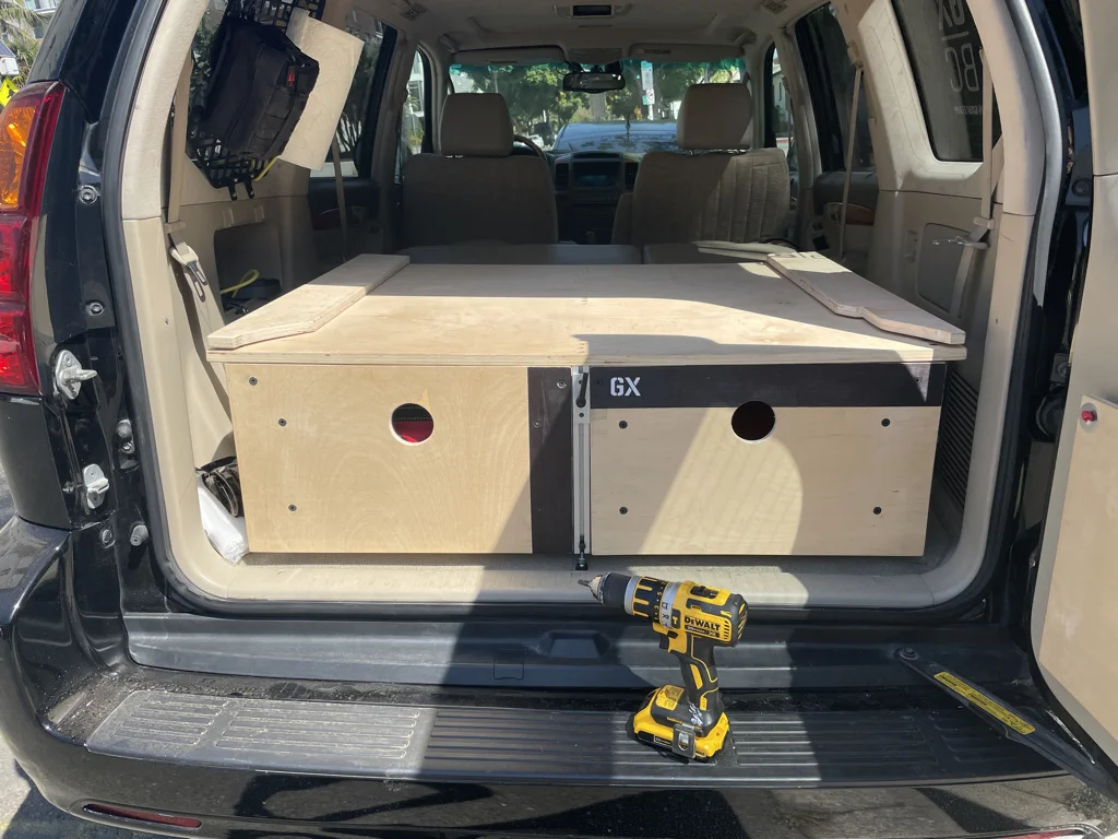

What’s the dimensions of the drawers and the 3 up rights used to support the box, I know I’ll need at least 3- 4’x4’ pieces of plywood for that the top and bottom of the box, and then for the additional piece to cover the rear seats
The overall box is 41.75” wide x 36” deep x 12.2” tall. If using 1/2” ply, then the up rights would be about 35.5” x 11.2” (taking into account the back support piece and the top and bottom piece). Numbers are approx though as 1/2” plywood isn’t exactly 1/2”. The exact drawer dimensions really depend on the exact dimensions of the plywood thickness and UHMW thickness. I’d recommend making the drawers slightly less narrow and tall than the box opening so they’ll for slide well. I tried cutting it too close with my measurements and cuts and ended up having to sand them down slightly smaller to get them slide smoothly.

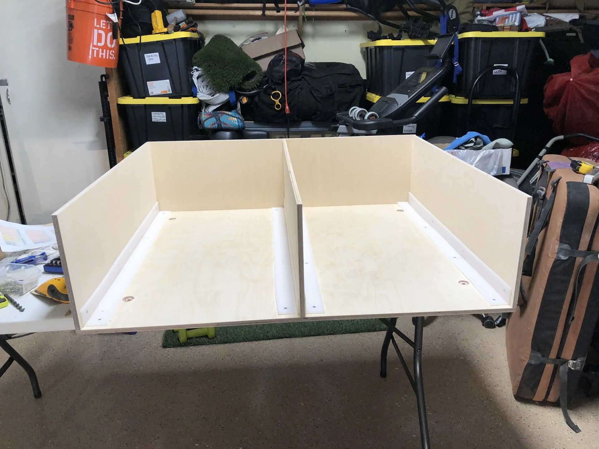

Would you mind taking a picture of how you used the UHMW as slides? And where you sourced the UHMW?
Here’s a photo of where I put them. I then used a countersink drill bit and screwed them down so the screws didn’t stick above the plastic surface. Glue won’t work on it. I got a sheet from a local plastic supplier and then cut it into strips.
That's what I was assuming you did, just wanted to verify. Thanks

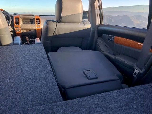

I’m looking into getting a gx470 and have some questions about platform. I’m 6’3” and me and my wife would be sleeping in it , do you think I could fit with seats pushed up? Do you know the measurements of the seats when pushed up?

Thanks! It’s for sure well over 6’3” with the seats pushed forward. I leave my driver seat all the way back with the bed platform setup and my total platform length is 6’ 1/2”. In addition, I could’ve made my drawer box longer by 1-2” as well but I left room for my fold down table on the rear door.

@psilocyBen apologies for reviving your old thread I'm just curious - did you do a plywood "baseplate" as well or does the drawer box pictured above bolt directly into the rear tie-down holes^? I see there that they're countersunk but I couldn't see in any of your pics if there was an additional plywood layer below the box. I originally thought this would be necessary to get the box high enough so the drawers could slide out but now I'm not so sure. TIA!
No extra baseplate was needed. I just bolted the box directly to the frame. There’s enough height clearance for the drawers to come out even with just 1/2” plywood.
