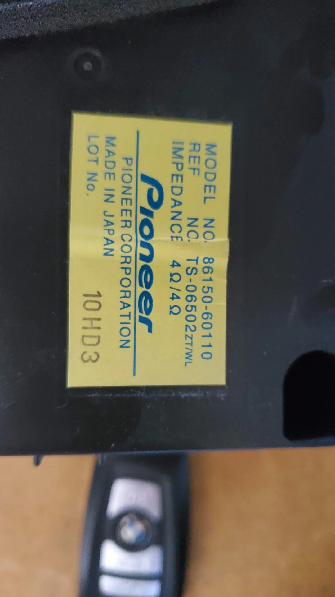

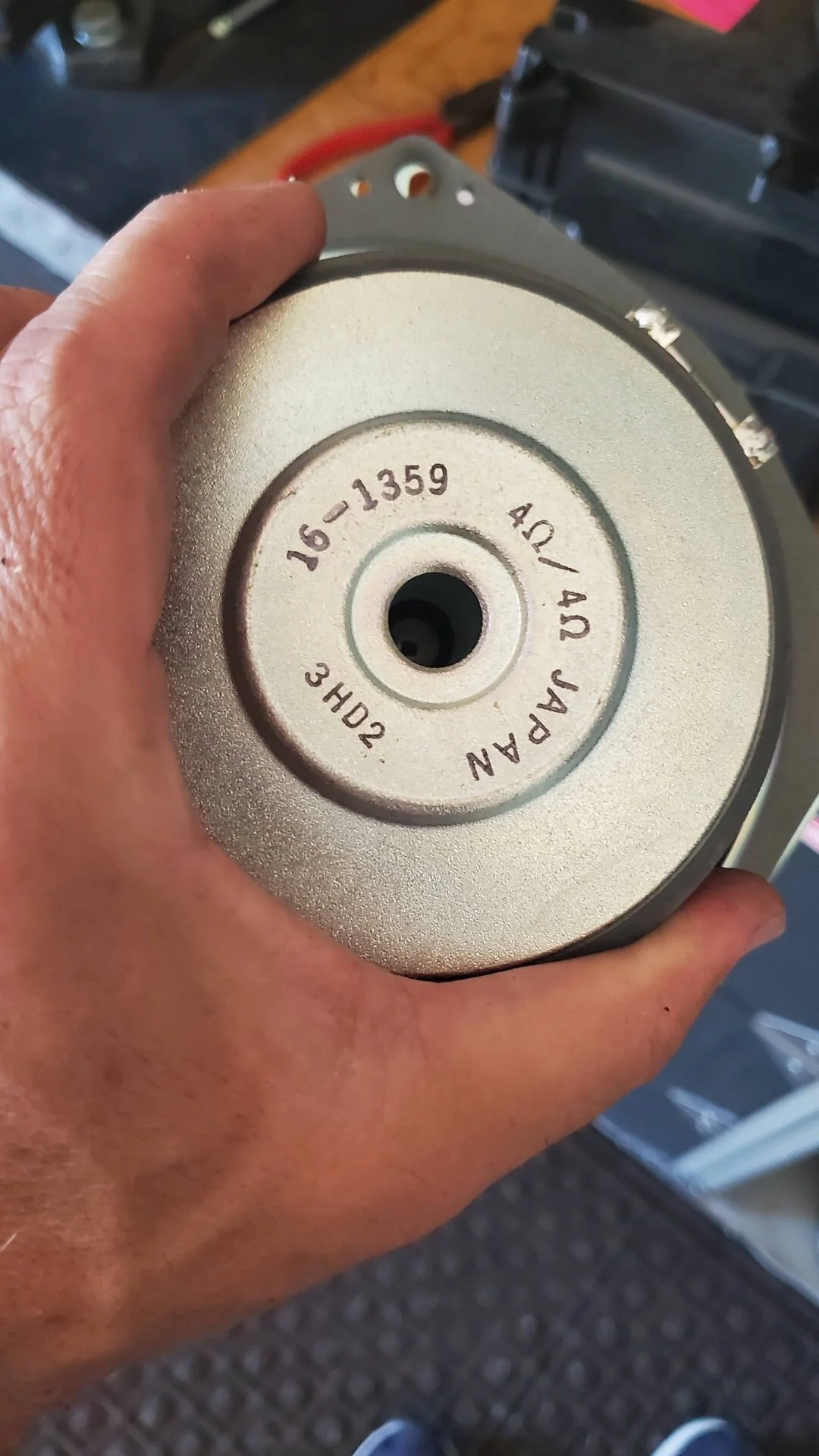

I can confirm the non-ML GX speakers are 4-ohm (all the drivers I pulled out had "4-ohm" stamped on the magnets). I've replaced the front and rear door speakers and the subwoofer but did NOT replace the front tweeters and small mid components as those seemed fine (to my ears).

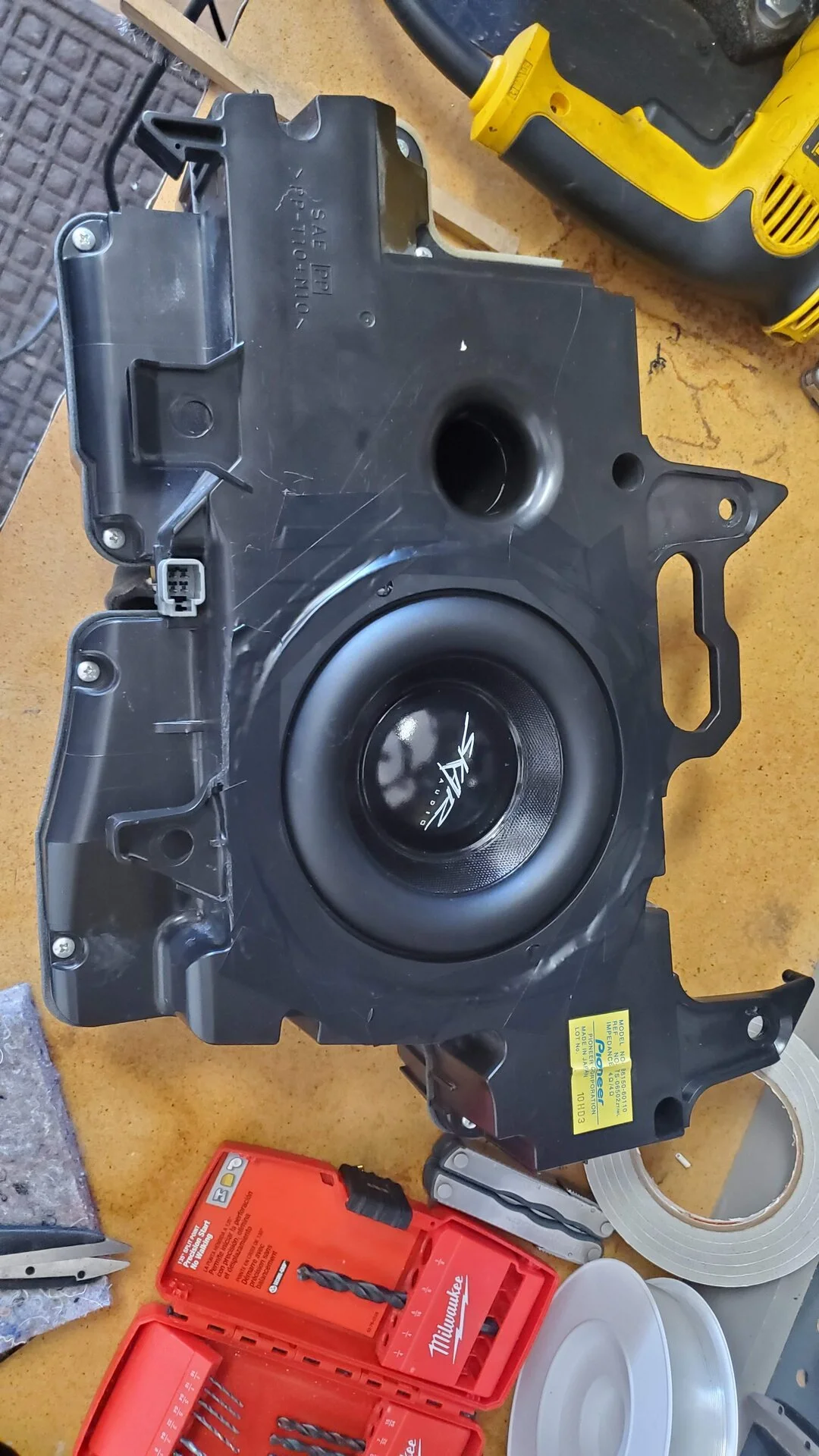

The factory sub is bi-wired so I just ran the existing dual leads over to the dual terminals on the new sub linked above. Easy-Peesy....
The leads aren't very long and I didn't have larger spades to accommodate the new sub's terminals so I soldered the wiring, FYI.

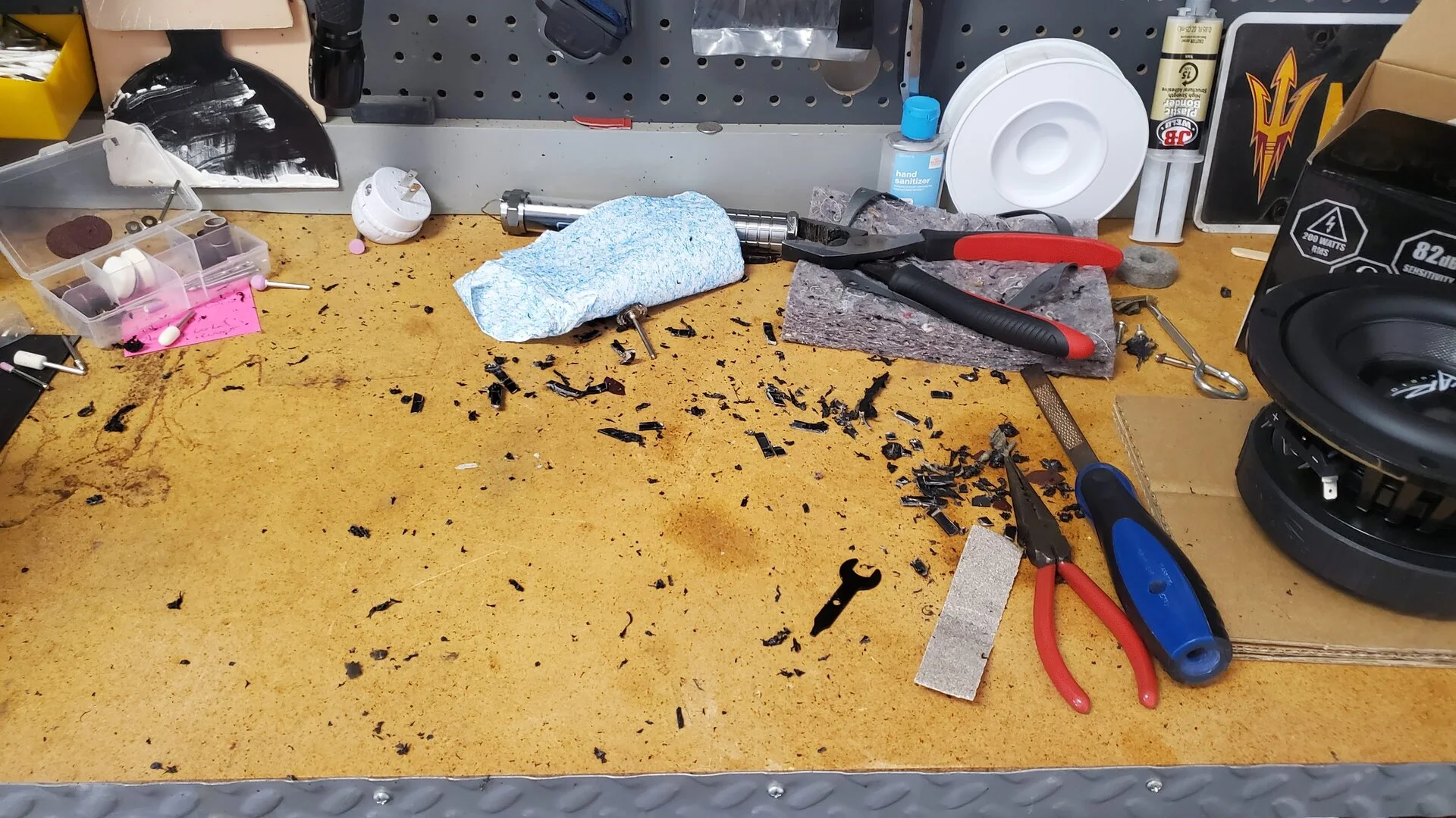

Edit - there's also some structural plastic ribs inside the sub's enclosure. The new SKAR subwoofer is deeper than the factory one so those ribs had to be removed with pliers in order to get a flush fit (just nipped it all out and that went really well). My initial re-install of the subwoofer revealed quite a bit of rattling - took the entire sub enclosure apart and had to meticulously vacuum/clean the interior of that enclosure out to get ALL of the loose plastic pieces removed.

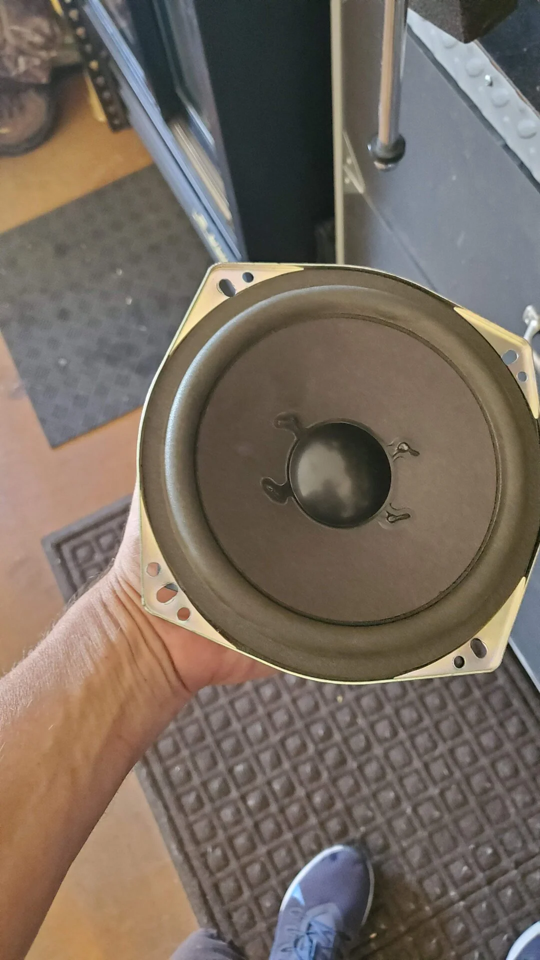

No exaggerating here, this entire project took me hours to complete and I did it in piecemeal fashion (doors first on a solo trip to my cabin last year, subwoofer a few weeks later). It's not hard, it's just a ton of tiny steps to get the job done (rear doors were plug-n-play-ish aside from also soldering those, all others were definitely NOT plug-n-play). Not trying to dissuade you from doing this but to your earlier question.......if I had to do it all over again, I would NOT have replaced my subwoofer. The front 6x9's and the rear door mid-woofers were all blown (foam surrounds completely shot) but by the time I got to the subwoofer, that driver was 100% intact and I can't honestly say I notice any difference with the sub replacement. The front 6x9's produce a great amount of balanced output including low-end bass so I don't think the subwoofer netted me anything other than being able to share that tale with you here.

Stumbled across these - pure happenstance but.....looks like I took pics when I did my subwoofer retrofit so here they are:
Sorry for the giant pics....last one is the finished product.
You can see in the previous post that the sub driver was in perfect shape. Again, looking back, I would NOT recommend replacing the subwoofer unless you know yours is shot and even then, it's probably worth being patient and just replacing the foam from with a kit from Simply Speakers for this particular piece. I honestly can't tell you this new one sounds any better than the old one did and this was a lot of work.
