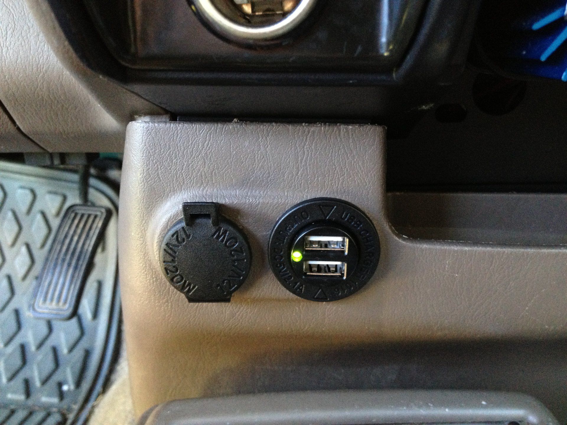

I put Sea Blue double USB in my Tacoma. Nearly a perfect fit and the harness for the cig lighter fit it after splitting the plastic harness.
I know it’s not exactly the same, but it is a Yota.
