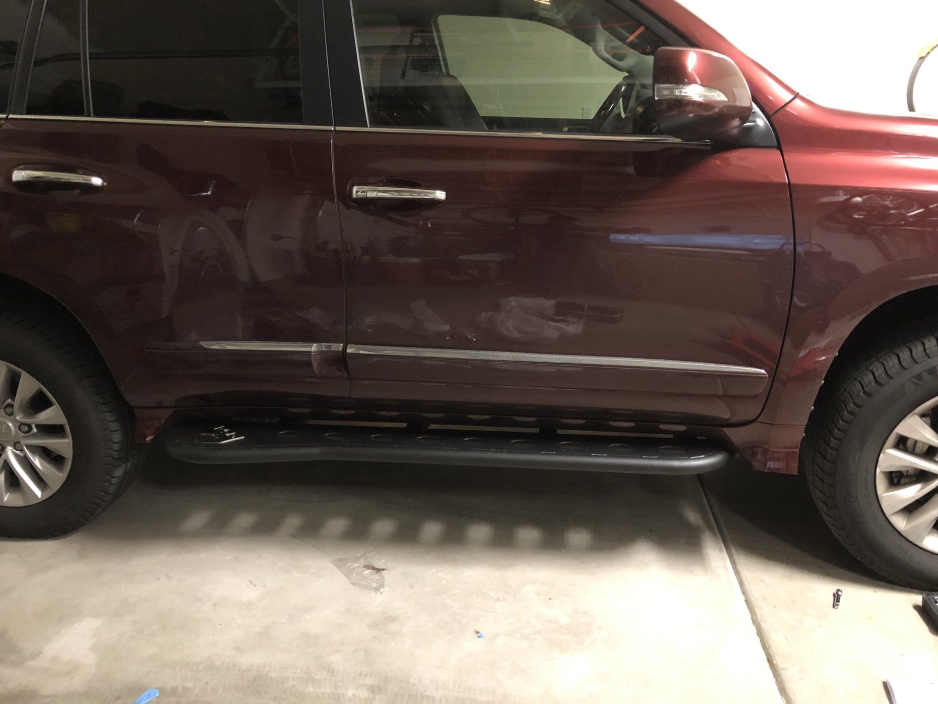

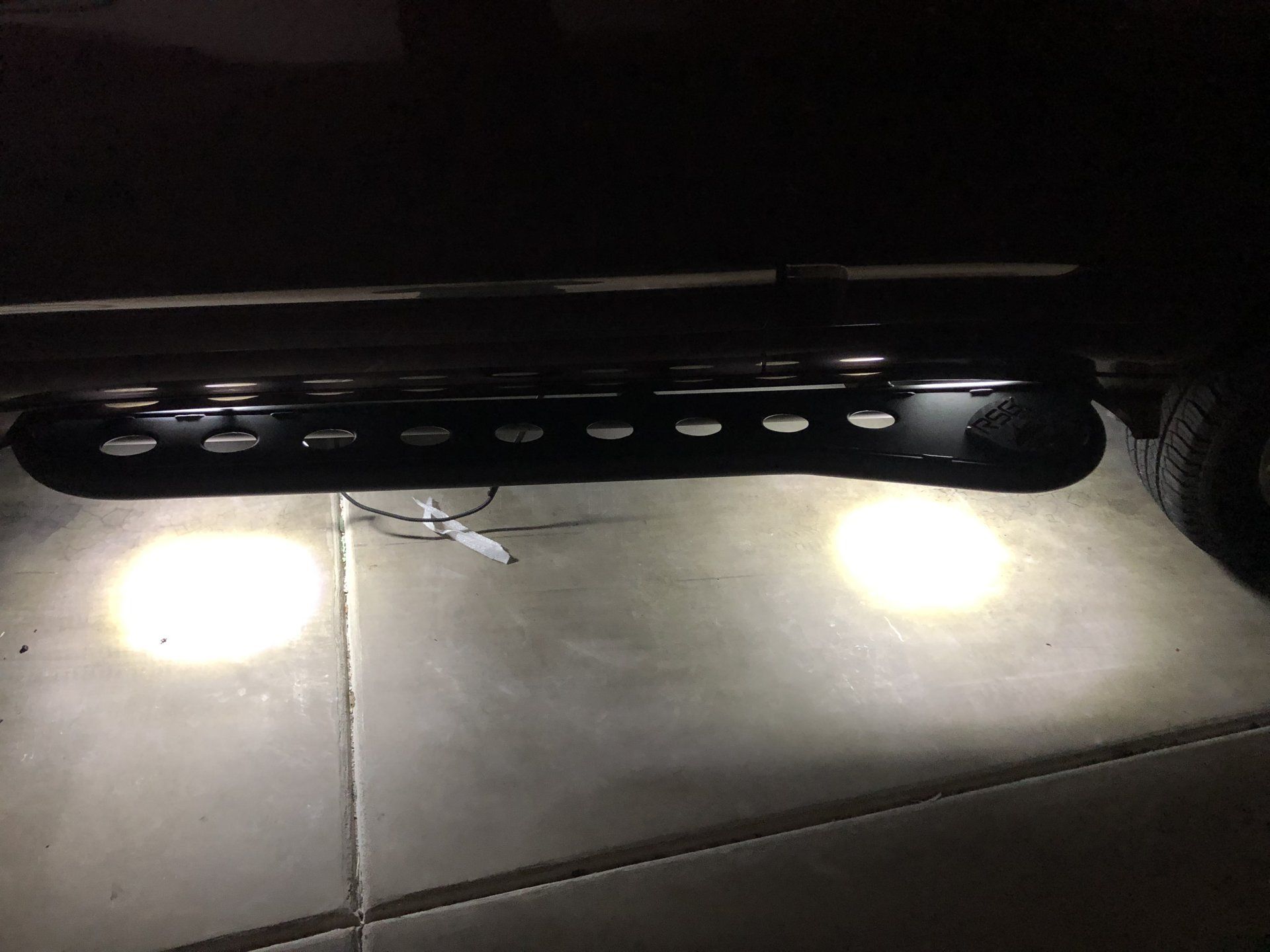

So it to much longer than anticipated but life happens. Anyhow I finally got around install my sliders on both sides and so far quite happy with them. Got the flat version from RSG for the GX with the kick out, thanks to the kickout the rear step is huge! Both the wife and my son love it because the rear step was less than useful from the factory. I only manage to rig the puddle light on one side though thanks to my stulidity of messing up the factory light harness. Anyone has an extra one?
View attachment 1918863View attachment 1918864View attachment 1918865
Where did you mount your puddle lights to after installing the sliders? I bought some Amazon LED puddle lights that I plan to wire into the factory harness but I am not sure of where I should mount them. Any pics, advice, suggestions would be much appreciated.
I suggest amazon rock lights, I tried some LED off-road lights and they died quickly. my guess is the dimming killed them. On the cheap rock lights I enlarged the mounting hole a little and reused factory mounting bolts for the factory running board, you will have 6 total and I used the front and rear 4 holes.
