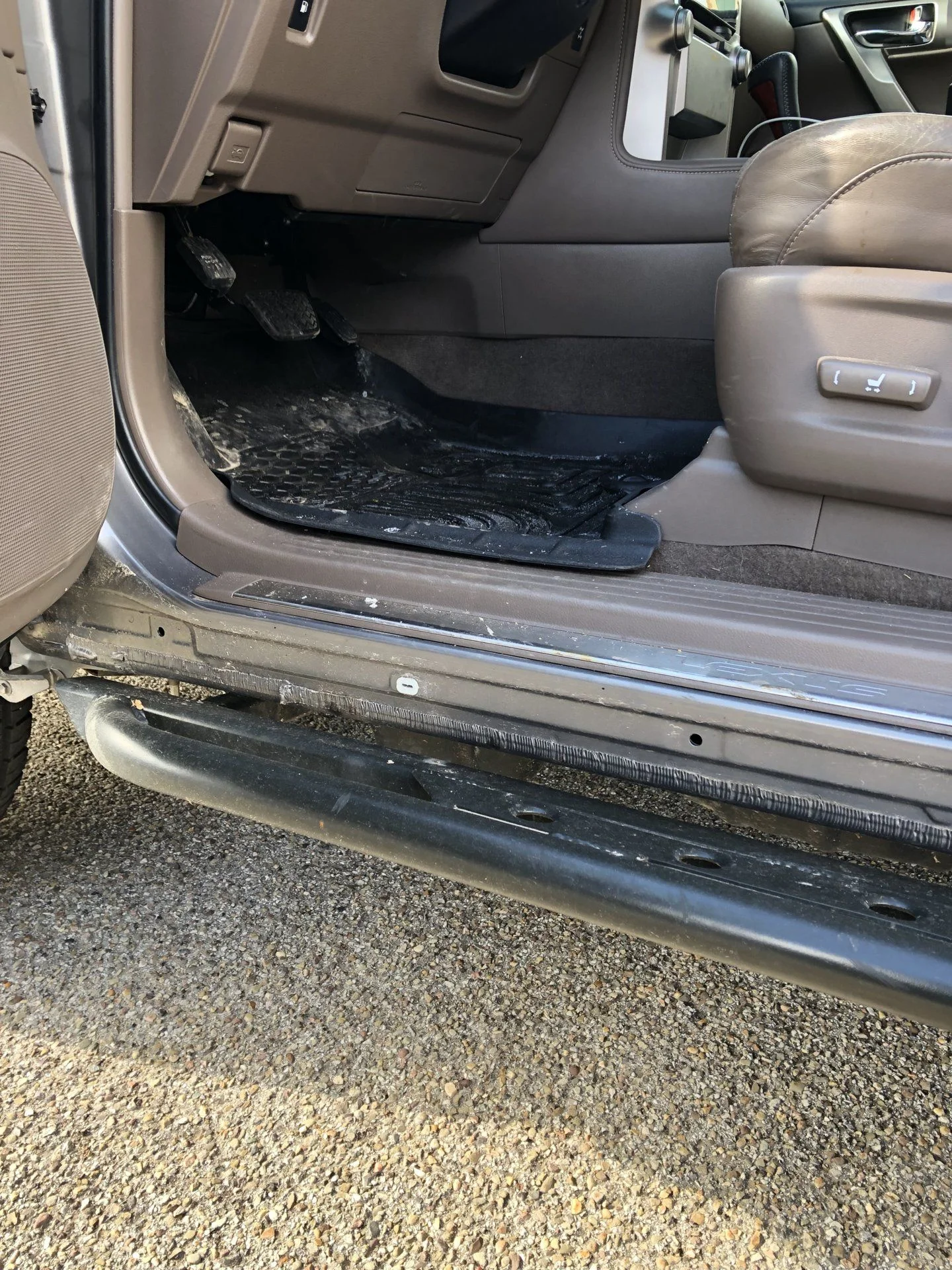

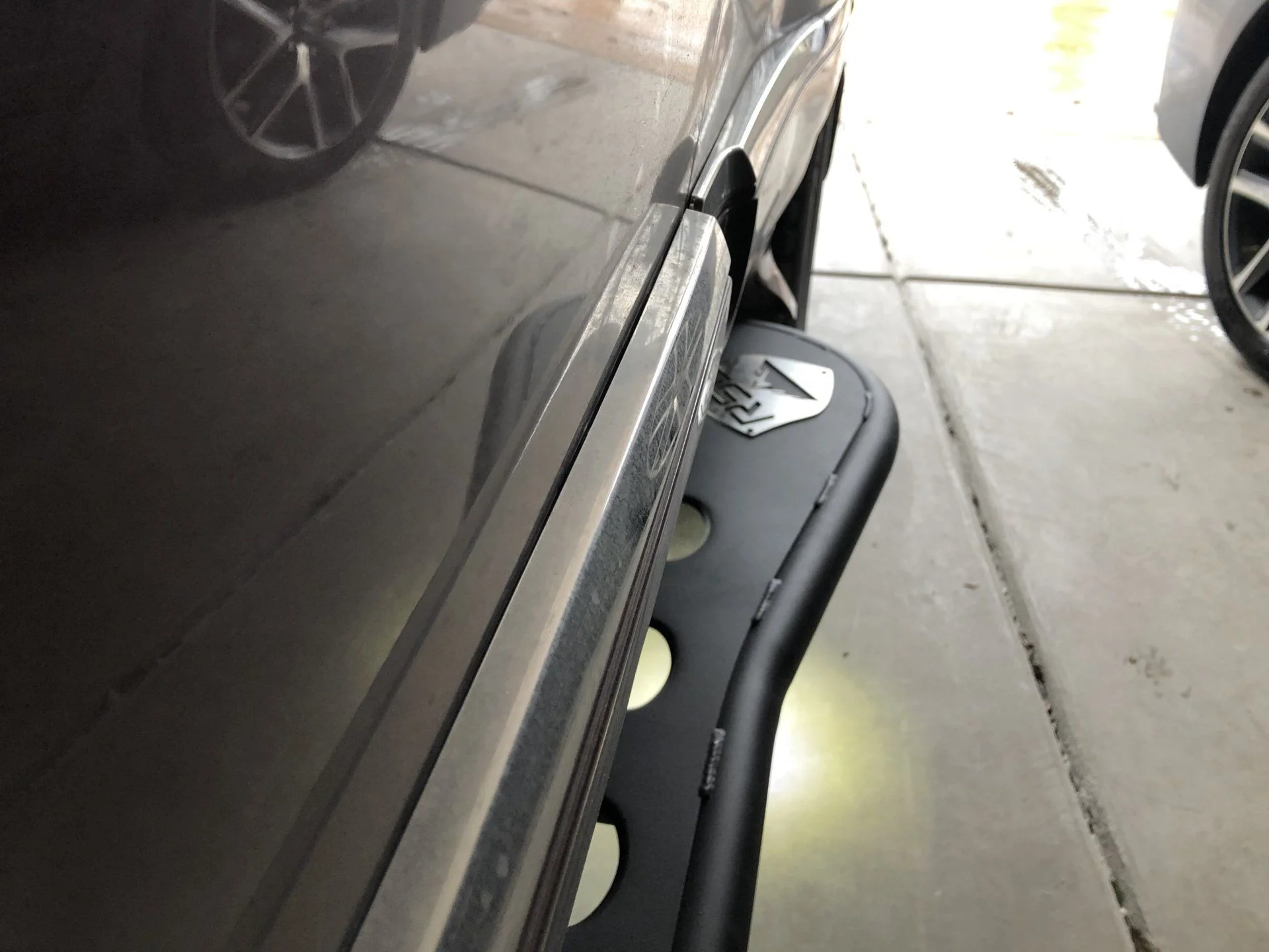

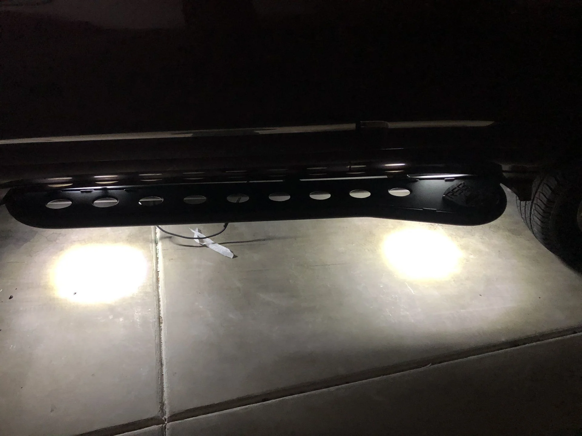

I managed to do the passenger side only. Yes removal is quite easy. I decided to cut the siding because the sliders look really short without it. Cutting is quite easy also, I’ll do a little bit of write up when I get some time.
They look nice! How wide do they stick out? Can you at least get the ball of your foot over the tubing when you're standing on them?
I can only get a toe hold on mine. When you're taking care of something on the roof rack, it gets tiring real quick when supporting all your weight with just your toes. Much easier if one is on the ball of the foot. I may be swapping mine out for wider ones in the future.

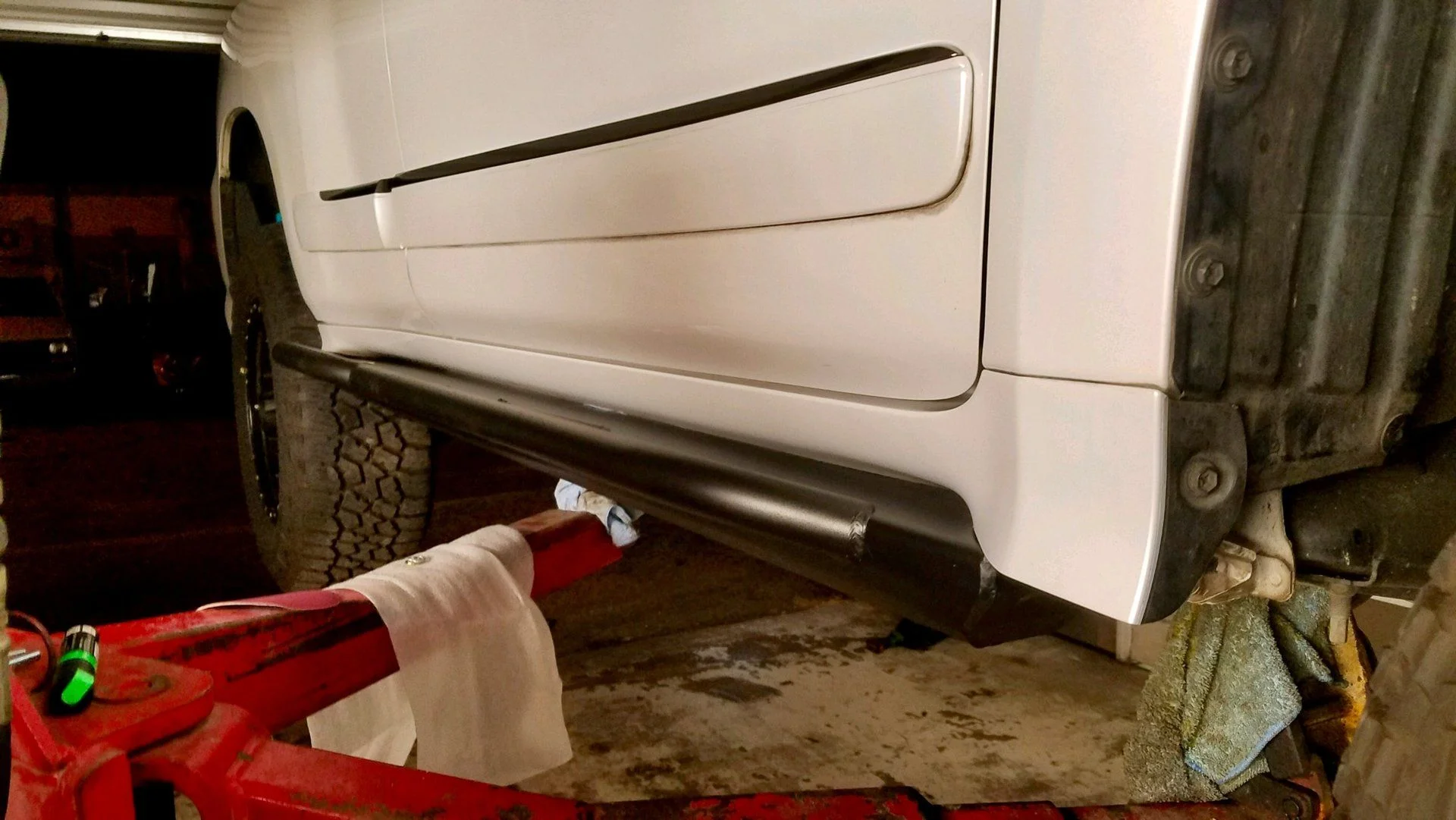

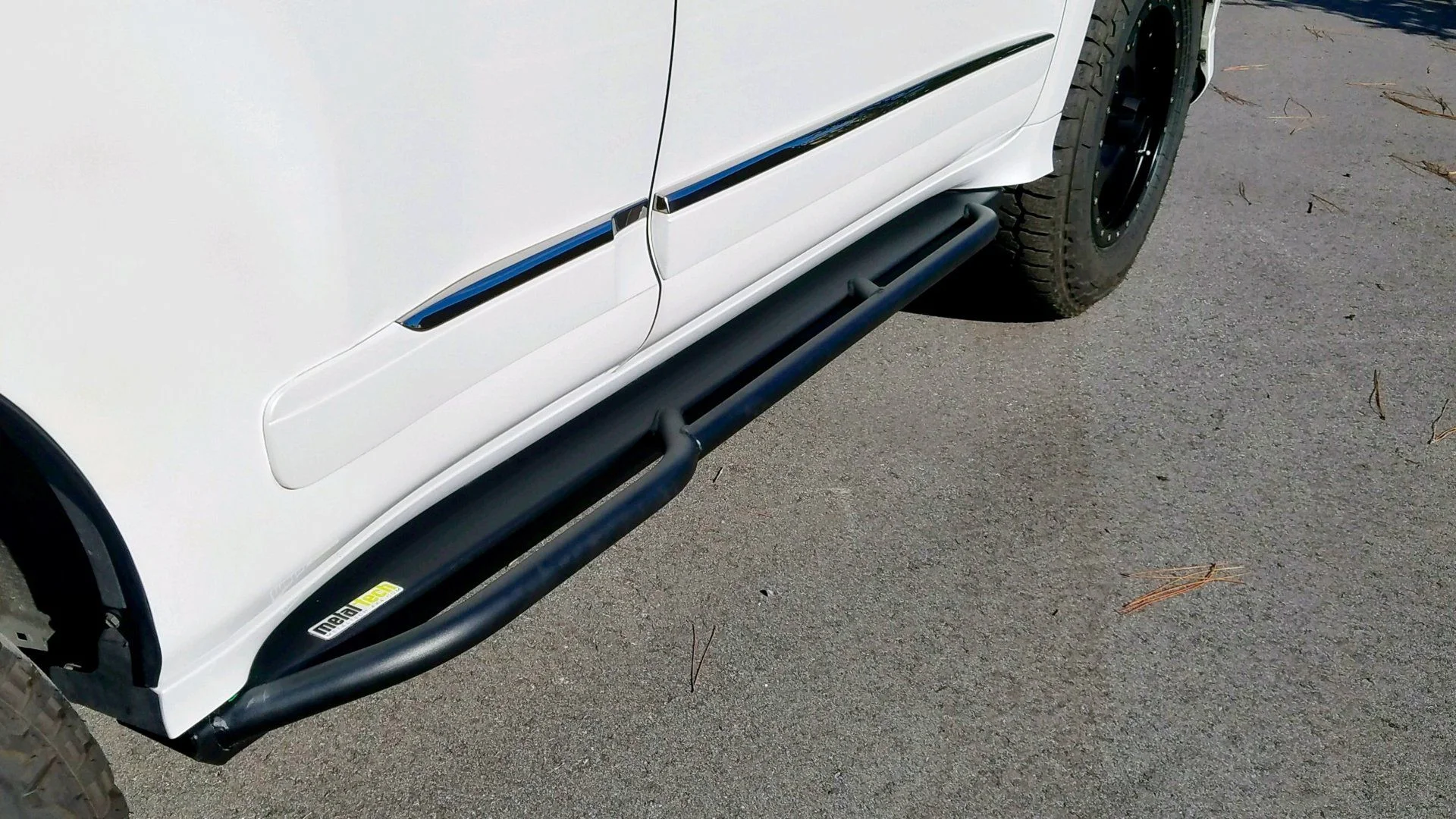

So it to much longer than anticipated but life happens. Anyhow I finally got around install my sliders on both sides and so far quite happy with them. Got the flat version from RSG for the GX with the kick out, thanks to the kickout the rear step is huge! Both the wife and my son love it because the rear step was less than useful from the factory. I only manage to rig the puddle light on one side though thanks to my stulidity of messing up the factory light harness. Anyone has an extra one?
1918863
1918864
1918865
As far as write up goes it was easier than I thought or much easier compare to installing my sliders on the 80.

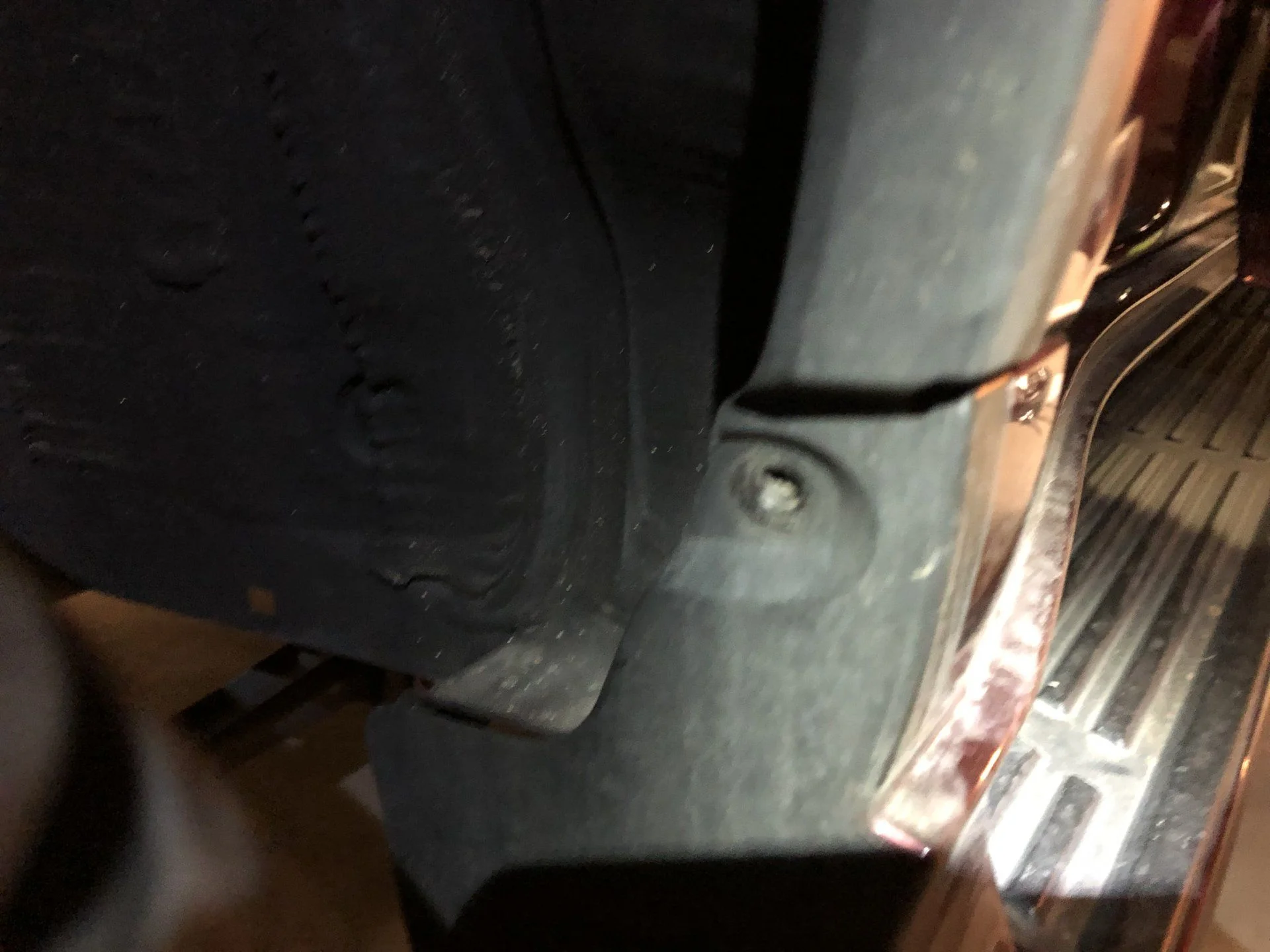

1. Factory steps are pretty easy to remove.
Few bolts/screws on the wheel well
6 bolts on the step arms attached to the body
2 screws in the trim and everything would just pop off with a plastic trim tool
Passenger side is really easy! Remove the bolt for the hand brake line and the sliders would just bolt right up. My sliders came with longer bolt for the hand brake mount.
Drivers size has a couple of more steps.
  1. Remove all bolts from the KDDS and what looks like hand brake lines
  2. Remove front KDDS line shield. The shield needs 3/4 inch of material removed with an angle grinder so it will clear the slider mounting plate
  3. Pull all lines away from frame and slide the slider mounting plate behind all the lines and bolt everything down
  4. Reinstall modified shield
Sont forget to disconnect the puddle light!
Cutting is also very easy with an angle grinder with cutting wheel.
