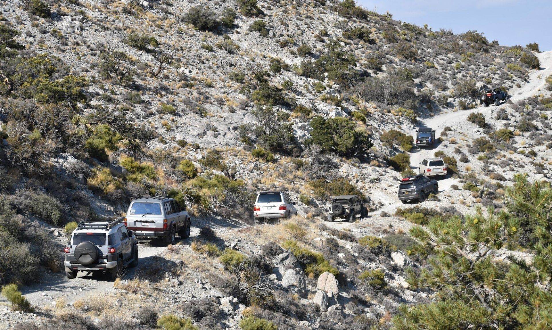

What trail were you all doing? I was just up there a couple of weeks ago.
There were 10 rigs in the group and we covered a few trails. We spent most of the day on 3N11 ,3N17, 3N83, 3N08. We headed over to Cactus Flats OHV via Cactus Rd to get to our final destination Horsethief Flat 3N03A.

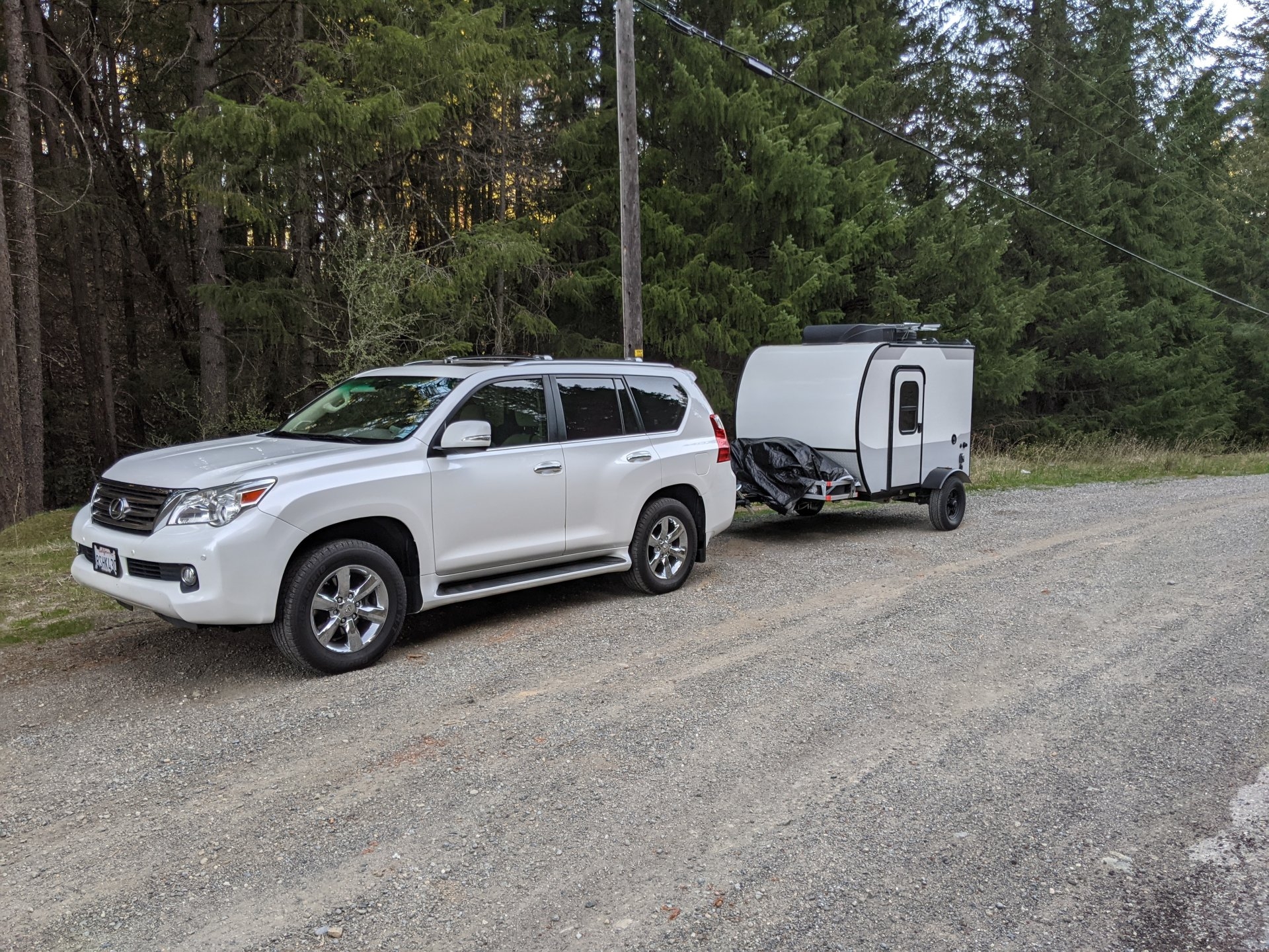

Question... my brakes shudder going down hills intermittently on the GX 460 ... either its normal for these or its may be like trying to catch a fart in the wind ,Ha ! I'm thinking pads after they heat up, I know it shouldn't be the rotors , cause if it was it would be always instead of sometimes... Any Ideas ?
460 with stock size tires, wheels
And not necessarily with the camper on it ... its still will shudder every once in awhile
it has 132k on it ... and runs perfectly other than the sometimes brake shudder...

I’d get the rotors and brakes checked by a professional. My dad had to get his LC 200 rotors resurfaced at 85k. If you haven’t had this done it’s time for a check and maybe new rotors. What’s your brake maintenance history? Running stock pads and rotors?

You might get better info if you start a separate thread. Having said that, what is the location history of the truck? Several folks on Club Lexus forum having trouble with caliper pins corroding and binding. How mechanical inclined are you? Willing to jack up the truck, pull the wheels and see what's going on? Intermittent shudder isn't normal on any car.

Mine did the same thing. I switch the rotors out with some slotted ones and got new brake pads and no longer have this issue.
I have the same problem. I've resurfaced my rotors once already and it eventually came back. Sometimes they shudder more than others and I only have 80k on it AND (as mentioned earlier) that's with already having resurfaced my rotors!
Can't afford to now, but I'm looking at those aftermarket pads and rotors from Amazon that we all were discussing on that brakes thread.
Ok I'll replace the rotors / pads if it gets more frequent. I've owned this since Jan. this year and its our luxury cruiser... rides as smooth as butter, well in comparison to our 96 LX450 ( 80 series ) ...
Thanks for your input !

This 460 came from Dallas... I'll get the rotors probably replaced / new pads... I'm mechanically inclined, but I'm also retired, so someone else will be fixing it ... ha
Rotors are normally too cheap to turn these days. Take care on break in . It sure makes a difference. I have had very good luck with eBay rotors with holes on several vehicles.
