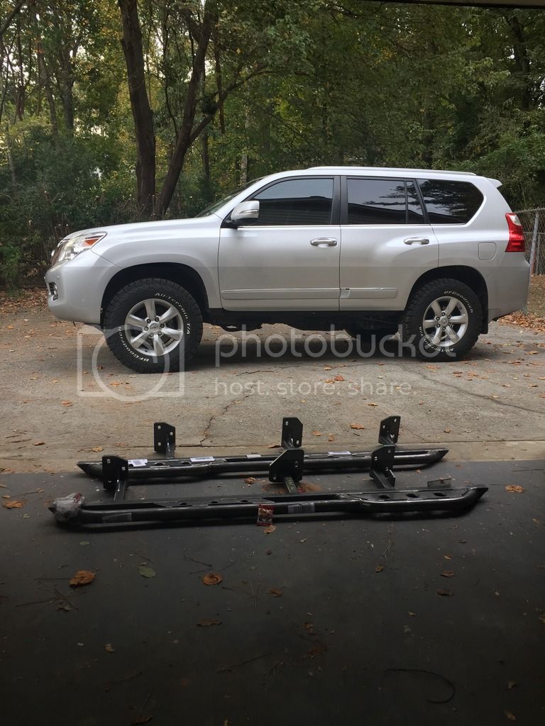

2011 gx
Did a lot of research on this exact issue. Ended up going with 265/65/18. Faulken wildpeak at3. Great tire. No noise. Great stance. Fits great. The guys at the tire store were impressed how good they turned out.
