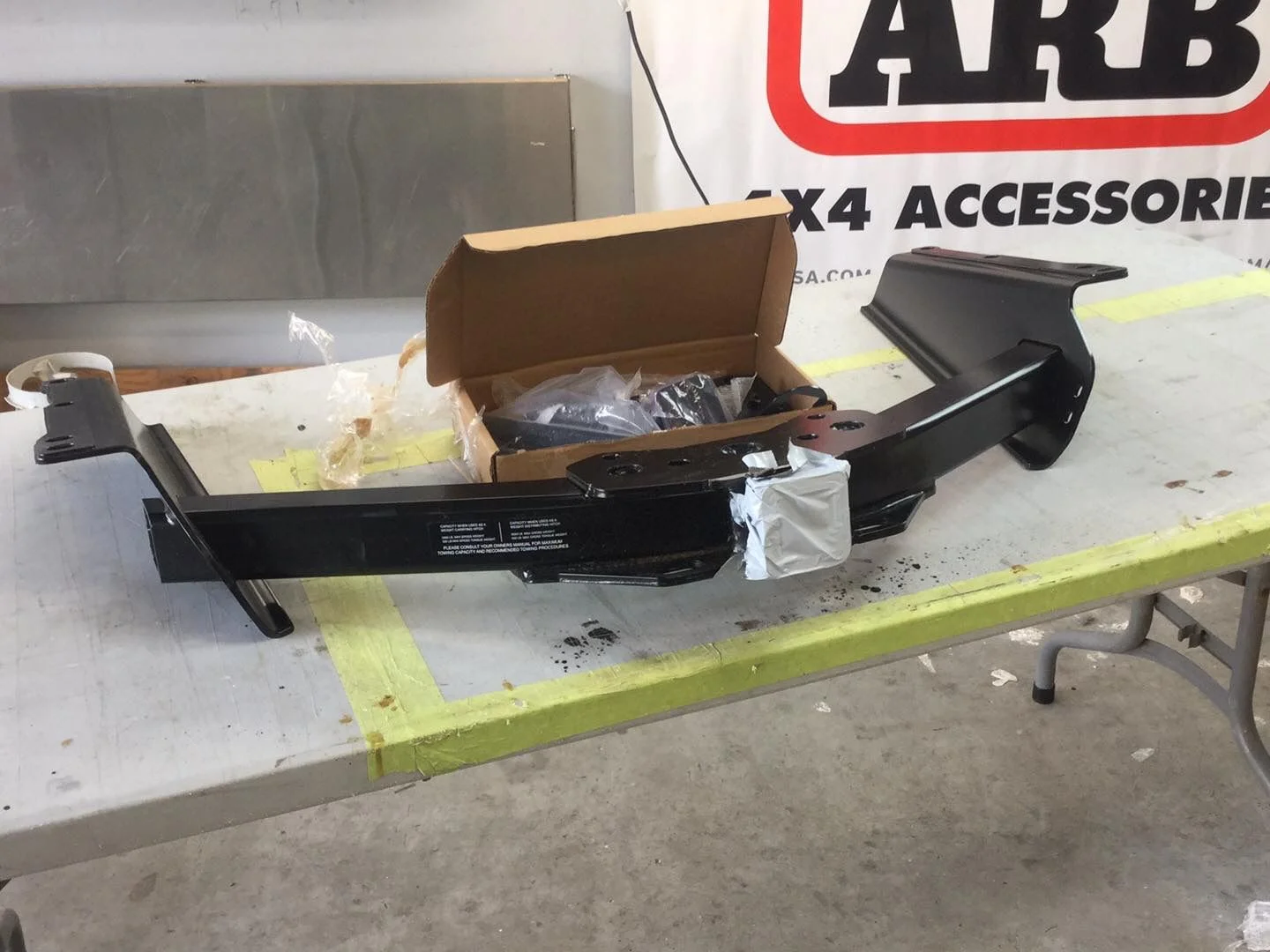

Pretty quick shipping on that factory receiver mine is suppose to arrive tomorrow. Ordered a week ago, Lexus dealer out of Phoenix area. Comes with mounting hardware.

This is a factory hitch rated to GX towing capacity. Much safer for recovery.

specs say lower receiver rated for 10K........

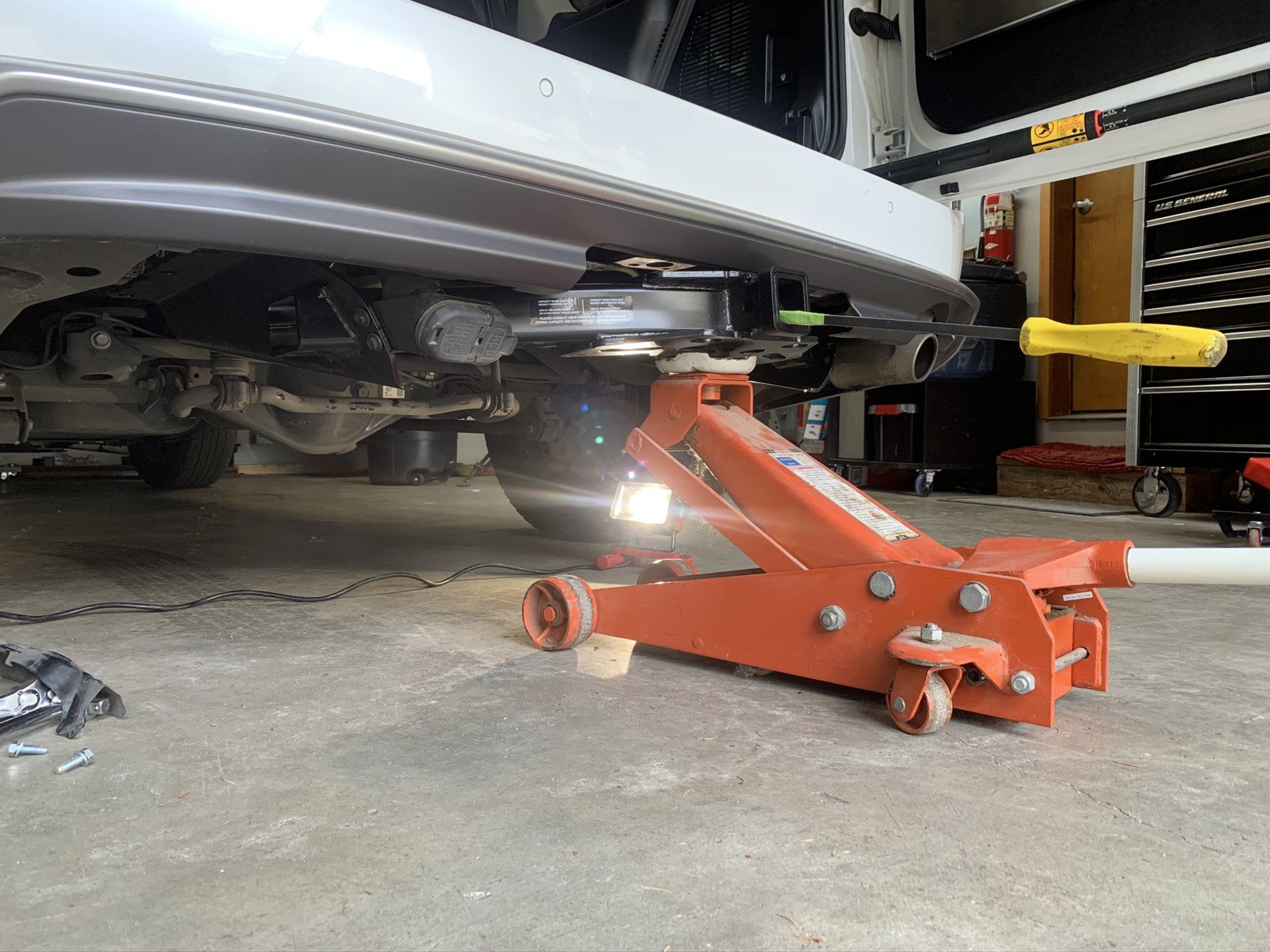

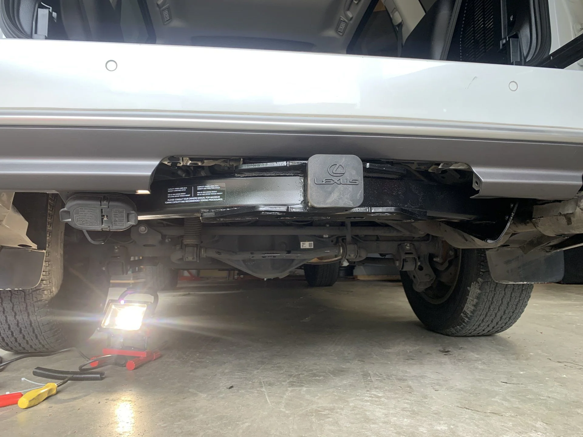

Factory hitch arrived today. Purchased mainly as a recovery point but will see occasional light towing.
I guess the new Class IV hitch provides a spot to relocate the trailer wiring hookups lower?
I hate that Lexus calls it a class 4 hitch. With a max tongue weight of 600lbs (650lbs with weight distribution bars) it's not even capable of the max of a class 3.
It’s the best available option for towing to the vehicles capacity and is a far superior recovery point compared to those 4 bolt 5k options.
