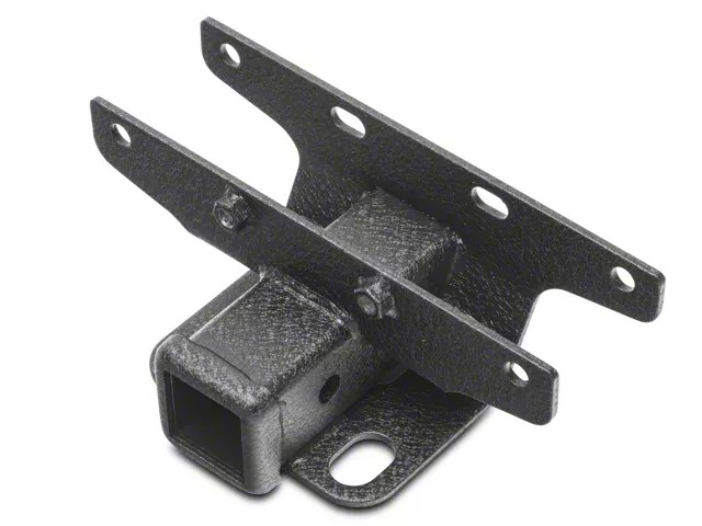

Are you thinking like a hitch which uses 4 bolts and nuts in a rectangular pattern, and which go horizontally through the rear frame member? This one is from a JLU, for reference:

I'm thinking maybe some aren't aware that there even is a provision for the pintle. Here is an image of the proper hitch and a similar hitch on a Prado. Since the GX is made at Tahara like the rest of the cruisers, all I want to know is if the US market trucks have the bolt holes. I already have an OEM receiver hitch that I installed.

I guess I've been referring to what I called a "pintle" by the wrong descriptor. I have always thought there was the full hitch that mounts to frame rails, and the "light duty" hitch that mounts to the cross member! and somehow I had associated the smaller hitch with being a pintle. Now that I see your image, I get it. Sorry for muddying the waters with my response.

No worries. Note that your receiver hitch is not matched to the trucks published capacity (with trailer brakes, 6500lbs). There are a lot of hitches on the market that utilize the fastener holes in your picture, and they do work for smaller loads. I negotiated the OEM hitch (PT228-60141)
into the deal when I bought my GX. It spreads the load over to the frame rails and reinforces the back of the truck substantially. Some day, when my GX is older I'll use it more for offroad adventures and may use a pintle setup at that time (better ground clearance). I wonder if the foreign market trucks have a section in the owners manual about the capacities using the pintle.
FWIW I only use it for light utility trailer towing of yard debris, a motorycle, that sort of thing. Also the infrequent recovery / tow using a strap over the pin. Light duty stuff.

You're not wrong. Toyota refers to their light duty hitch that mounts to the cross member as a pintle hitch.
I had one on my 470.
And yes, @Wildcat Walker, NA GXs have the four horizontal mounting points on the rear cross member.
