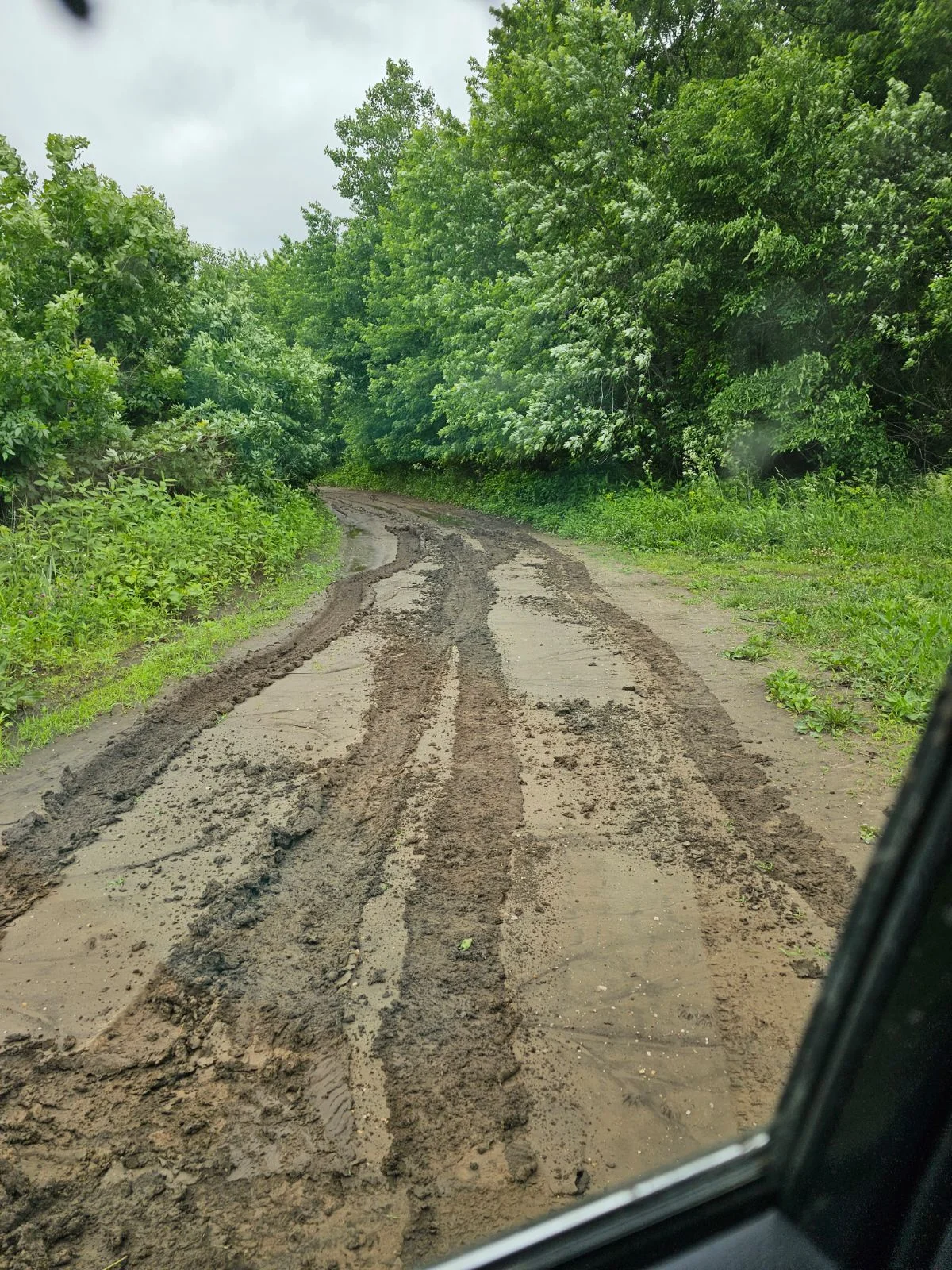

After the MTRs the Revos are amazing..sp smooth and quiet and as long as I avoid trails during rain and within about 24-48 hours after it's fine. I have a short 13% grade I found to play on until I move someplace with more trails and the Revos are fine. 50 lbs a piece for 33s(285/70-17)
That is the mud thats too much for Revos
