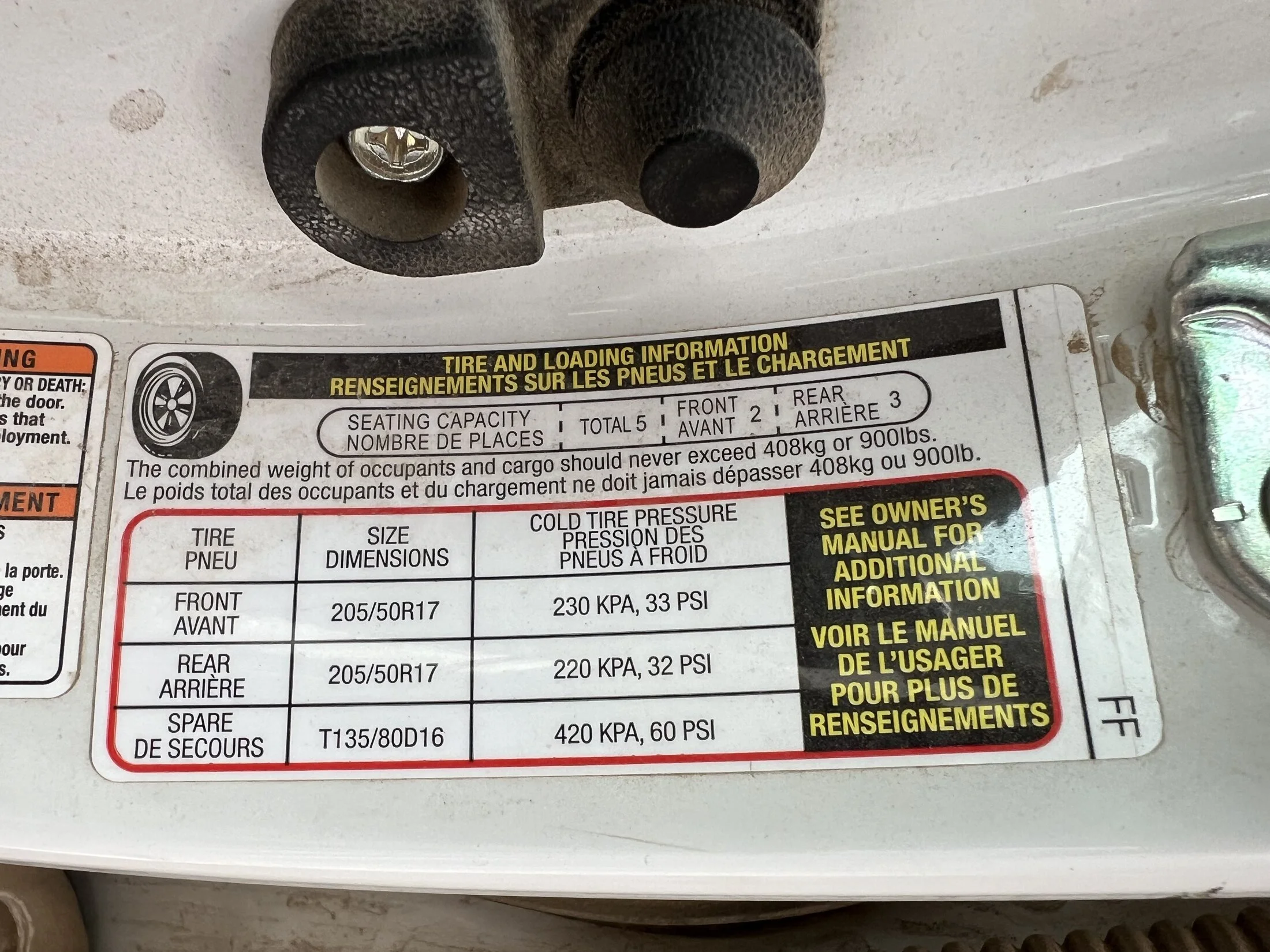

My Subaru Impreza is rated for 900lbs. Maybe I should just overland that?

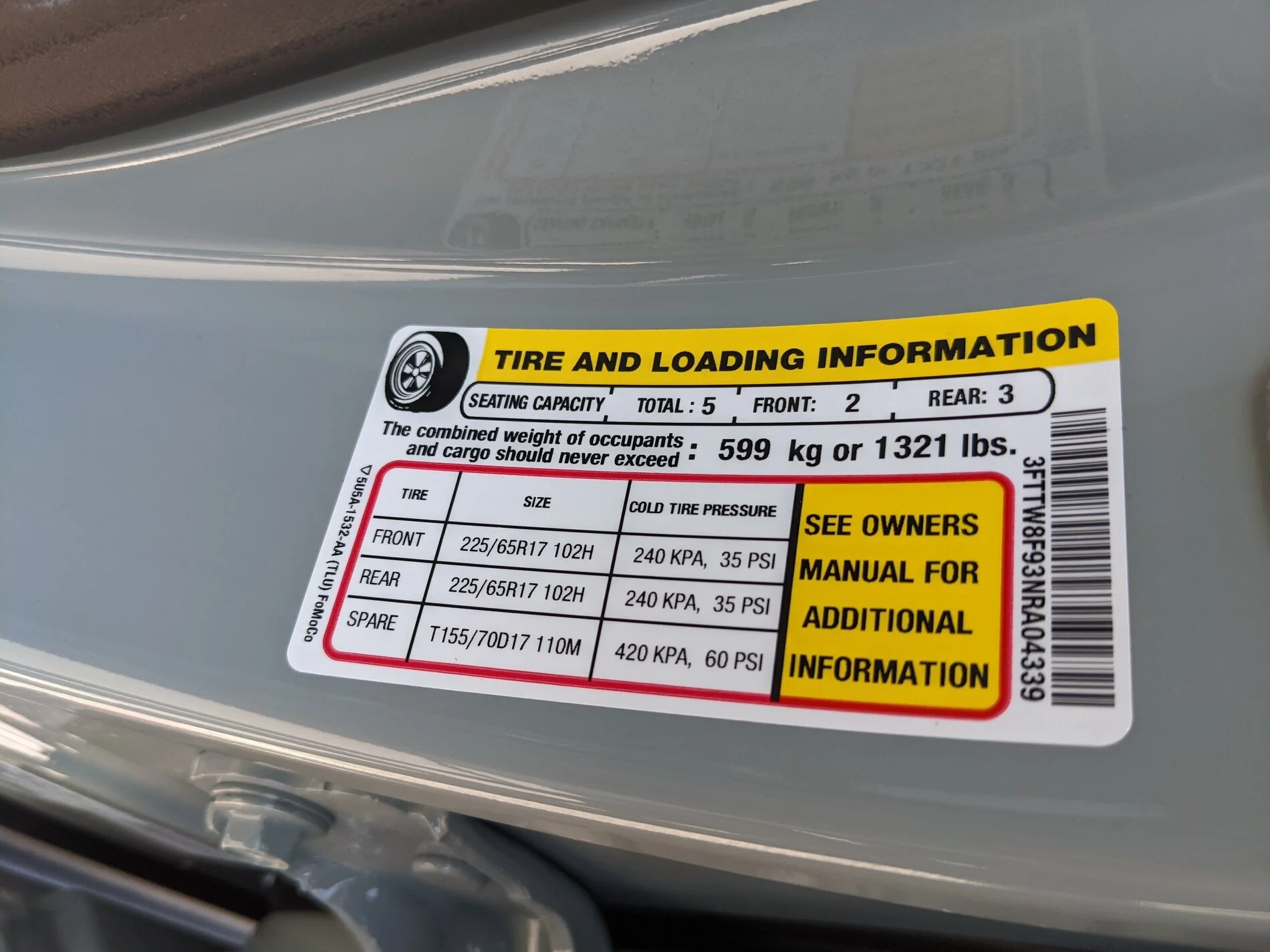

The AWD Ford Maverick beats Land Cruiser 250’s payload, as do a long list of other cars. Toyota used to be good with payload. Now they suck.

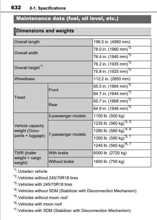

I am confused by the website as well. You could go to a dealer and place a deposit, which is a contract based in part on the data on their website. Hard to rationalize how they can put incorrect data there. To
reinforce the 1100lb theory, here is a page from the owners manual. Of course, maybe the owners

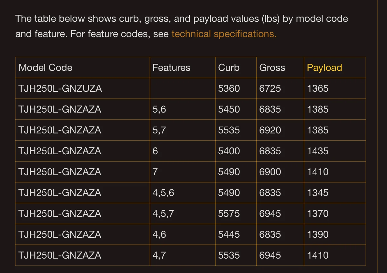

@TWILLY What about the chart you made a while back? Those are pretty acceptable and logical numbers

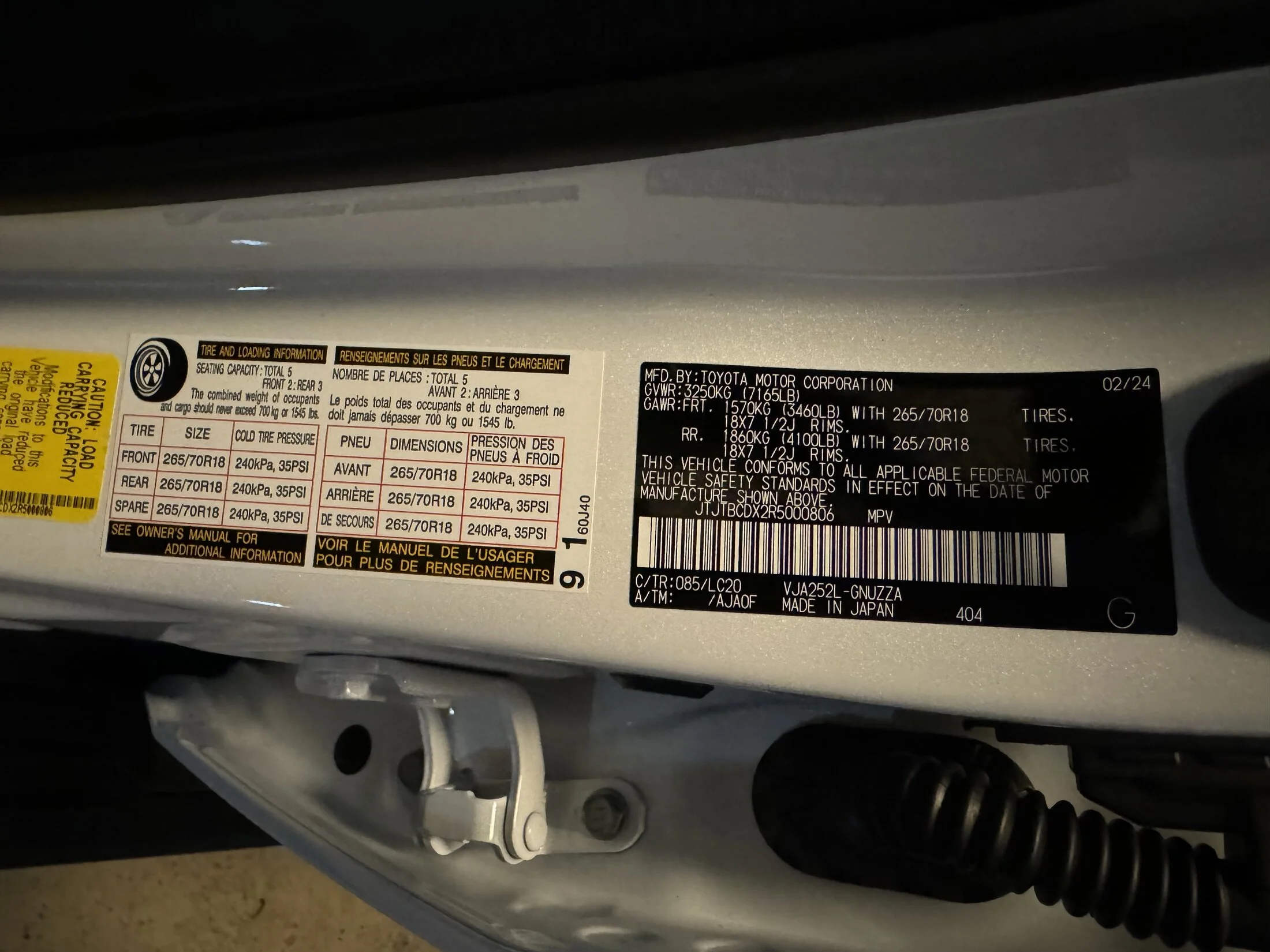

These were derived from the tech specs that were briefly posted on the forum. I felt these were pretty low, at least relative to past US series and my use case. But since then, we’ve also seen door jam placards reportedly from the US first edition showing 1100 lbs. Is that perhaps tolling the tech spec payloads with dealer add-ons? We don’t know. Meanwhile, Toyota’s website continues to show around a 1700 lb payload for the 250, which has (humorously) found its way into media reports.
What we can say for sure is that it’s a total clusterf*ck of a rollout, as the kids would say.
I am not sure fully understand why so angry with this. My LC200 is 1273 lbs after the yellow sticker. That's only 173 lbs difference. Or 13.5%.
Is it really THAT bad ?
Not intended to flame but honestly asking. 🙏🏿🫂
It depends on one’s use case. For me, it’s really not workable. For others, it totally is. Land Cruisers for a long time were the only vehicles available in the US market small and nimble enough to go places jeeps do but with truck-like payloads (1700-1900lbs). Those days are unfortunately (for me) long gone.
what that chart tells me is the landcruiser should have just had the v6tt
What the chart tells me is that these are light duty Land Cruiser Prados. The real Land Cruiser (aka LX600) does have a v6tt.
I use all of the payload on my 80 regularly. And for the record I checked my wife’s outback’s door jam which also indicated 900lbs. Seems to be Subaru’s target number.
