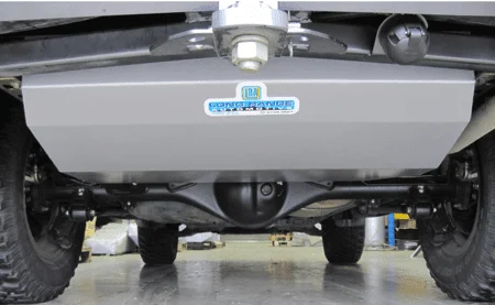

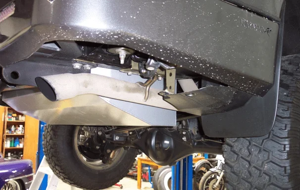

Most of the tanks I've seen that replace spare tires or OEM rear-mounted tanks usually don't hurt your departure angle. As per the pictures, they are lowest right behind the rear axle, and slant up towards the rear bumper. If you draw the angle line, the tank won't interfere.
I suppose this doesn't mean they're immune to trail damage, but for "overlanding" you should be perfectly fine.
Correct. We have the 40 and 42 gallon kits in 80, 100 and 200 Series as well as 30 gallon kits in the FJ Cruiser and have yet to hear of any serious contact from owners. Seems to be a matter of good design (as you have described) plus common sense on the part of the operator.

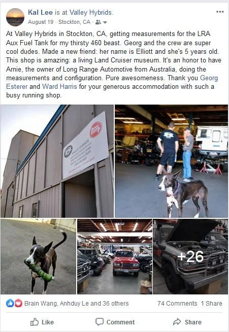

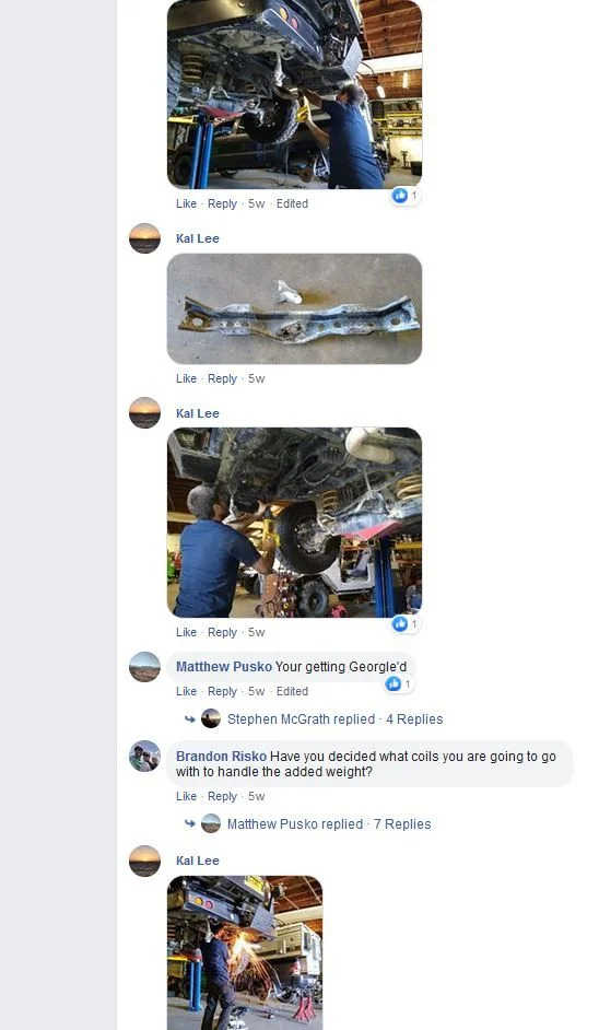

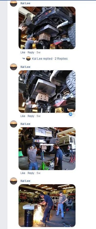

LRA Aux Fuel Tank is currently being developed!!! I brought my 2015 GX460 to Georg and Ward at Cruiser Brother and Valley Hybrids in August. Long Range Automotive owner Arnie flew in all the way from Australia, measured, configured, and mock-fitted the LRA Aux Fuel Tank under my GX. The complete tow hitch assembly had been removed as I have the rear Dobinsons bumper. The spare tire assembly was also removed. Georg, Ward, and the crew at Cruiser Brother are amazing folks and the place is a Land Cruisers haven and heaven! The 460 mocked aux tank is currently back in Australia for additional engineering for the prototype model. I surmise that once the prototype is test fitted in my GX 460, the production version model will roll out shortly.
Copy and paste the link (cannot link FB directly here) for pics and tutorials.
...https://www.facebook.com/permalink.php?story_fbid=854935588236280&id=100011595395456
