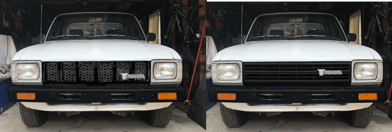

After some photoshop waffling I decided to swap out my tired, OEM grill (right, albeit with all the blemishes edited out) with the 4WD grill. I am just hoping it's a direct swap. Will allow me to undo some superglue McGyvering my grandfather did to the clips that broke over the years, assuming the part I bought comes with the clips... haha.

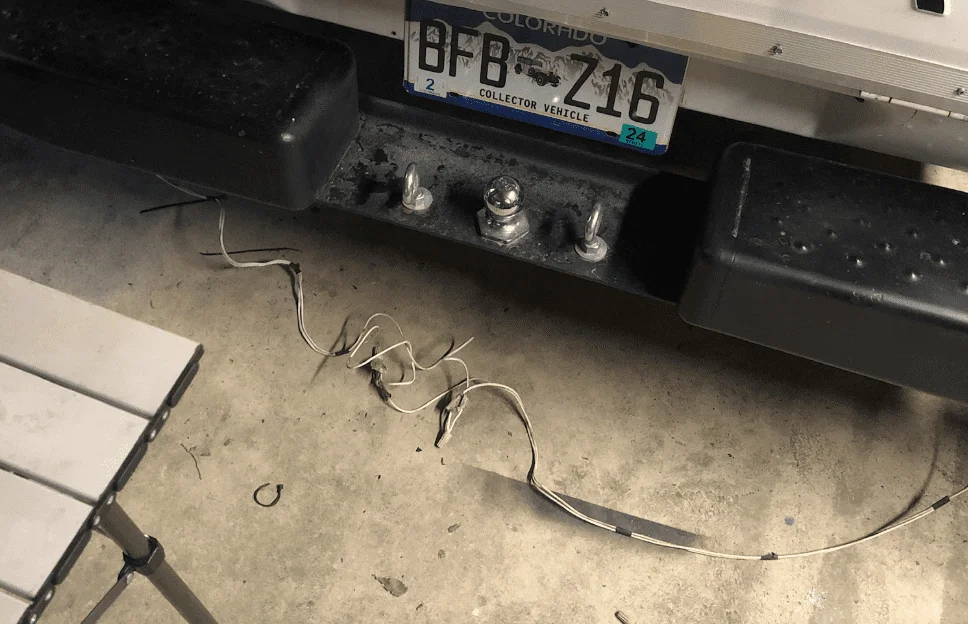

Also trying to remove the rear bumper, since I won't be towing anything with this ever... the wiring my grandfather did was a bit excessive, but guess it had to be that way for whatever trailer he used to tow his little boat up to Tahoe and back.
The 19's bolting it to the frame are STUCK, so I bought some penetrating fluid, breaker bar, and a new socket set to replace my hodgepodge of crap tools I have laying around, as well as a nice torque wrench since I'll probably want that when installing the headers and other hardware to spec.
