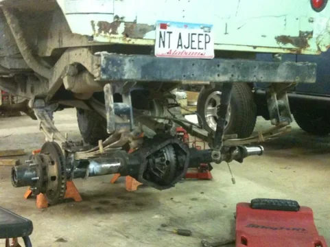

14 bolt time. Shortened for 2 short sides. Dual wheel hubs turned down w 6 lug hubs. Ruff stuff caliper brackets w Chevy disks.
I also have a Toyota 14 bolt pinion flange on the way from Jess @ High Angle Driveline. Should be ready for the OTMT in a few weeks.

First time I've logged on in months and this caught my eye as it was a 5 year old thread and then noticed that I'd posted on it - too funny. Anyways - still happy with the 14 bolt conversion - pros far outweigh the cons (and the extra weight).
Are you going to run a pinion guard? I have the High Angle adapter but the pinion guard from Dan didn't clear and I never got around to making anything to fit - just ran it. Suggest keeping an eye on the driveshaft bolts in the flange - I always check them and sure enough have had a few sets get tweaked...
I had reached the limits of the Toyota Full Float and didn't want a c-clip axle. I had a 14 bolt from a parts truck so it was inevitable that it would end up in the 40. I also was able to get the turned down hubs and brakes used for a great price.
No plans for a pinion guard but I will keep an eye on it.
Besides I need the Toy FF for the FJ45LV.

If your using the round pinion flanges then i doubt you really need one of them the pinion guard, i think their main purpose is to protect u- bolt style yokes from flopping around on the rocks and breaking the ears off.
If you have seen my "sliders" you can probably figure out what I think of protection. Axles are for dragging over rocks. And w Toyota ujpints it isn't an issue.

Haha! 14's don't drag over the rocks, you keep slamming them into the rocks until they break their way through :hillbilly:
