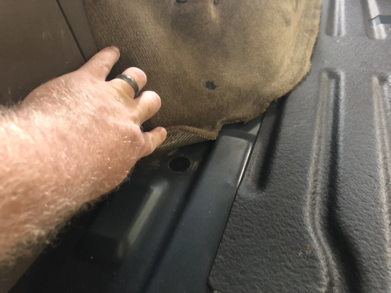

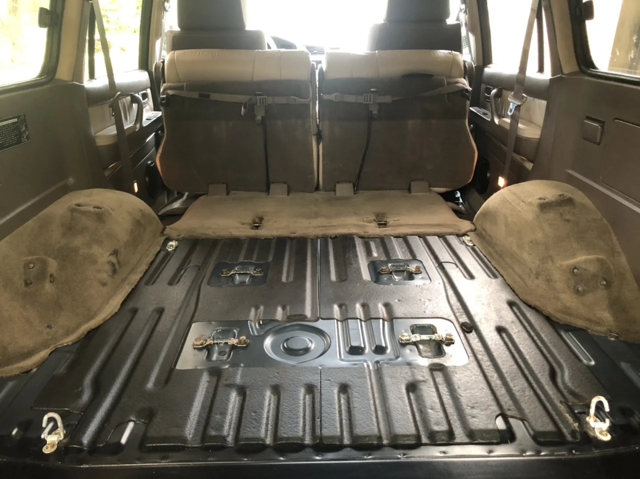

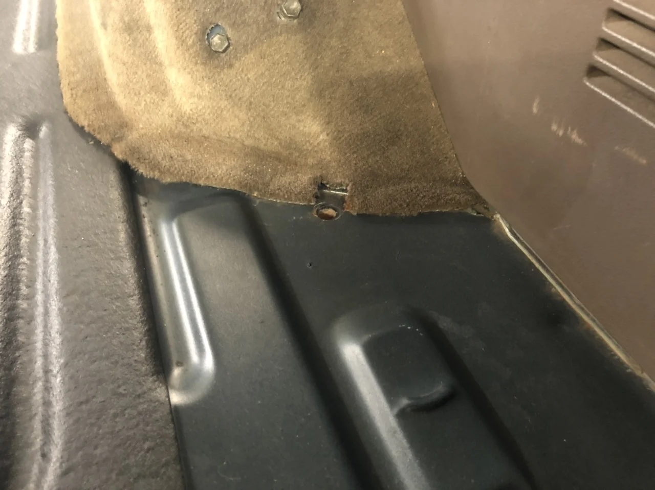

Are these the holes that ain’t? I decided to go into deep clean prior to installing, but haven’t had a chance to open up the box for my drawers yet.
Mine is a 97 if that makes any difference.

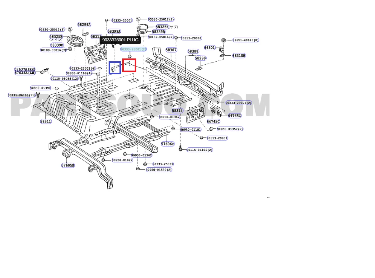

I don't think so... On mine (HDJ) the holes with the plugs are closer to the tailgate and not that wide.
So what I've pictured is what I've put in blue, but we need what is in red?

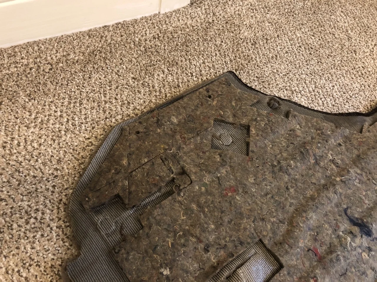

What’s funny is looking at the underside of my carpet. You can clearly see the carpet has provisions for all three holes on each side
Red is correct.
Some engineer must have saved Mr. T millions of dollars by removing that hole and plug, but left the carpet unchanged.
And that’s what’s odd. I would think it would cost them money to retool instead of keeping it the same across the board. I wonder if Araco did some of the 80s and not the North America ones? I dunno...
Good news is I can use my carpet as a template!

I’m guessing our solution is a thru hole with flat washer on either side with a nylon nut + Loctite with silicone for water intrusion. I crawled under mine and it doesn’t look like anything is in the way and should be relatively easy to get a tool on it.
Mine was just a hole similar (but maybe not as big of a diameter) to what you had in your pictures, but it was filled with a rubber plug. I can try and get a pic later.
I just used a bolt and some washers. The hole on the bracket is kinda small, but I was able to force a M8 size bolt through. I forgot to loctite the nuts....
Guys, talking to BC4x4 they agree the easiest and simplest solution is a hole drilled with a large flat washer & lock washer with a nyloc nut below, on a bead of silicone. (almost) every other 80 in the world else has this hole, now you can too! :)
It will make it a two person installation (one cranking the nut from below and one holding the bolt above. You could do a nutsert if you have the tool handy. but not required. Using a nutsert you would need to have sealant on the thread of course unless you use a closed end nutsert.
We will update the installation instructions and product description to note this possibility. Right now it is still a bit of a mystery as to which exact models have the holes deleted. You can help by sending me your full model number and yes/no on "the hole-that-aint" situations. Yes, you want the one circled in red.
On the bright side your deep cleaning game is strong. Very strong. Were those holes open / no grommet installed? Do me a favor and let me know your full model number please.
Gotta have a good base to get things going!
Mine is a 1997 Collector’s Edition. The driver side had a plastic adhesive - Almost like a circular band-aid (you can see it in the earlier picture I posted). Passenger side was open, but to be fair, my third row is already stashed away in storage and was removed when I bought the truck. Can’t be certain what was in place originally as hands have been in there. That said, the “band-aid” is present in other holes in this area as well.

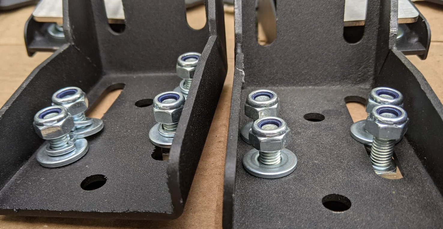

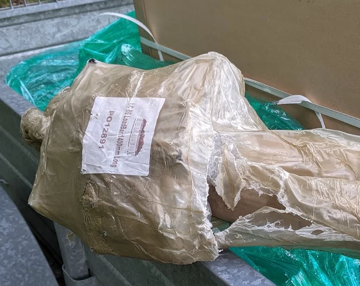

I just picked up the last items that I had ordered from Theo from Rugged Bound from the local LTL terminal. Penthouse XL RTT, 3 x Load Bars, Drawer Kit, 270 Awning, and Tailgate door.
I opened the last of my boxes and the load bars packing had a tear, and some of the nuts and bolts were loose. Amazingly, I think I am just one washer short. :p I call that a win.
Although, the locking washers have me a bit confused. See second picture. Only one mount out of the six has them. They all have locking nuts, making locking washers not necessary. Or, should they be used and I need to pick up more?
One of the load bar mounts has a cracked plastic liner (3rd pic), but I don't think impacts function.
The drawer system looks really nice. I have an extra bolt and washer...it just dropped out of its packing. Not the same size washer as one missing with the load bars. I don't know where it goes. Just extra as of now.
There is a divider for each drawer and a tip up work surface, but missing are the 2 drop-in boxes.
All told, just one broken plastic bit, one missing washer, and a tear on the 270 awning cover. Not too bad since these items came from South Africa.
