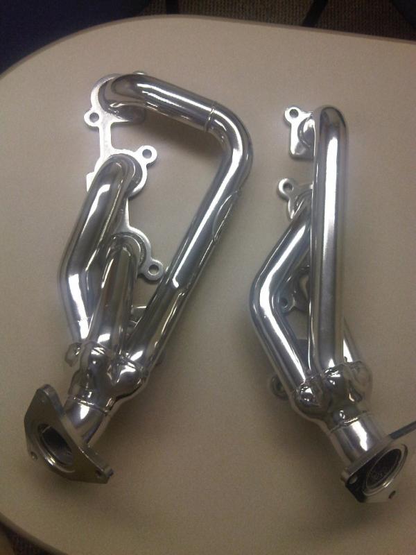

let's see some more pics of this header work of art...! Sure is shiny...

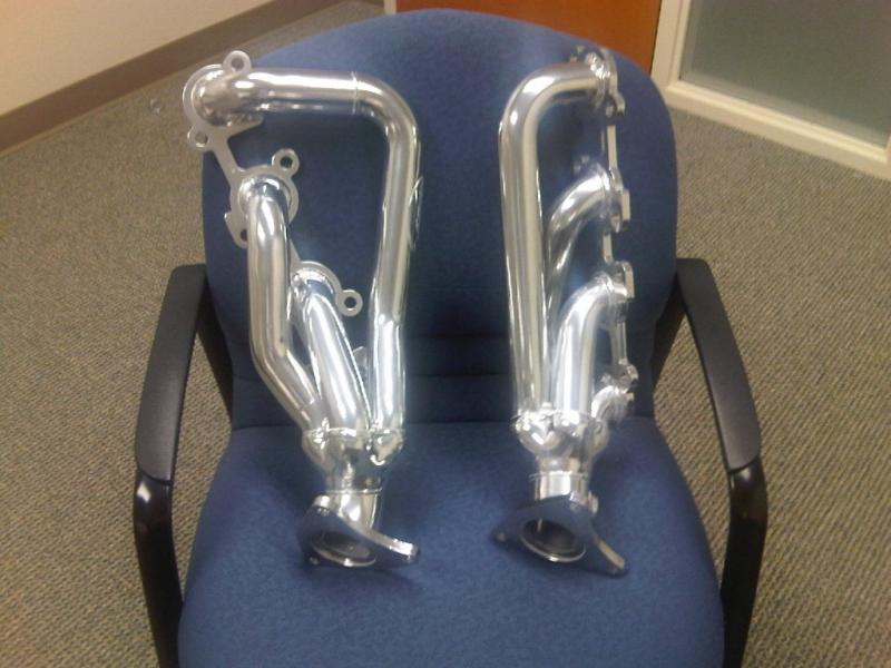

More pictures

beautiful
now to see how well they fit... :)

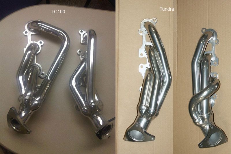

And here is a comparison of the LC100 DT headers vs the Tundra DT 4.7 headers.
Just a quick note on the design... Jamie in R & D at Doug Thorley built these headers and the production jigs. He tried to make the headers look nice and tight like the Tundra headers but could not for the life of him make it work on the drivers side working around the steering shaft (it is tight in there). That is the reason for the difference between both sides in case anyone is wondering. There is no change in performance just the looks. When I asked Jamie if it was a tough install he said no big deal, and that other designs have been worse.
