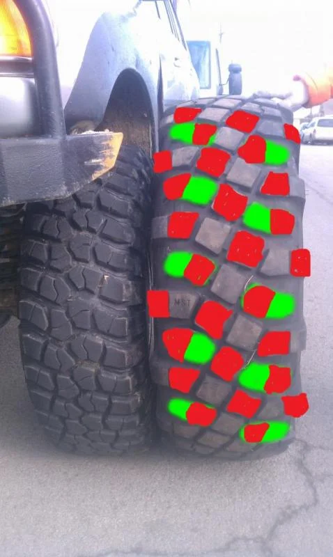

I have quite a few buddys that run the xml's and I would advise against grooving that way. IIRC they liked them best when they cut out every other lug and alternated per rows ie 1, 3, 5, 7 and then 2, 4, and 6 on the next row continued all the way around. This pattern cleans out with little wheel spin and still allows you to drive on hardpack or the street without beating the snot out of you. HTH
Do you have any pictures of it? I'm trying to visualize what you are saying and I think I'm confused... lol
After I posted this am I went and looked through my photos and couldn't find any. Imagine this on your photochopped pic every 1st, 3rd, 5th and 7th lug cut out of the tread rows still in the pic and the ones that you photochopped out get every 2nd, 4th and 6th tread block cut out going across the tire left to right.
Gotcha, I think I'm following you now. So something like this with the blocks in green being removed.
I was also thinking about something like this so none of the big side lugs get removed.
Still just trying to figure out what would work best.
Gotcha! I see what you are talking about now. I was counting the split treads as one and it was throwing me off. For the remaining big square blocks in the middle, do you think it would help to groove them a little? Maybe like how those KM2's are beside the tire above?
