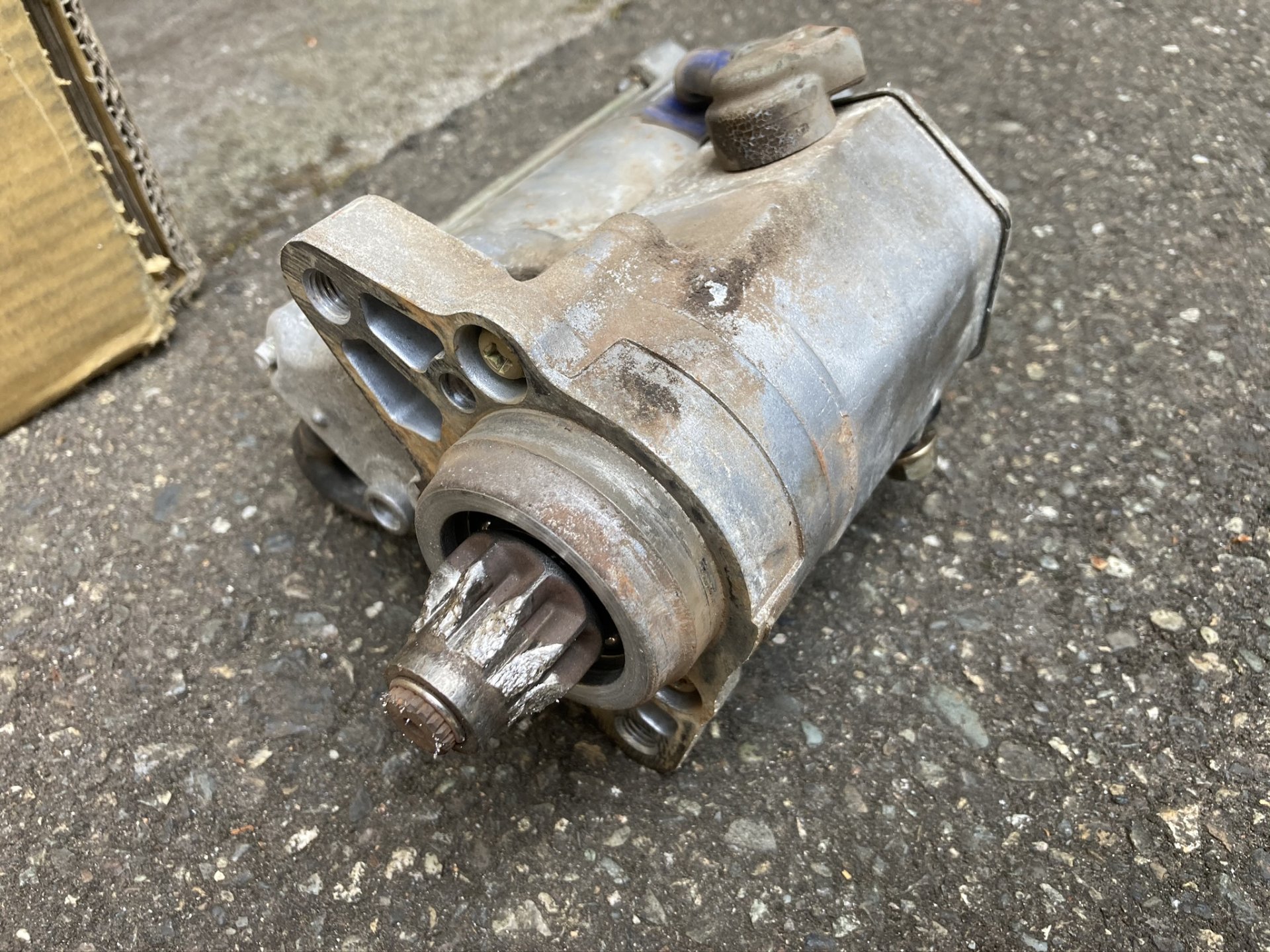

This issue developed on my son's vehicle. We had the heads off recently and decided to remove the starter motor for a look at the drive pinion and ring gear. To my amazement, the motor was seized in the block and would not budge no matter how much spray/time/ tapping/cussing I gave it in the hope of seeing some movement/separation, but it didn't happen. Well, I did eventually but the motor was beginning to break, leaving the rear part of the pinion bearing housing still seized in the block. I then used a 4mm drill to remove about a quarter on the aluminium housing from 3 to 6 o'clock portion of what was in there and it finally loosened enuff to get it all out. That was a first for me - and I've removed a few starter motors over the last 53 years. The new starter went in with a smear of grease on it.
I should've taken a few pix but i was too frustrated to think of it at the time.

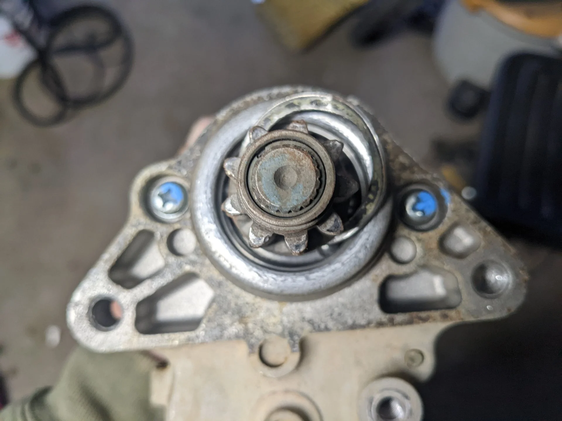

Mine made a nasty noise after startup for years. Finally the starter just wouldn't turn anymore.
The gear on mine was good, the bearing went out. Not sure where the rest of the balls went.
