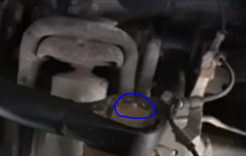

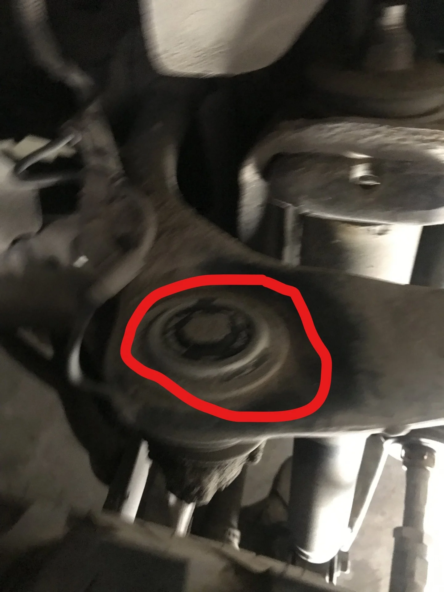

Hi - today I watched a youtube video - showing how/where to grease the UCA ball joints - went to my vehicle but no zirc fitting - has anyone got some context? - what to do? Fit zirc fitting? - photos below - red is my UCA (flat nut) - blue is the youtube vid where u can see the zirc fitting - thx in advance
The zerks don't come on the OEM parts that I'm aware of. A lot of the aftermarket ones have them, and some people drill and tap them out to install a grease zerk as well.
Perhaps someone else can chime in on whether or not some of the later year 100 series had zerks or not.
You would need to replace your UCA to the one like in the video if you want to grease UCA ball joint.
Technically, you can remove the wire and slide the boot down, pump or pack grease in, then slide boot back up and replace wire. I replaced the wire with a zip tie just for this reason.
That's probably the best way with OEM ball joints
thx everybody - am a bit wiser now
