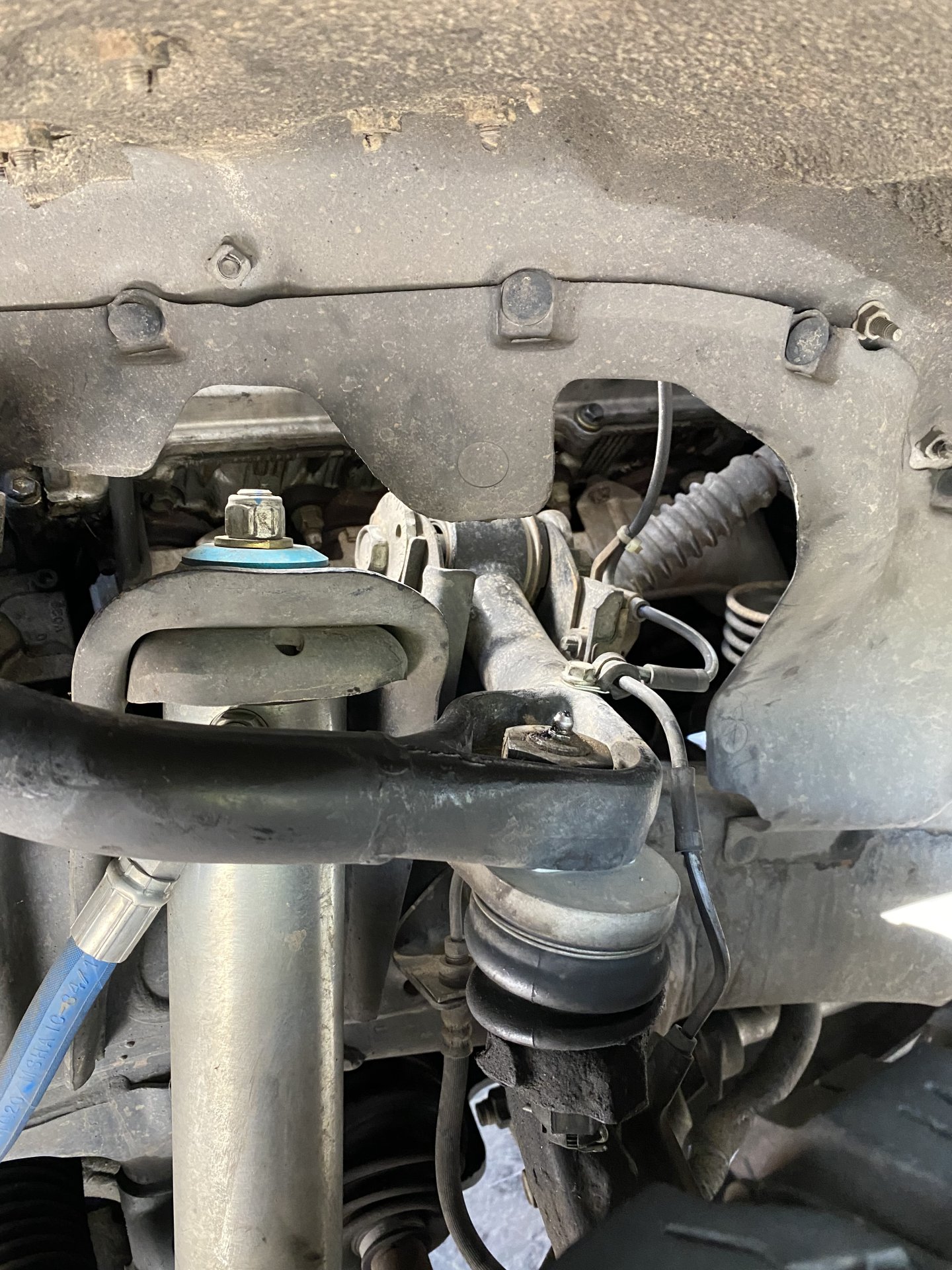

New 100 owner here, are the upper ball joints greasable? I see what looks like a grease nipple. And if so, what grease should I be using? I’ve got some grease for my driveshaft, will the same kind work? I’ve got SPC upper control arms.
Yes, you have SPC ball joints so they can be greased. OEM ball joints are non-greaseable. You will want a NLGI #2 w/3-5% moly grease; about 5-10 pumps will be good
