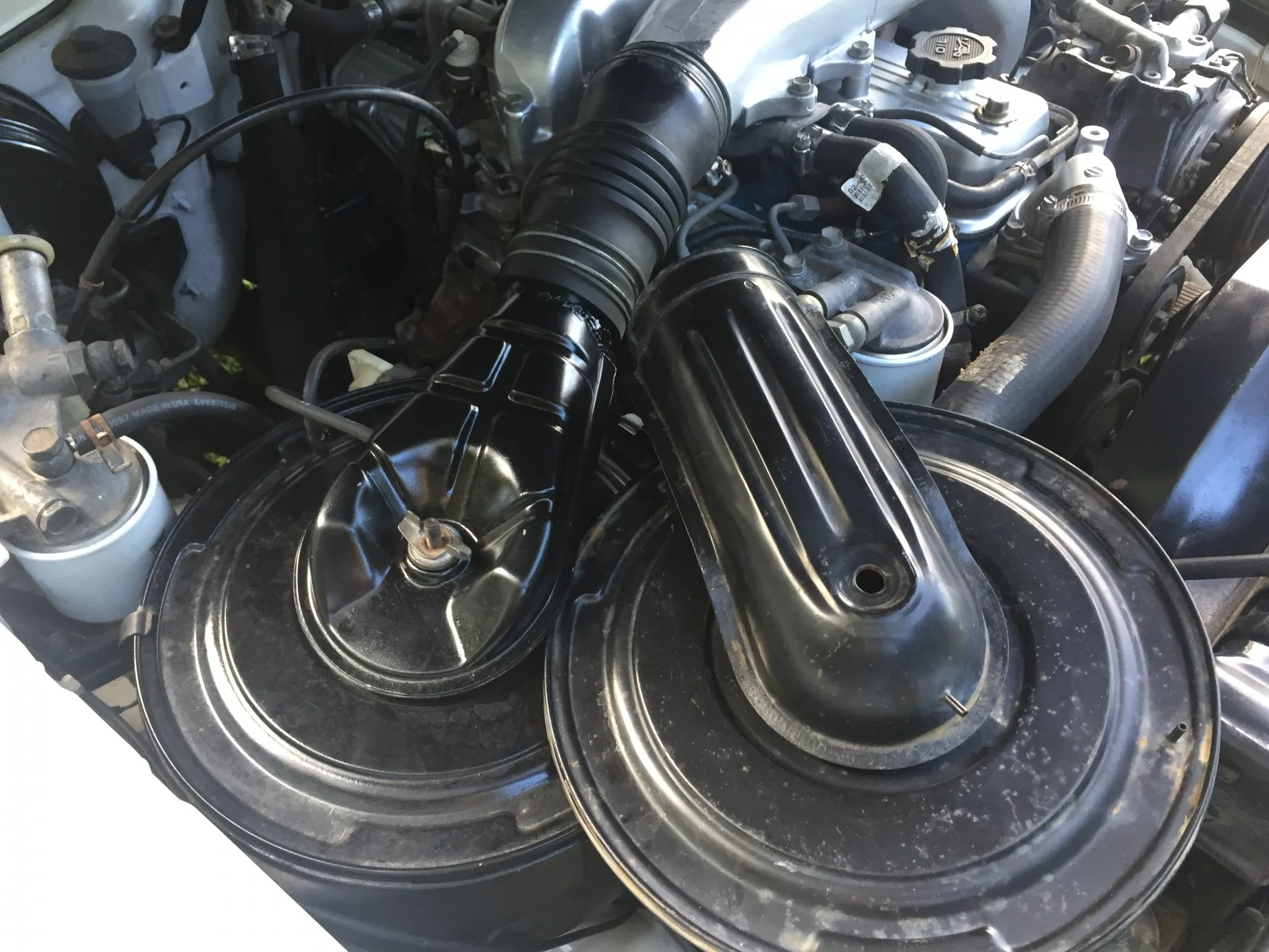

Seeking the airbox lid on the right side, I think it’s a 1FZ lid, with the larger opening to put on my diesel. Just trying to open the intake tract. I’m in grass valley ca, but travel up to Reno, down to sac, and down to the Bay Area all the time and can pick up anywhere along the way. Happy to pay for shipping too, looking for one in good shape thanks y’all
You need a 95-97 lid. They are very popular as people use them for LS swaps in 62s and 80s. If you can weld, buy a mandrel elbow on ebay and cut the old one out and weld the new one in. You can even go bigger if you want to. I did this once for a LS swap. I went 4".

I’m going 3” snorkel, so I may want the input side to stay the same, but exiting the airbox I would like it bigger than the stock 1hdt, I think it’s like 3”, and the 1fz is 3.75. I think I can just do 2 90degree silicone elbows with a connector pipe down to 3” I think at the turbo inlet, I’ll just have to move it around and adjust accordingly

Found one off a LX450 from 95
