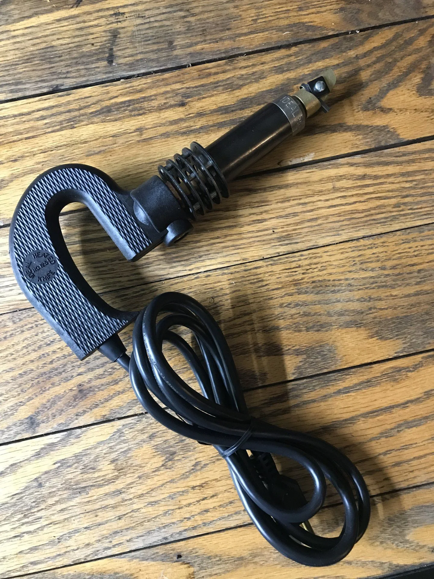

Got a new tool (Tire groover)

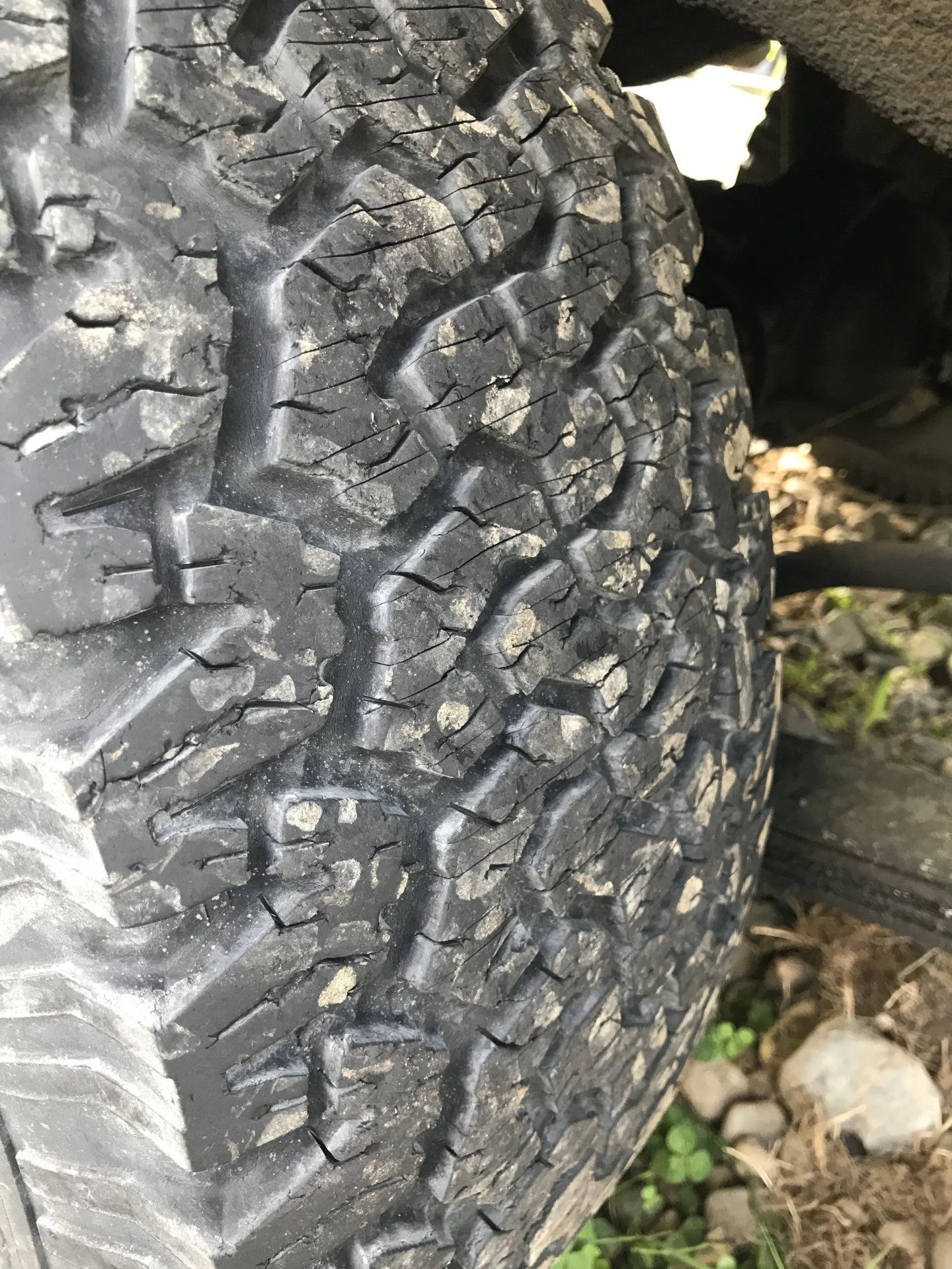

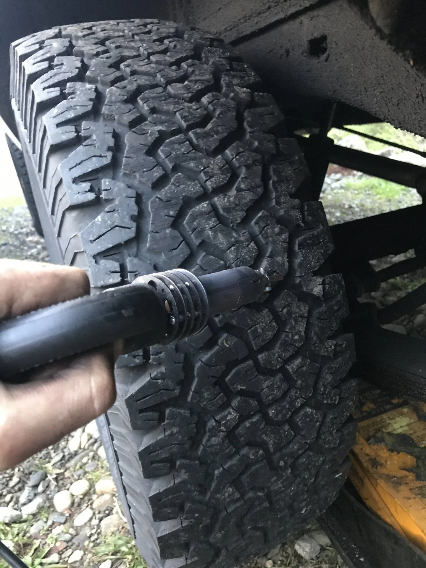

I have some older BFG tires to experiment on. I’m going on a interior ice fishing trip so I should see some icy driving on the mountain passes and snowy mountain lakes. Going to try siping them first.
I have some older BFG tires to experiment on. I’m going on a interior ice fishing trip so I should see some icy driving on the mountain passes and snowy to the mountain lakes. Going to try sipping them first.

Third inline over here. What was the price tag?

Cool tool! Let us know how the trip went.

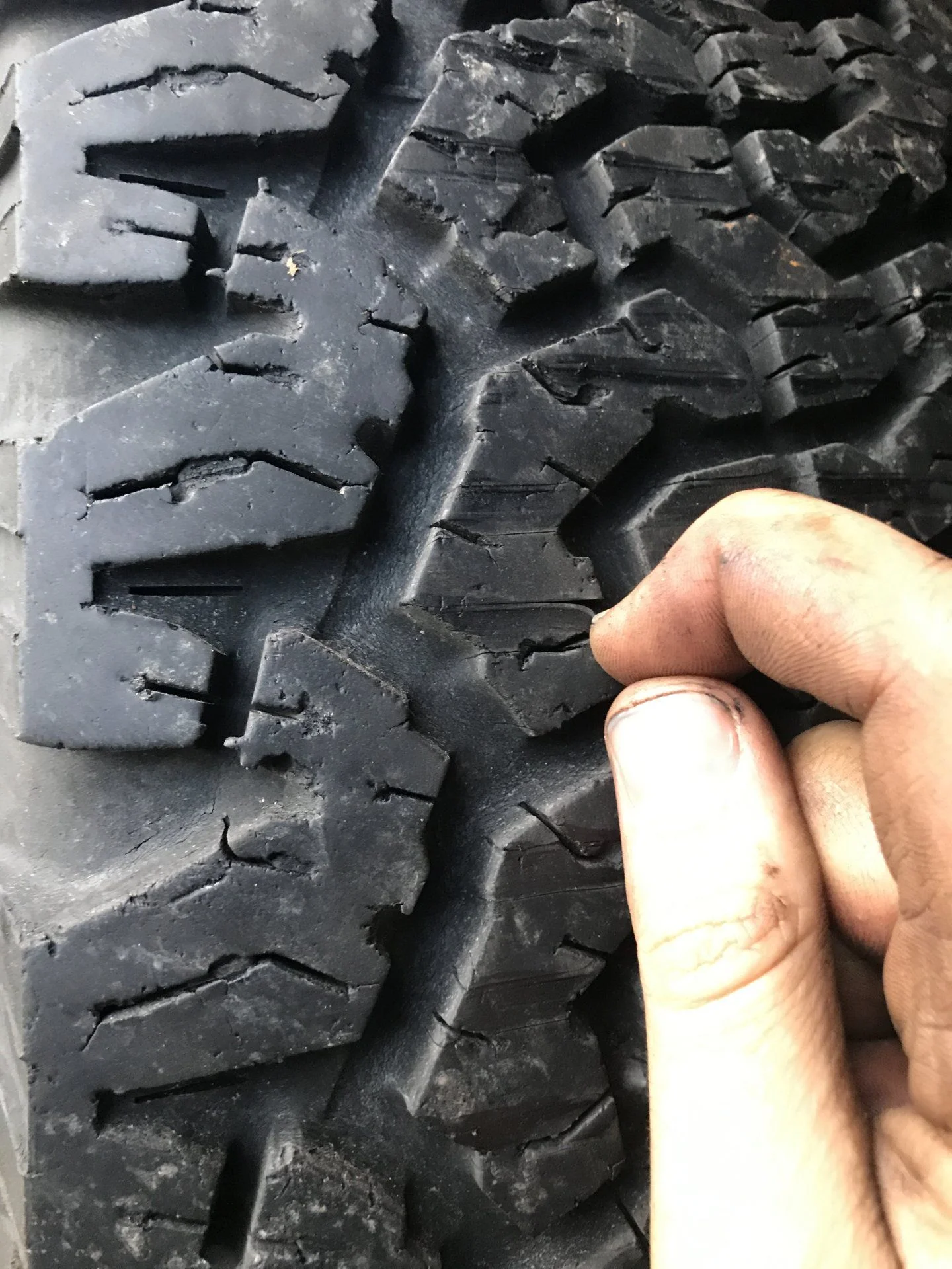

Siped the inside treds I left the outside treds alone to hopefully prevent chunking. It works great but you do have to let the tool warm up every three cuts or so if not and you keep forcing it it just wrecks cutting blades.

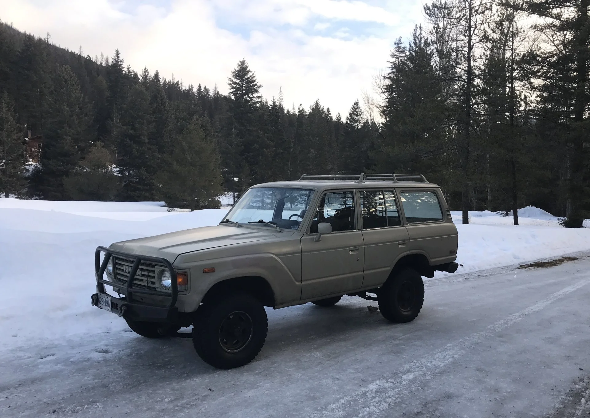

I siped my 38.5x14.5 TSL/SX’s back long ago. On my 351W FJ40..
Drove to Calgary three times in winter, they were amazing! List of best mods
for sure.
Except - my Toyo MT’s are siped and the Dempster and up to Tuktoyaktuk chewed
them up! After several thousand kilometres of hard blasted highway rock they chunked
really bad! Surprised me very much. I don’t have a pic with me, I’ll post it when I get
home.
Siping really comes in to play when tires wear below 50% or so. My old BFG Mud Terrians were like hockey pucks on ice once they wore down. I siped the inners and they felt almost new again.

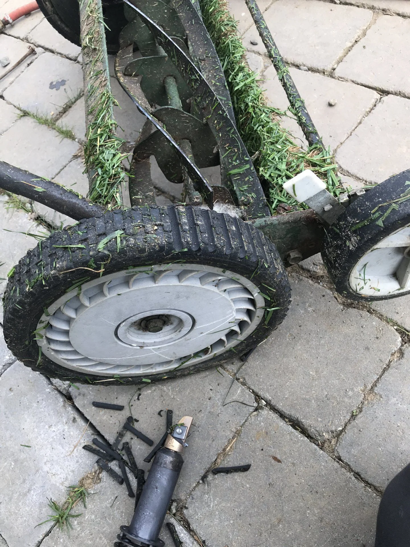

Tuning up the slicks on my city boy tractor. These wheels should have come spiked they drive the reel and slip on the wet grass sometimes.

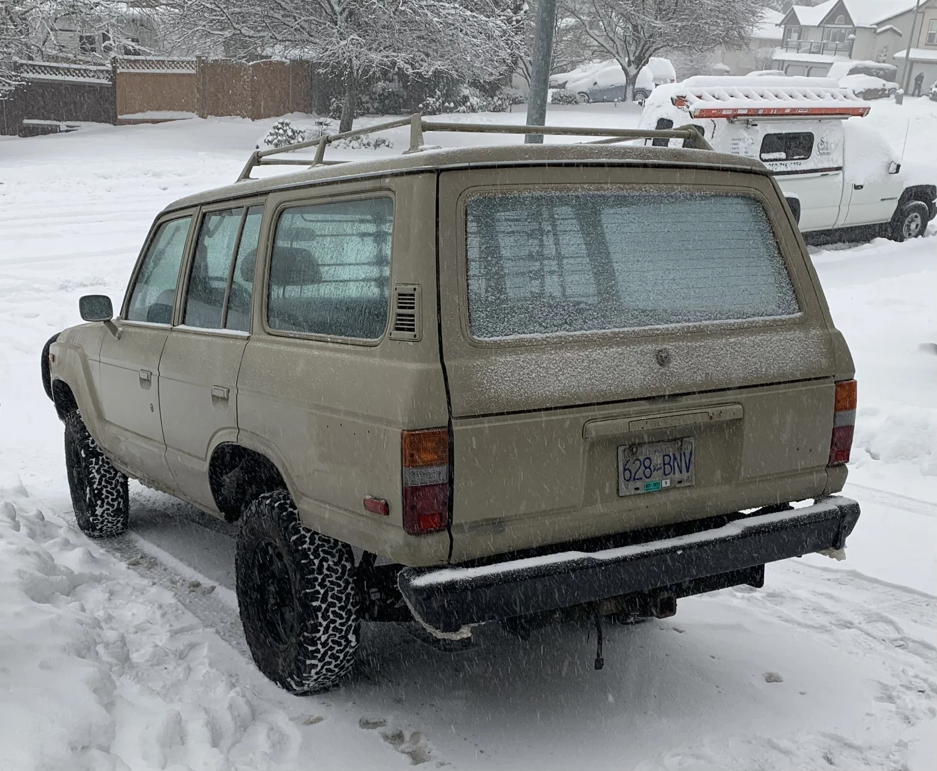

Got new tires and cut them up immediately. Good thing I did as I drove drove Duncan to Nanaimo in the snowy glazed slush and back, passing pickup’s and SUV’s in the median and ditches.
Some people believe knobby big lugged tires are what you need in the ice and snow. i disagree and believe you need as manny small sharp cutting edges as you can get, sort of just like a proper snow tire hah. Don’t matter if you have if you have fully locked 6wheel drive you still can’t stop a slide if your tires fat lugs are all plugged up with snow.
Some people believe knobby big lugged tires are what you need in the ice and snow. i disagree and believe you need as manny small sharp cutting edges as you can get, sort of just like a proper snow tire hah. Don’t matter if you have if you have fully locked 6wheel drive you still can’t stop a slide if your tires fat lugs are all plugged up snow.

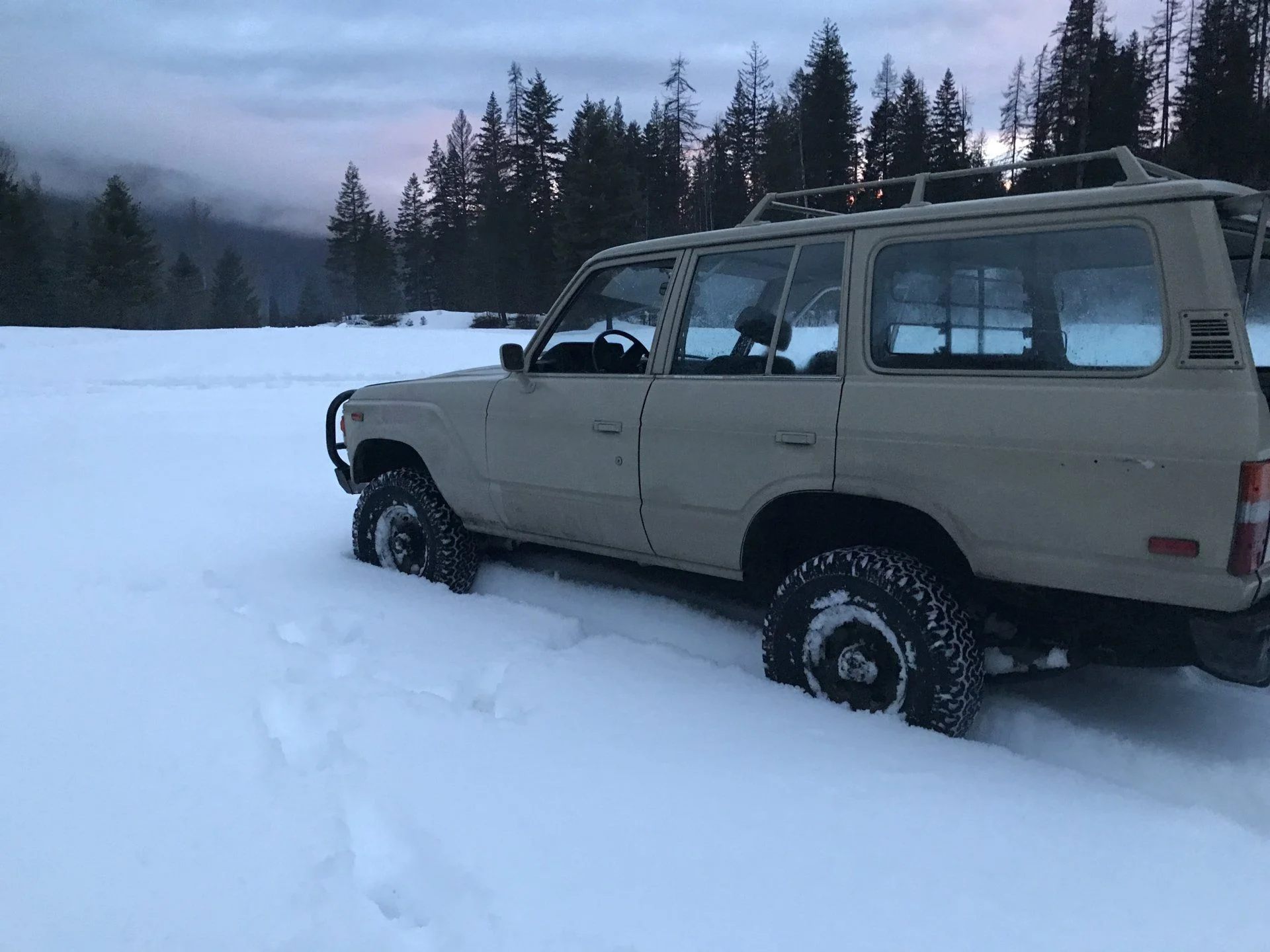

I've found to my supprise when trying to get through very deep snow off road, mud tires can actually be really good. I never expected it, but my large mud tires are better than skinny tall duratracs with v-bar chains off road...

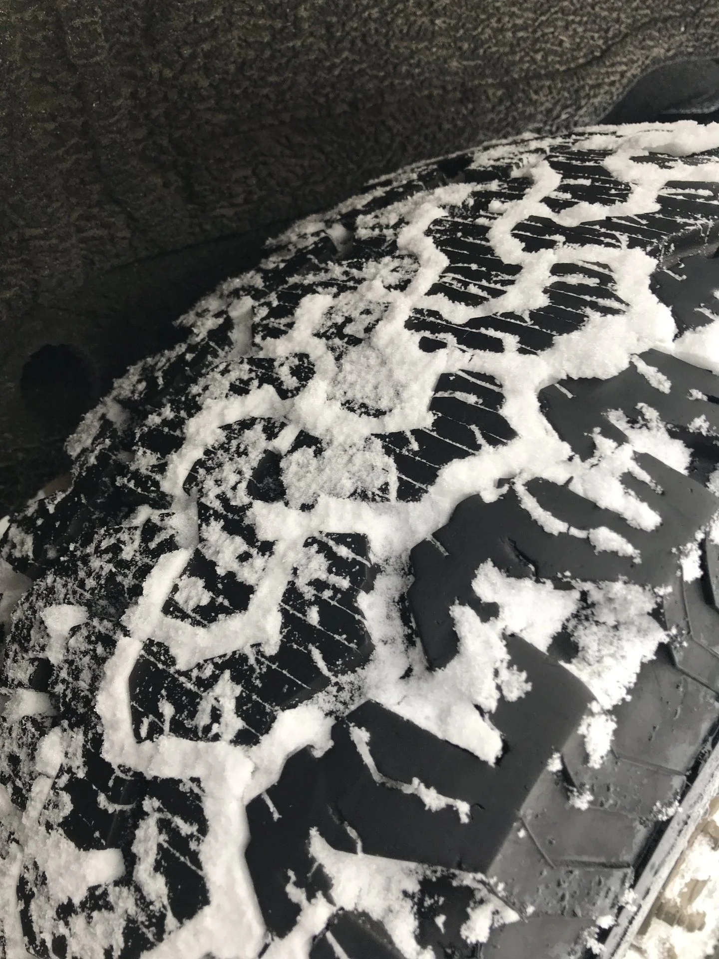

Siping doesn’t help get you much further, it helps you stop those uncontrolled slides.
When you slide your tread fills with snow becoming flat like slicks. siping allowes little gaps to flex open that don’t fill with snow and act like little claws.
